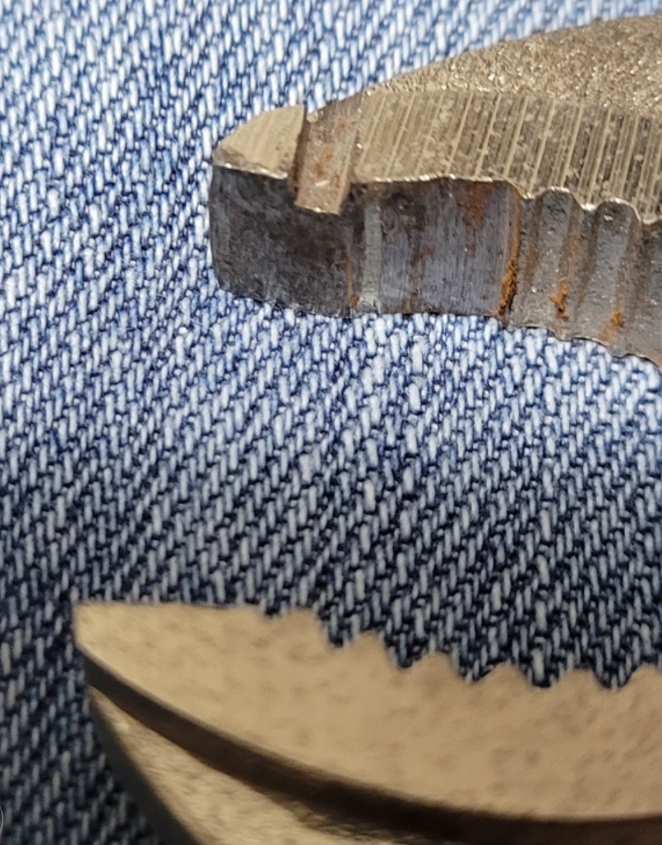

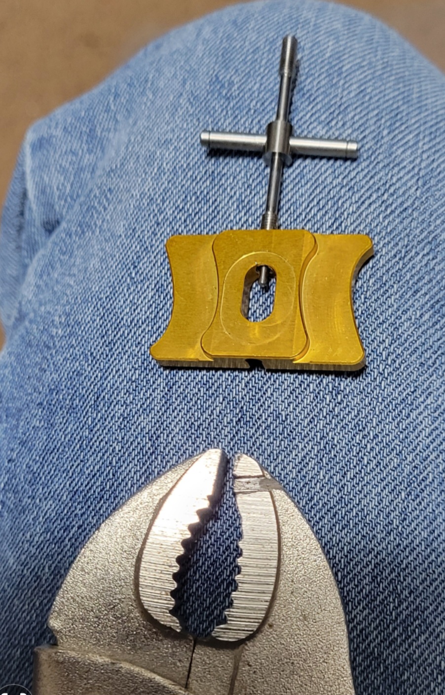

Posts: 3535
Has thanked: 268 times
Been thanked: 2094 times
Re: RC10GT - Black Pan and Plastics - #7065
I have these for fishing reels but they should work on axle and input shaft pins as well.

Juicedcoupe's idea is pretty smart too... but I can't tell if he's really zoomed in or just using the biggest channel locks he could find :shock: :lol:

juicedcoupe wrote: Thu Nov 16, 2023 4:22 pm I have these for fishing reels but they should work on axle and input shaft pins as well.
That is a great idea! I'm pretty sure I used needle nose pliers in some sideways fashion to put my pins in originally, but it put gnaw marks on the surface. I'm looking for some old pliers I can dremel immediately following this. Thanks @juicedcoupe

Dangeruss wrote: Thu Nov 16, 2023 4:37 pm Juicedcoupe's idea is pretty smart too... but I can't tell if he's really zoomed in or just using the biggest channel locks he could find :shock: :lol:
It is zoomed in so that you can see the slot and that the teeth have been removed from that area.
The Vise Grips aren't the smallest size, more of the mid-sized ones. Maybe 8" total length. I think that those are some cheap ones.
