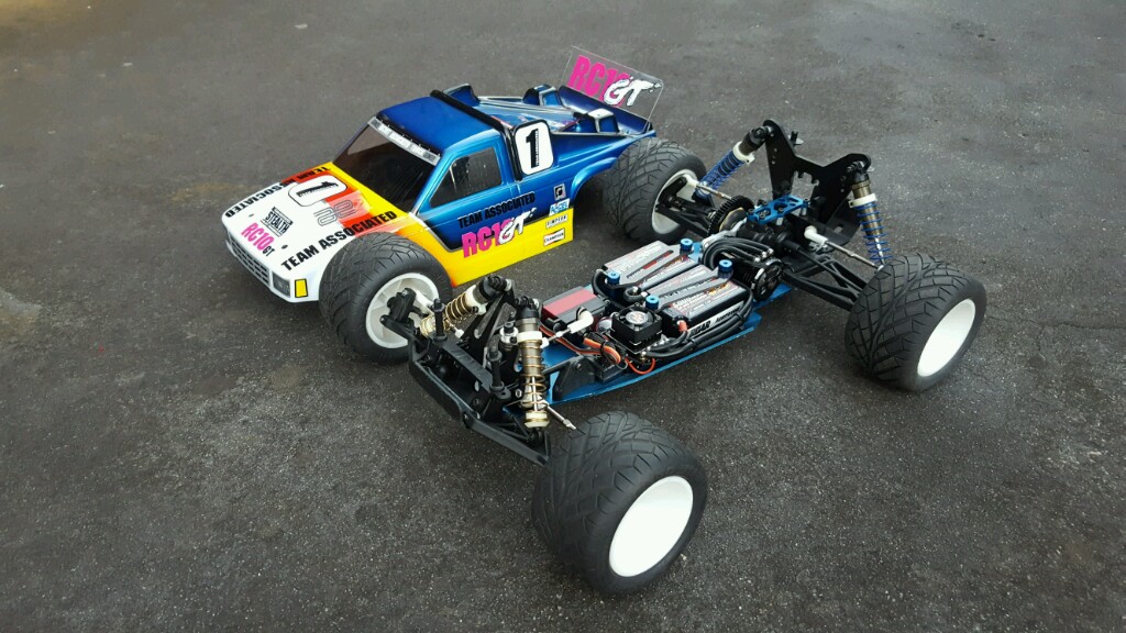

Posts: 16810
Re: RC10GT - black pan - E-conversion?
I built this one for Jconcepts.
RC10th
Posts: 4761
Has thanked: 52 times
Been thanked: 1548 times
Post by RC10th »
Black pan trucks tend to flex too much and require bracing of some sort. The truck Jason built is one of the nicest I've seen.
Lots of beautiful examples of converted GT's.....

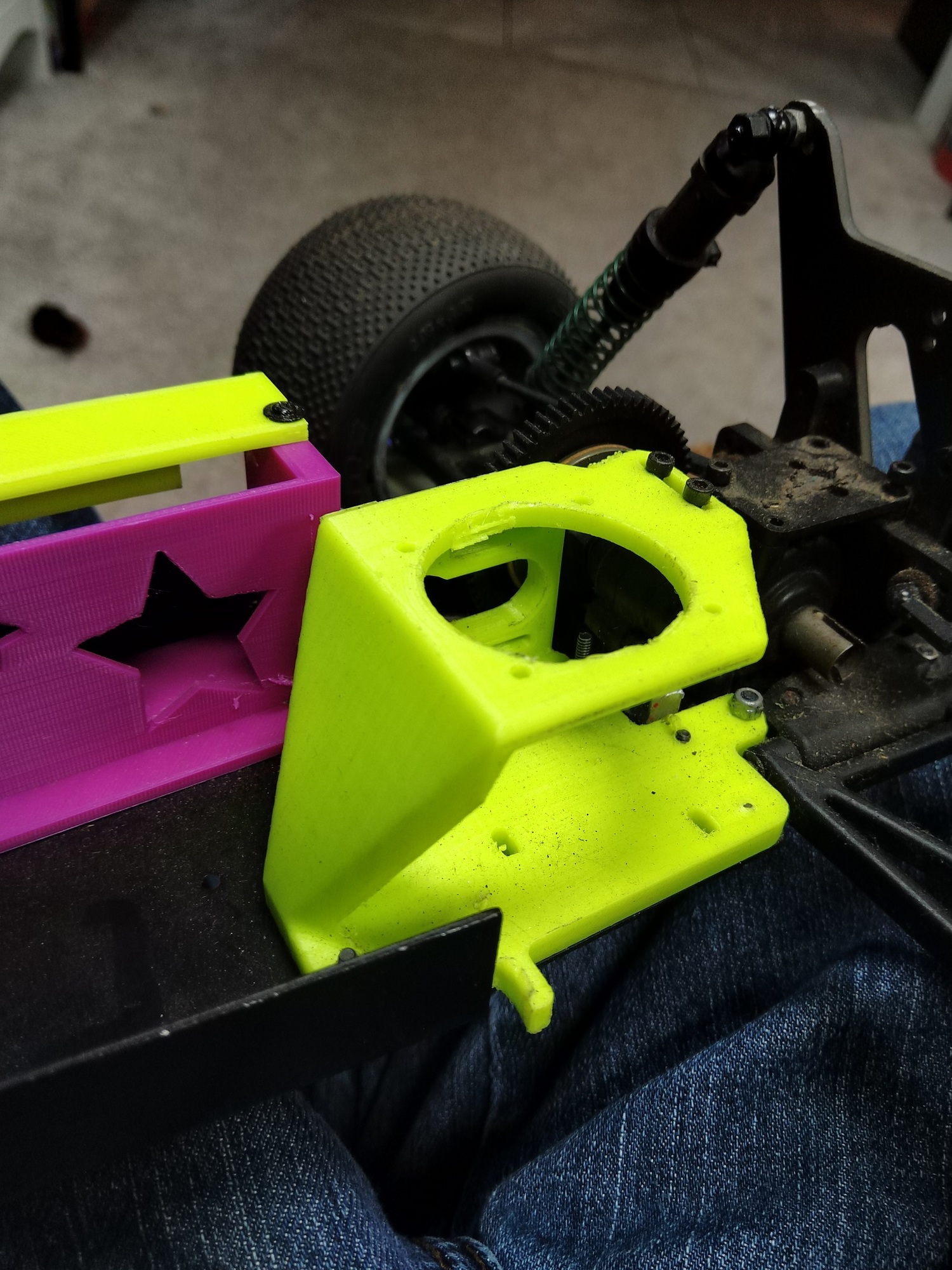

discgolfer72
Posts: 336
Joined: Sun Mar 17, 2013 5:36 pm
Location: op kansas
Has thanked: 21 times
Been thanked: 36 times
Post by discgolfer72 »
this design fixes the flex /brace problems with the black pans . but it needs to be printed in a high temp plastic and even then if your. motor gets to hot you risk warping . its up on thingiverse . would love to have one made on a cnc out of aluminum

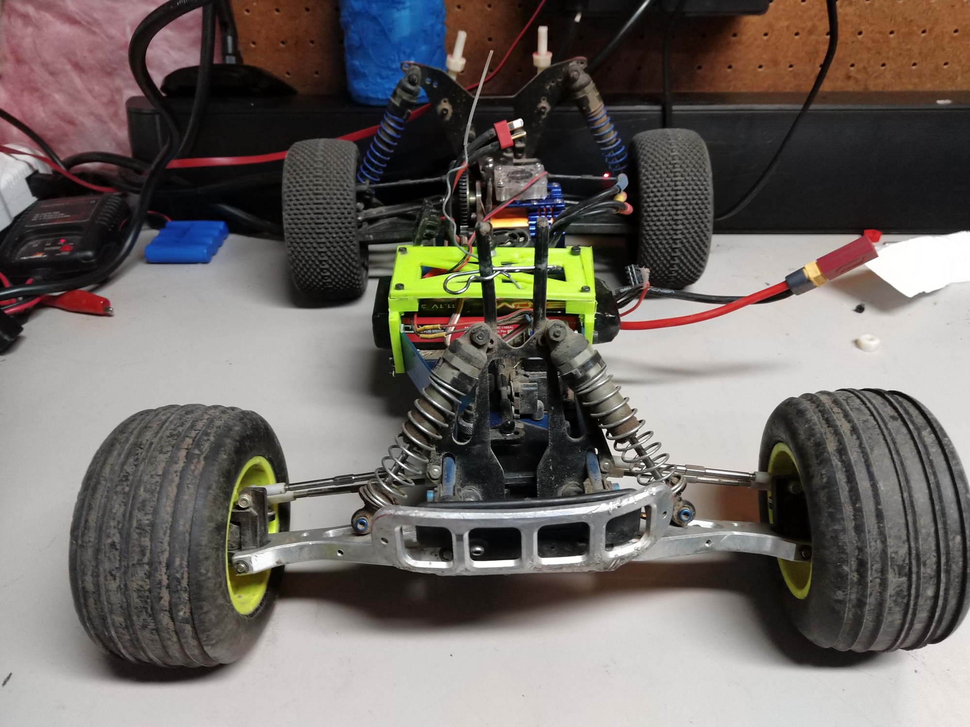

jwscab
Posts: 6580
Location: Chalfont, PA
Been thanked: 505 times
Post by jwscab »
this is my solution to e-gt and flex in the chassis. no new holes, the lower part of the waterfall picks up the motor mount holes.
