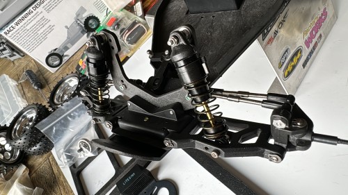

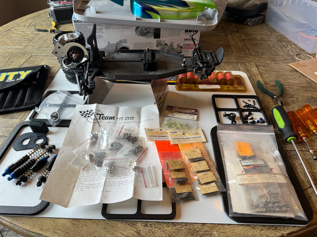

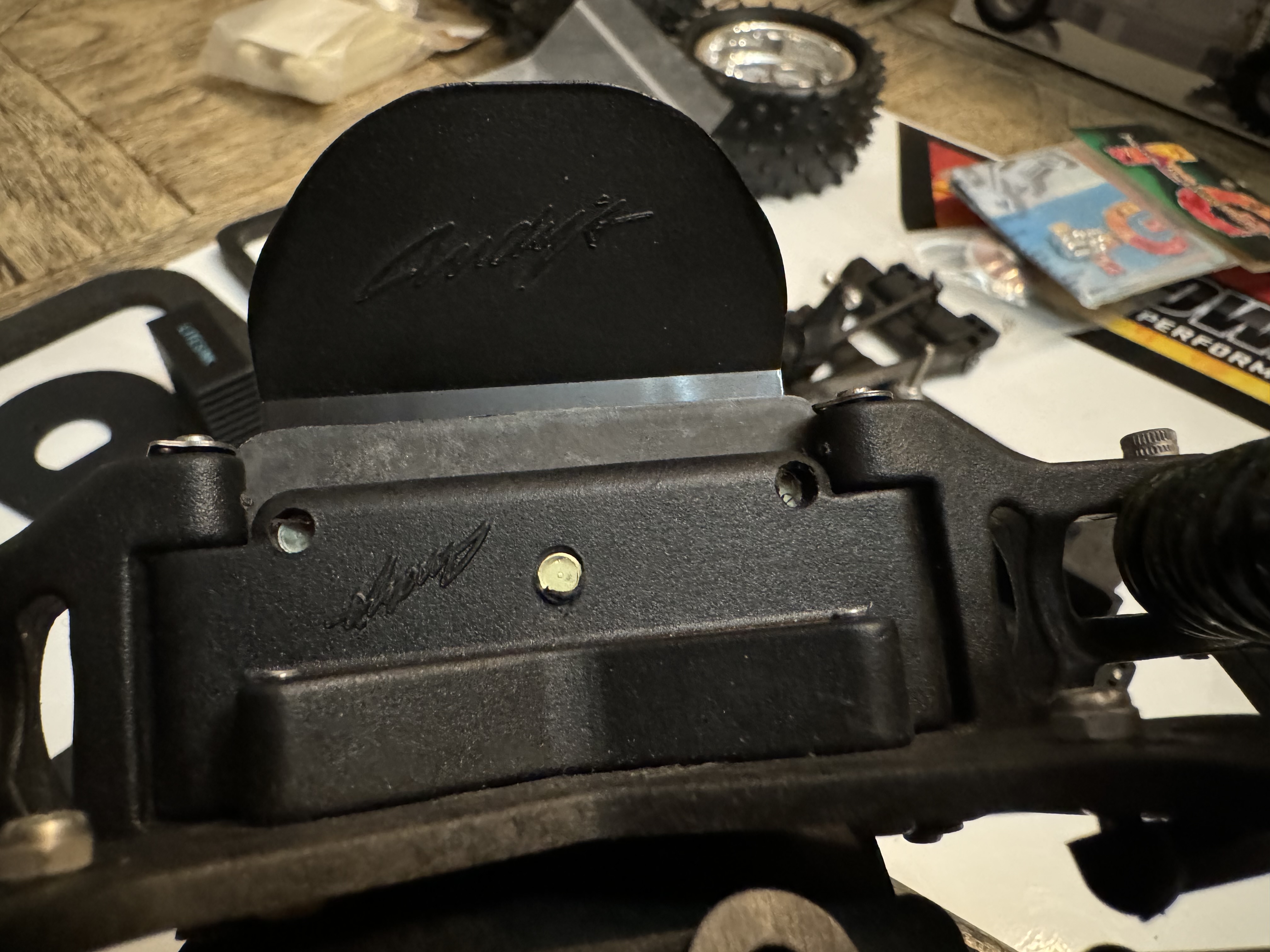

I’ve been collecting Andy’s parts for a while and have several builds near completion. This one I thought was complete until I saw last years BOTY winner and the effort that went into it. I decided I would tear this car down and give it the attention it deserves.
The new build list so far consists or
Andy’s pro molded buggy chassis kit parts acquired individually.
I decided to change it up a little and use H arms on the rear since the kit came with both H arms and Trailing arms along with the appropriate shock towers. I will be doing an Andy’s S&K Pro graphite build with the trailing arms after this one.

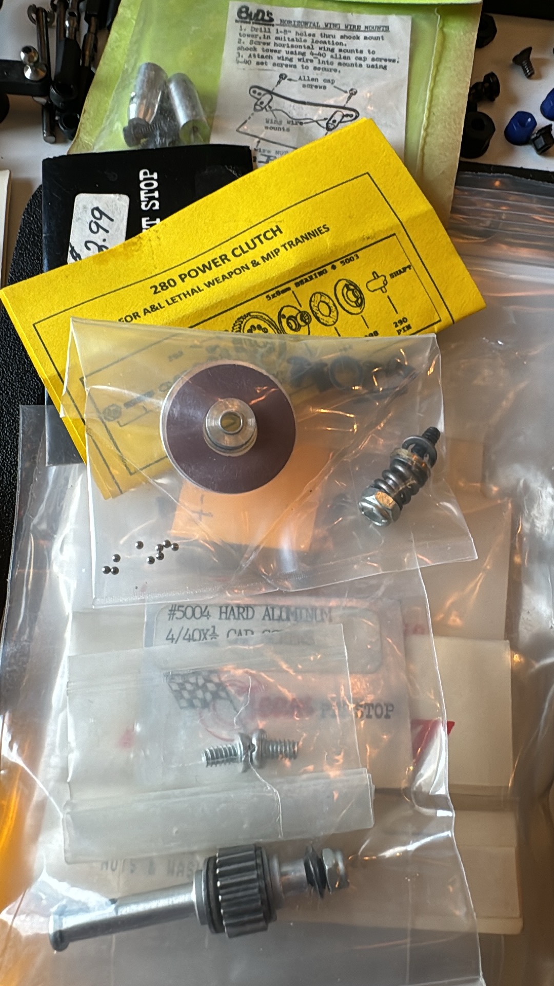

The chassis came drilled for 6 gear only so I will put an MIP SP1 transmission in it with the upgraded HD ball diff and A&L slipper assembly. I have also sourced a set of Delrin gears for the top shaft and idler. Hopefully arriving in the next week or so.

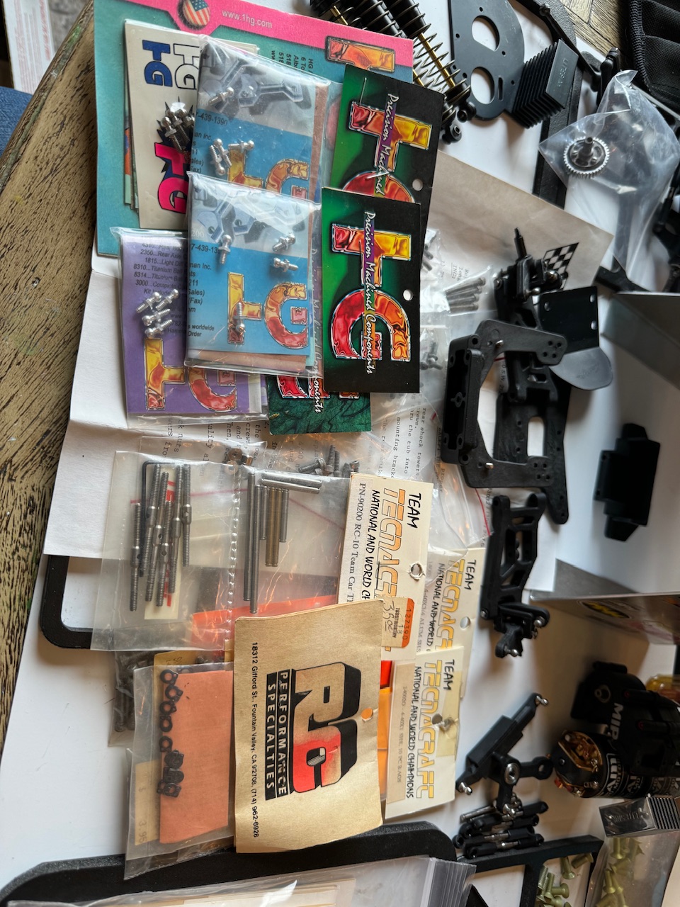

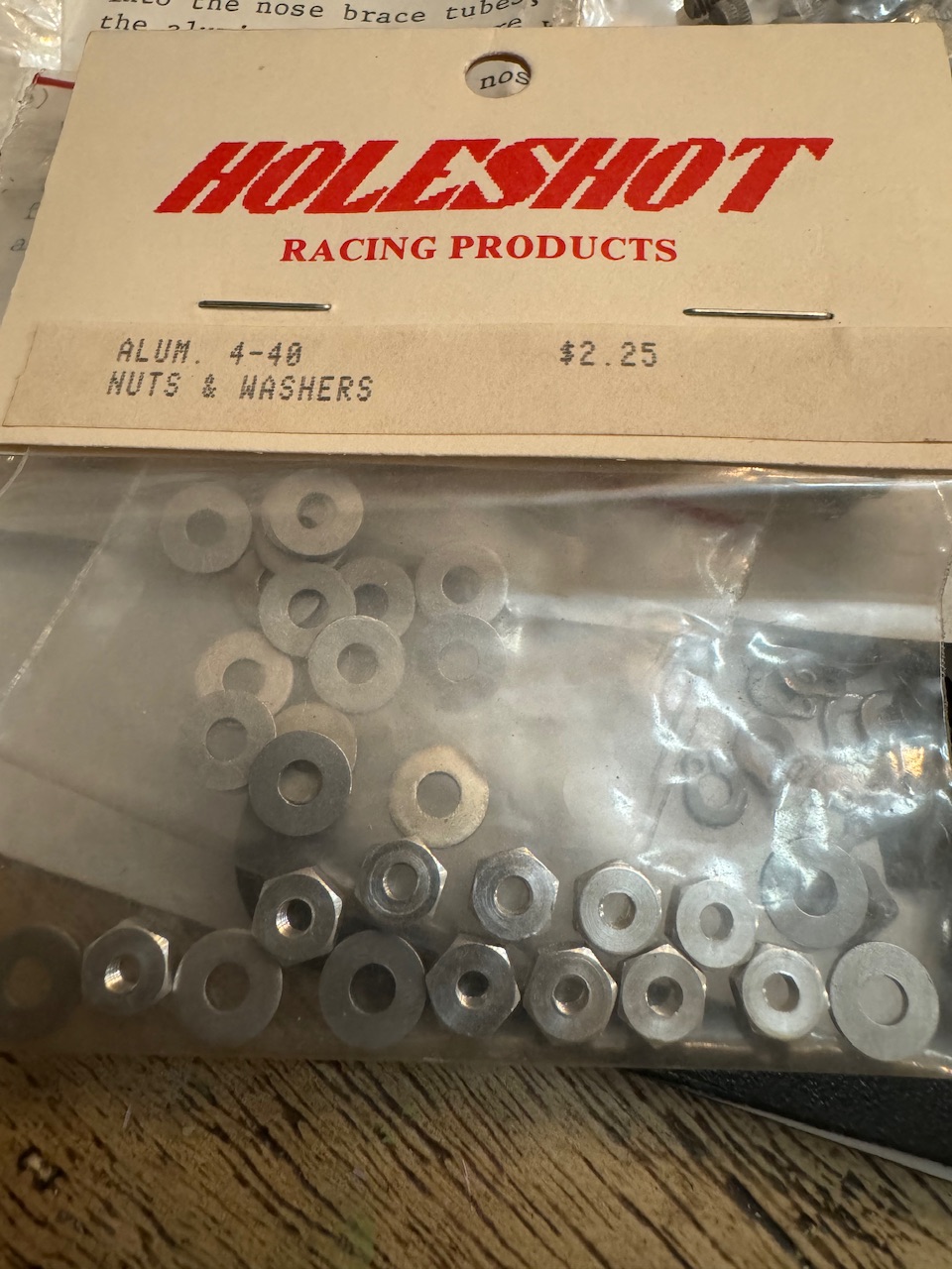

TPS lightweight screw kit plus Tecnacraft screws for the upper shock mounts. Nuts and washers through out are holeshot aluminum. Ball studs are all HG titanium. Hinge pins are Tecnacraft titanium with the exception of the rear inners which are RPM steel because of the extra width of the rear arms.
If anyone knows of or has a titanium hinge pin that will work on the wider arms I’d love to keep this build 100% free of RPm Also the pack of hingepins had a small hole and wouldn’t you know it… the 2 inner front pins were missing.

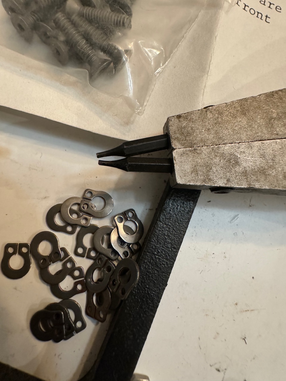

All eclipse will be replaced with RCPS #510 retaining clips. I went through several sets of circle pliers before I found a set that would work with these little…things.
Will be using Tecnacraft turnbuckles, MIP CVDs, MIP hard body shock bodies with MIP golden shafts and I have TPS shock pivots in route. I have chosen to fall out of line a little bit here and spring for the newer production blue Factory Team aluminum shock caps.
I have a set of trinity cells a lite sink heat sink and so far planning to use T&A aluminum wheels with trinity spike tires front and rear and have not decided on electronics yet.
Will update when shock pivots and transmission parts arrive. Here’s a few pics of what I’ve got so far.

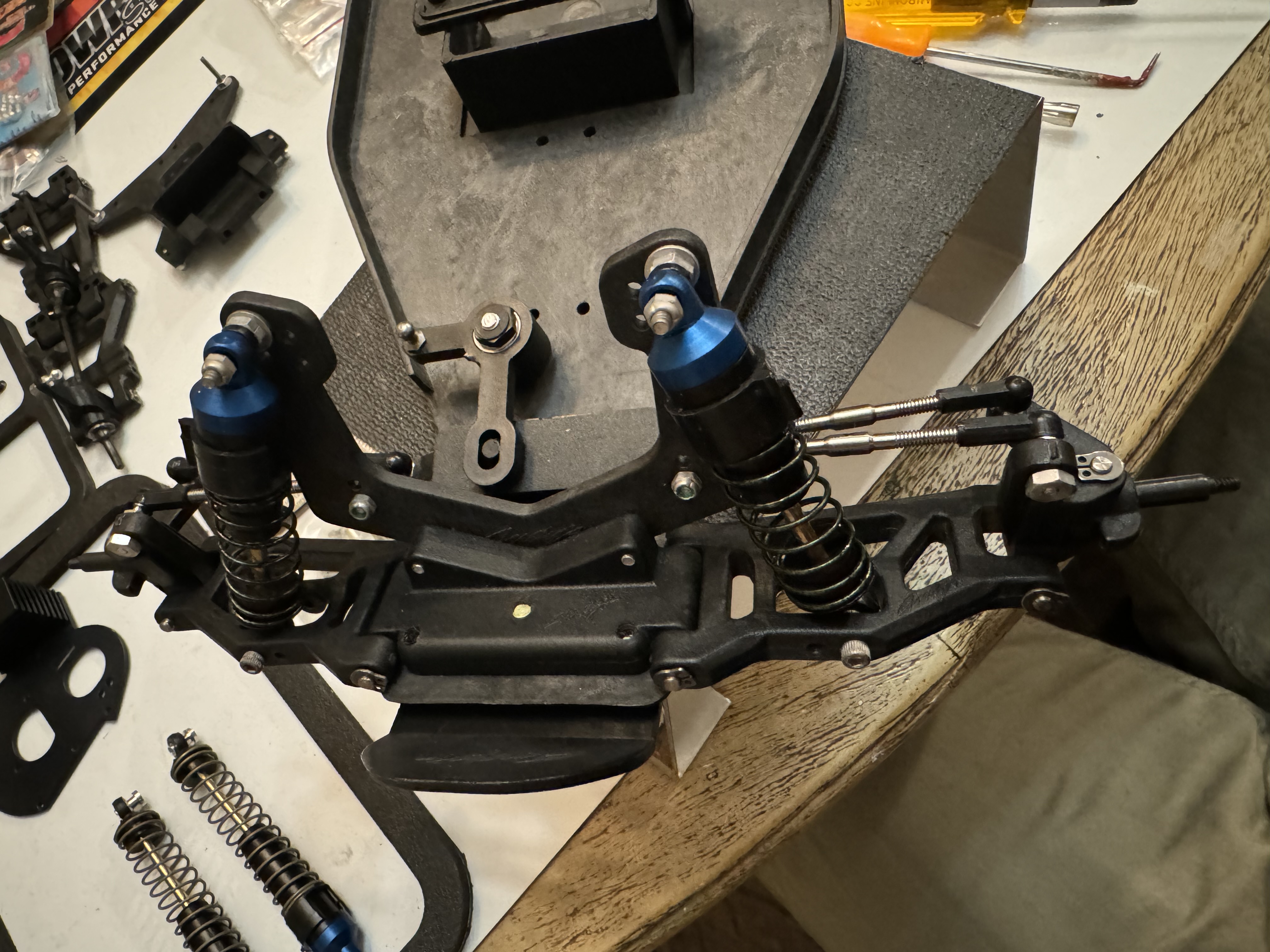

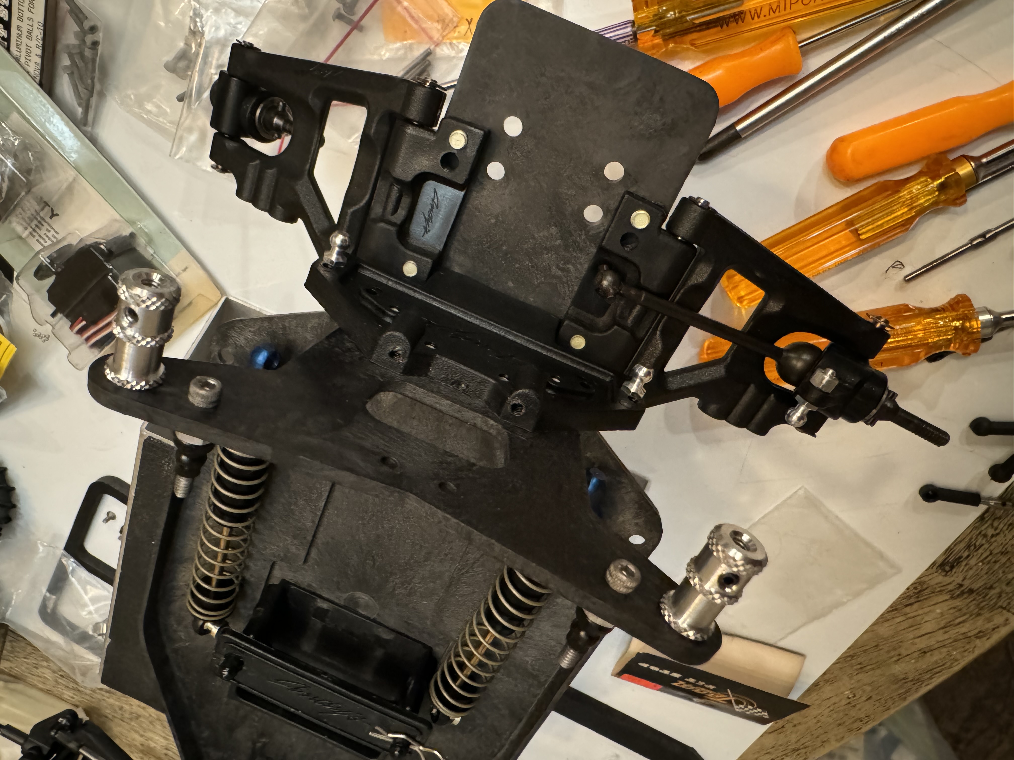

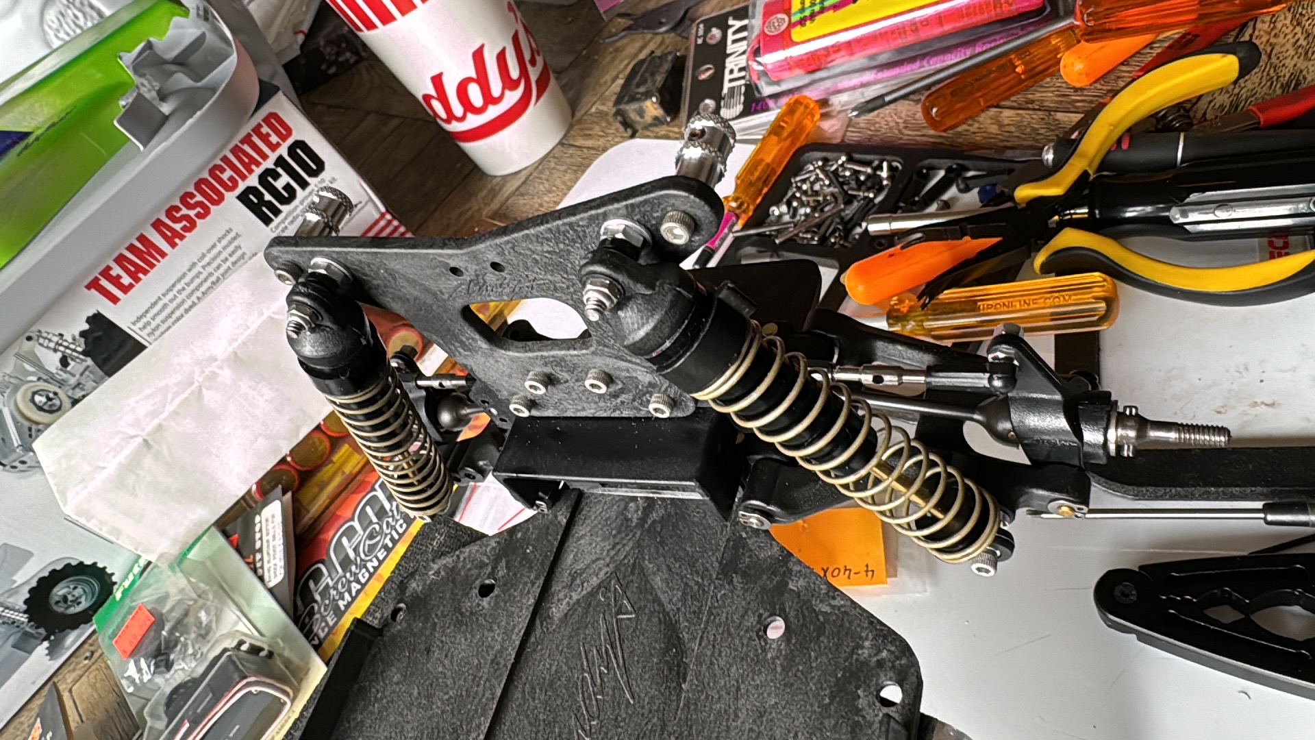

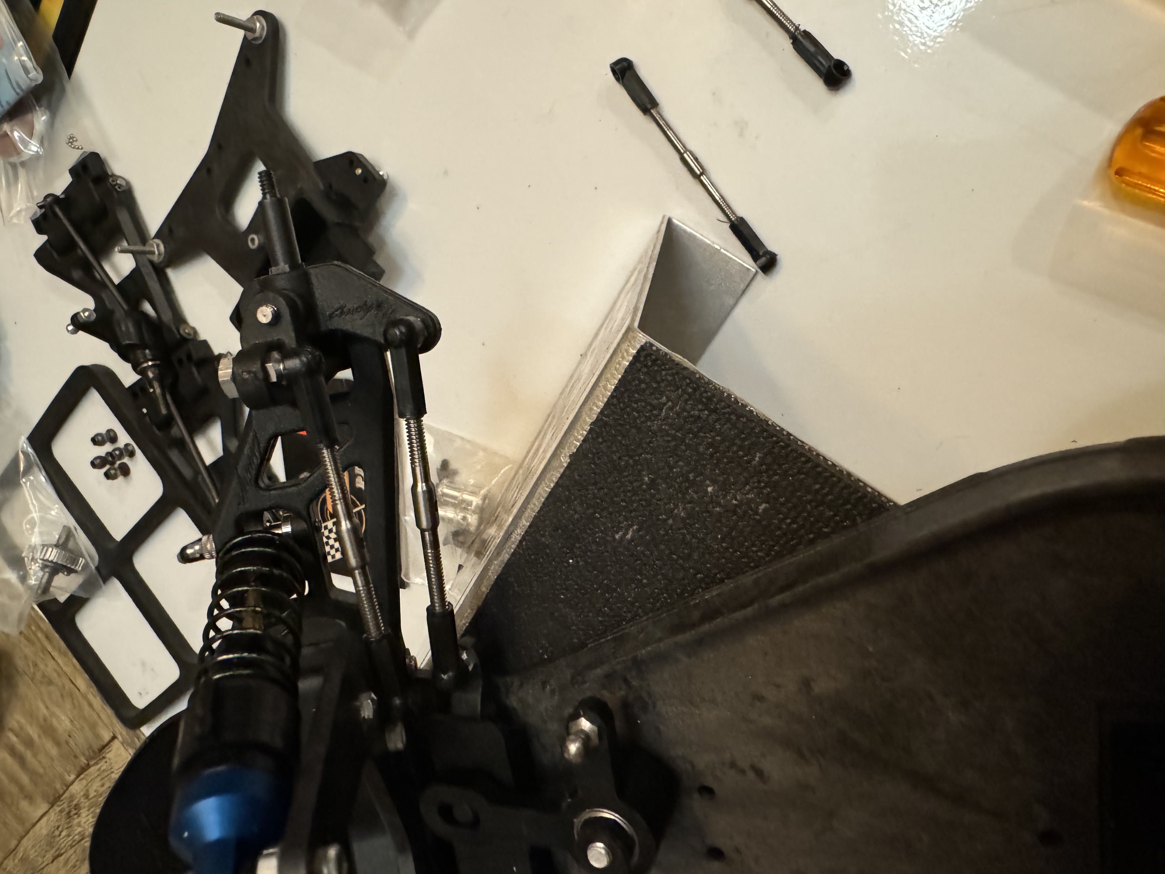

Had a little time today to do a little more work on the car. I received the TPS shock pivots so I installed those on the MIP shocks. Put some black AE ball cups on the turnbuckles and got the front end on the car. I did use a set of Andy’s front axles. I also changed out the Andy’s castor blocks that were a little marred up with some new ones.
The TPS lightweight screw kit did not come with and 3/4 screws for the shock mounts nor enough flat nuts for the shock mounts so I used some tecnacraft titanium 3/4 screws and the holeshot aluminum nuts and washers. I also mounted up the rear bulkhead and shock tower. Added a set of TPS wing mounts. The rear shocks are 1.32 and a bit long so I plan to add three spacers inside to shorten them up and bring the arms and axles up to near level. The rear turnbuckles supplied with the team car kit were way too long so I found some shorter tecnacraft turnbuckles in my turnbuckle stash that were a more acceptable length but called it a night so I could get caught up on the latest Reacher episode. I should have my transmission internals this next week. However I’ll be leaving town for a convention and probably won’t get that put together until after I get back.

Looking good, Shane. I think we have cornered the market on TPS accessories as of late. I really like those wing mounts since you don't see them that often. Not sure if you have any straight wing wire, but K&S (USA) still sells .062 on their website.

Yes sir. TPS FTW! I believe I’ve got some straight wing wire. If not that good to know.

Another little update today. I’ve been debating on whether to pull the FT blue shock caps as they didn’t come on the market until late 90s and aren’t really correct on this car. I really like the looks of them and have a few sets on different models that they really shouldn’t be on. In the end a good friend asked me about them and that’s all it took.
This car is probably my favorite build of all my cars. I love the history of it, the molded Andy’s logo in all the pieces and the fact that I consider Andy Jacobsen a great friend all contribute to that.
I decided the car deserves to be as accurate as I can make it. If anyone sees something that isn’t quite right, I’d love to hear it. I am not offended by constructive criticism of suggestion at all.

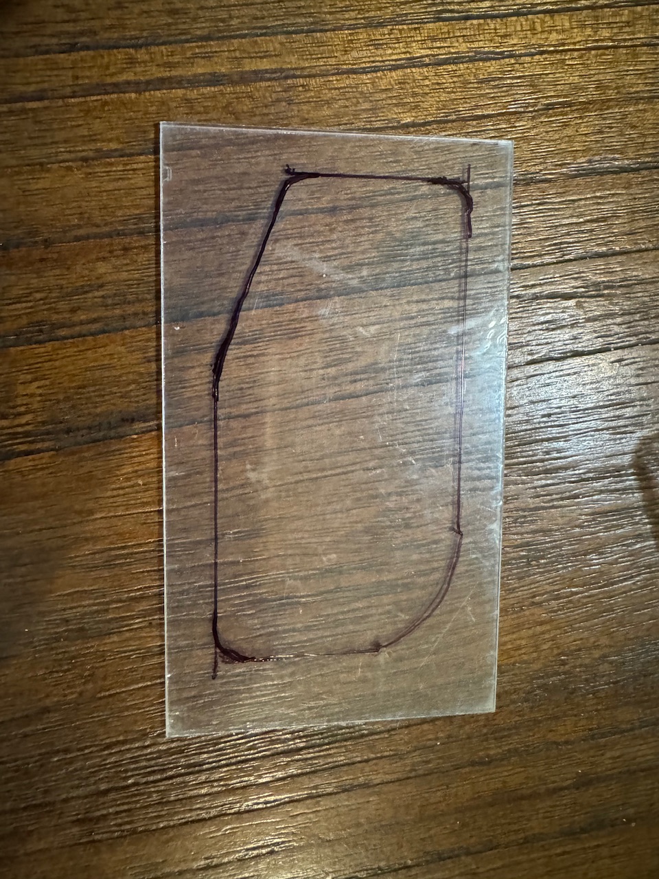

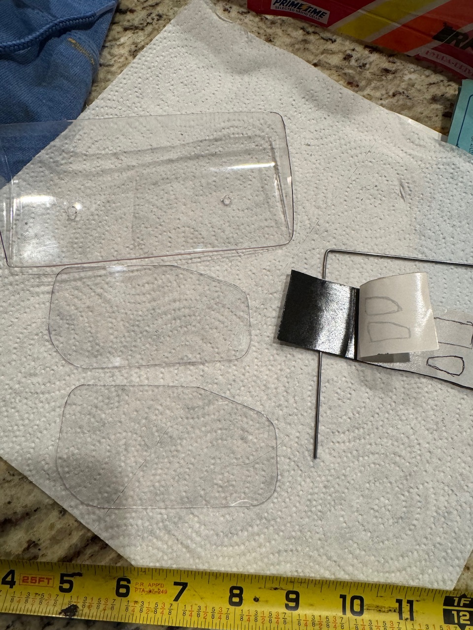

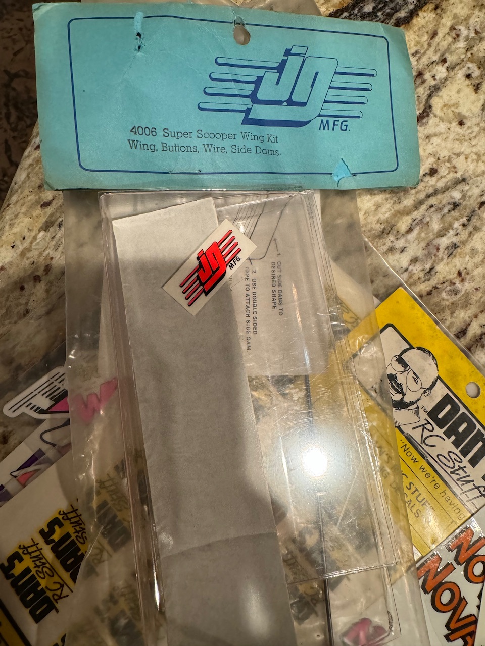

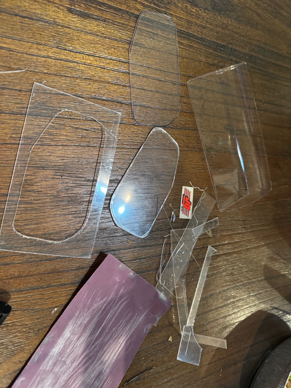

Small bits of progress tonight but it was kind of fun and different from what I usually do.

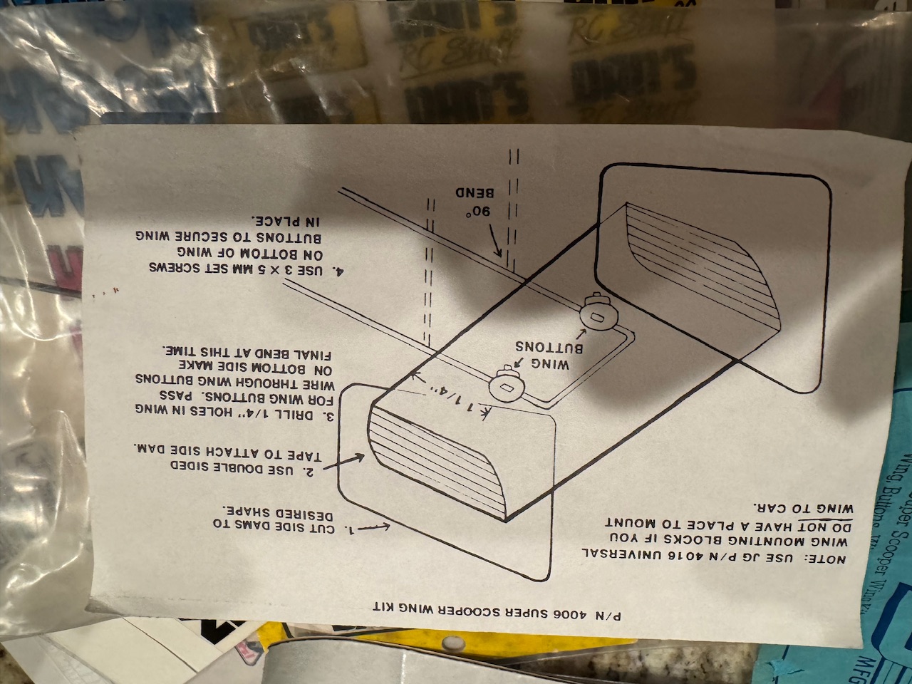

I decided to pick a wing from my pile of various wings. The JG scooper is one I picked up recently and it is kind of a design your own. At least the side dams. So I spent a lot of time trying to come up with a decent looking shape that was different from all the other large side dam wings I have and came up with this. I’m happy with the shape. I’m going to try and clean the edge up a little more. Spent some time on it with the dremel. Probably needs a little more. Found a straight wing wire and got it bent. Need to trim it still. Wing buttons I need to track down. I have some silver aluminum. Can’t remember who made them off the top of my head but pretty sure I have some. Otherwise I’ll probably dye some buds buttons black. The double sided tape that came with the wing is black. I am hoping I can find some clear at my shop tomorrow. I think black would look goofy.
