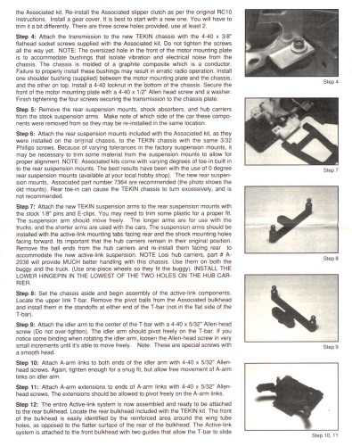

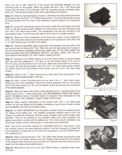

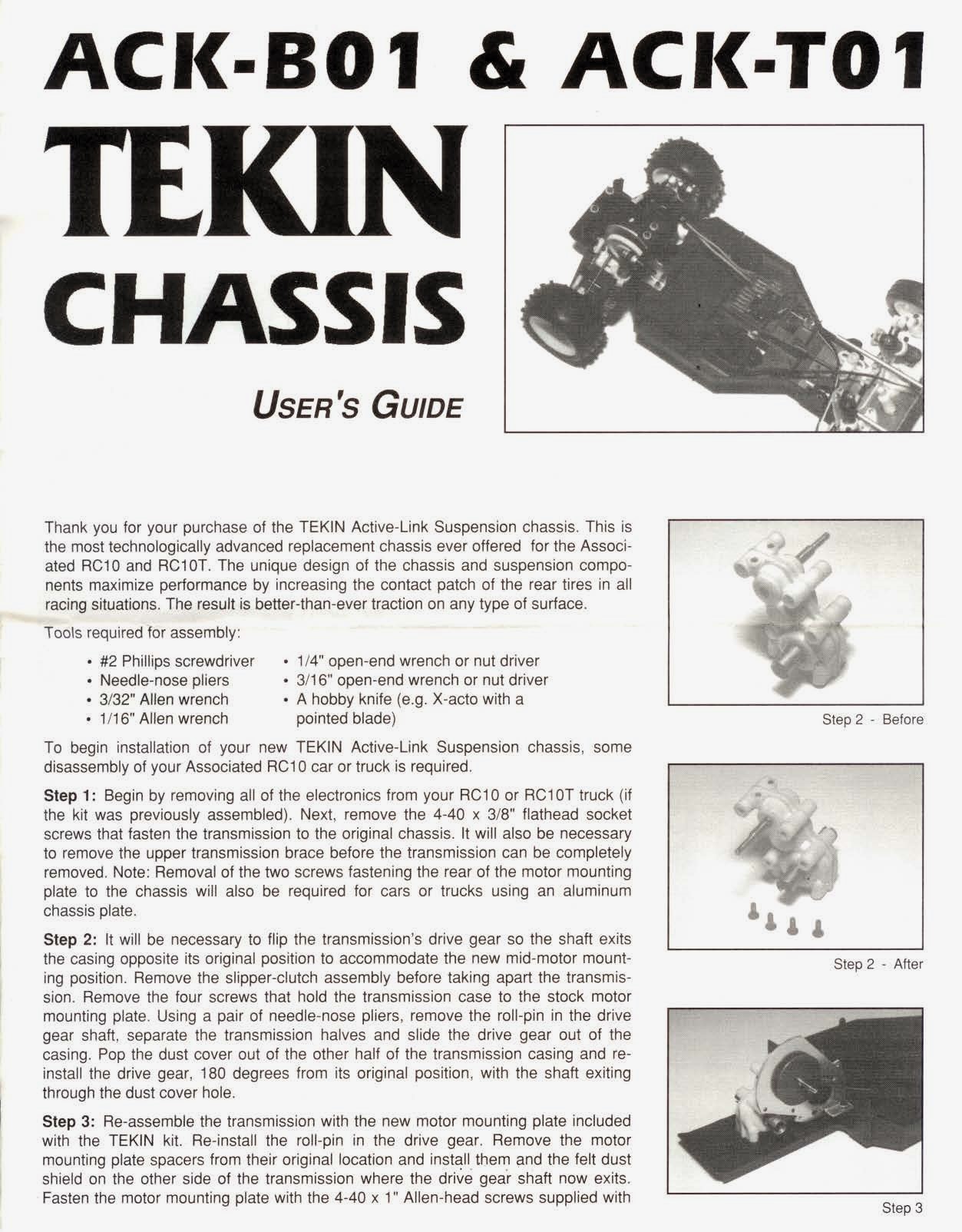

This manual is on Tekin's website as a pdf, so I just extracted the images and enhanced them a bit. I will be building up a new truck kit soon, and I figured that I would reference the manual at some point.
https://www.teamtekin.com/manuals/TekinChassisKit.pdf
