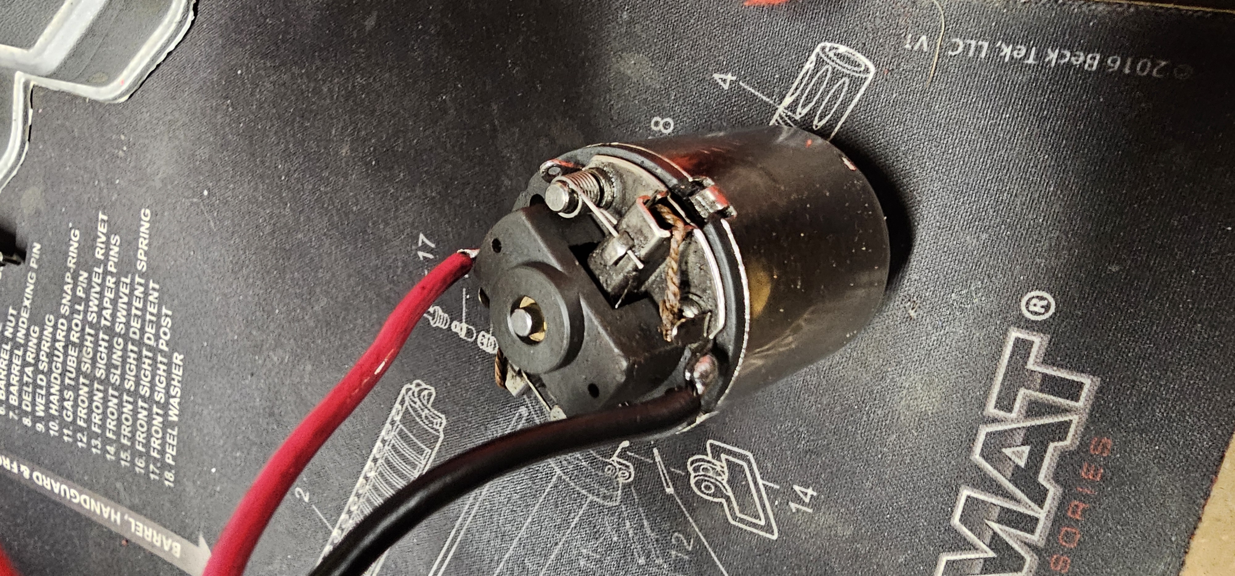

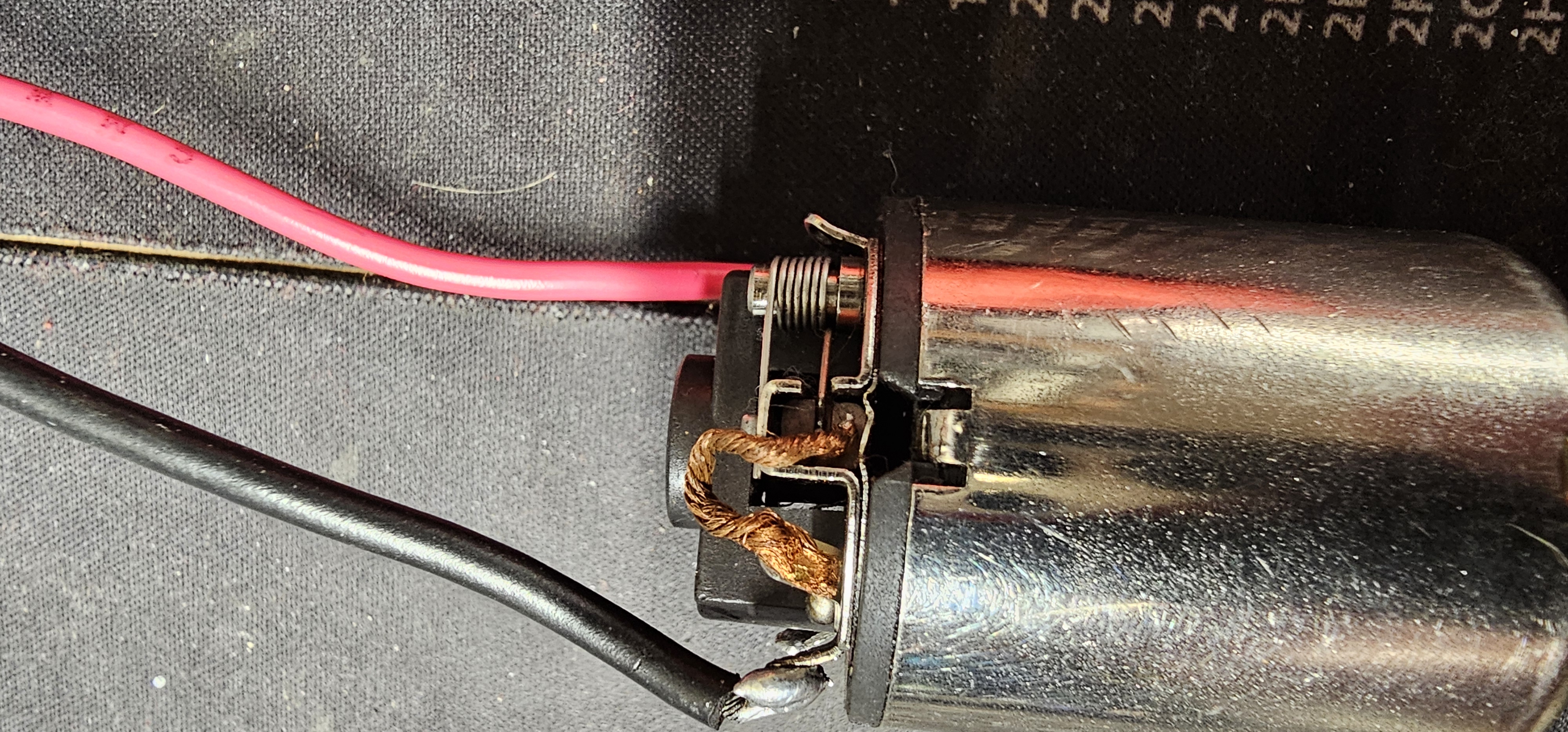

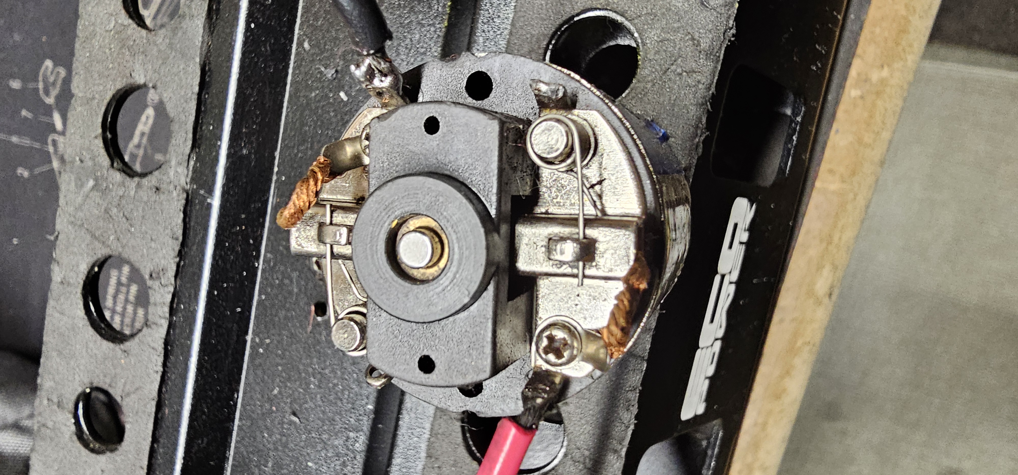

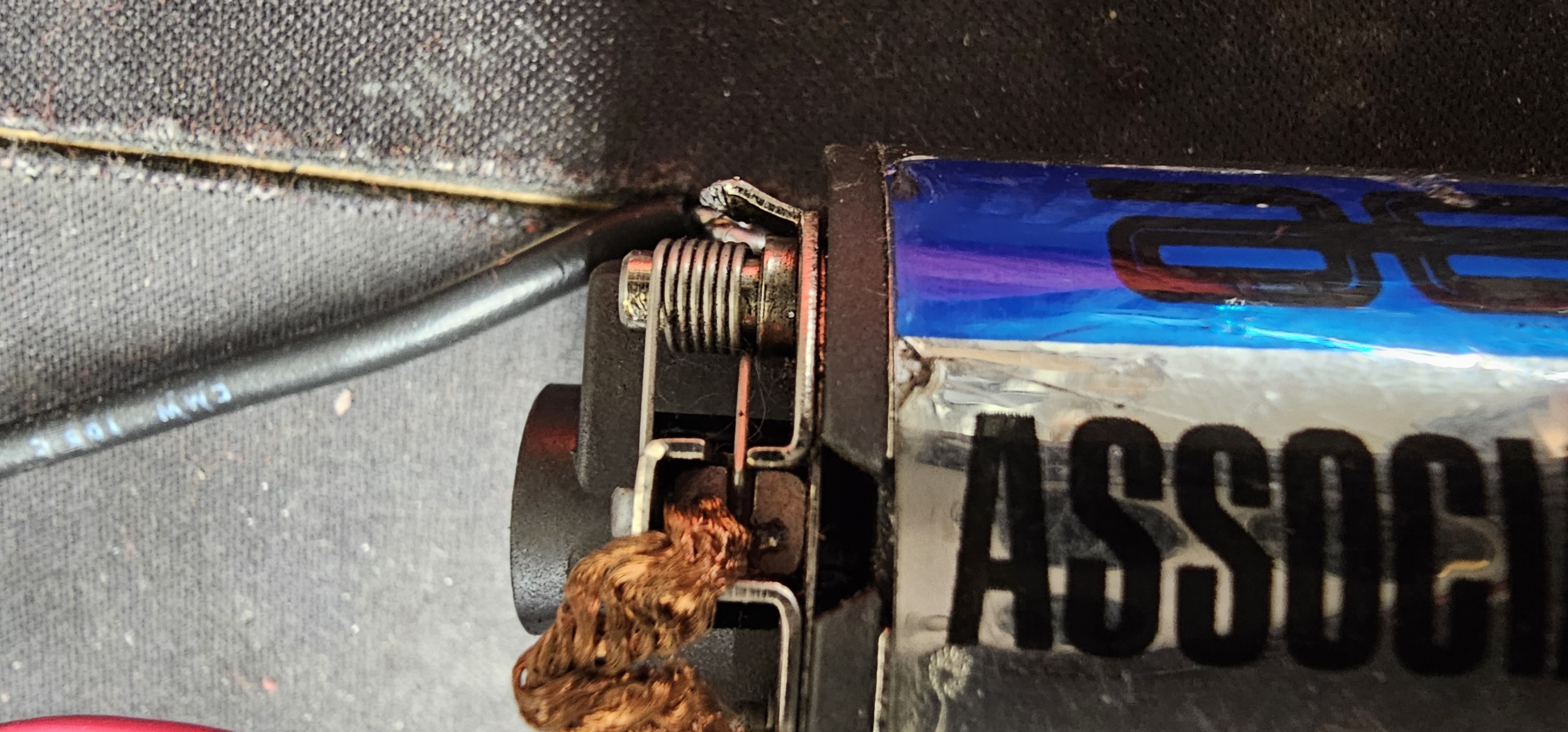

Pictures. I also posted a video on the Facebook page because it was too big to post here.
Posts: 3539
Has thanked: 269 times
Been thanked: 2094 times
Re: Vintage Edinger motor stopped working
Those brushes are shot. There probably isn't any spring tension on them.

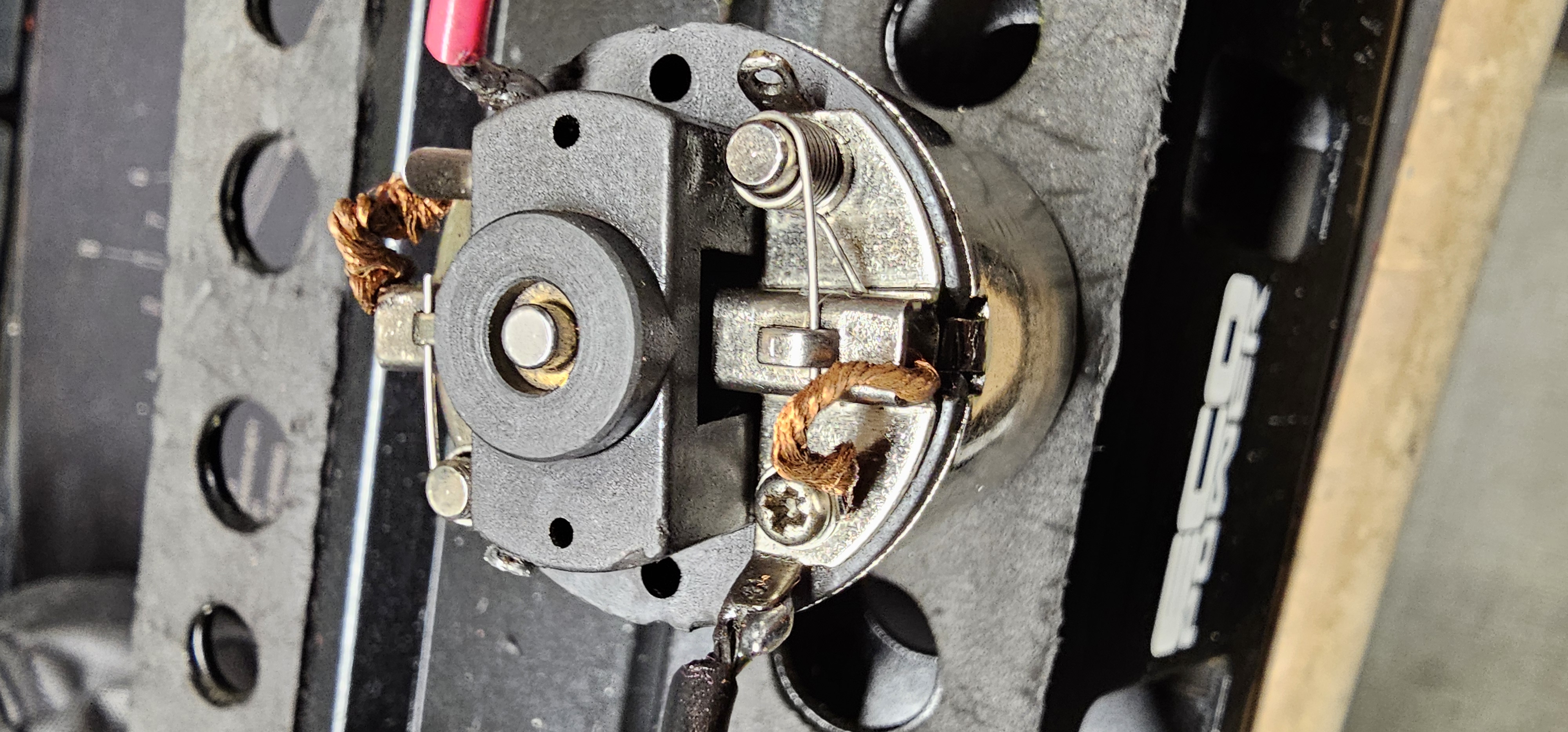

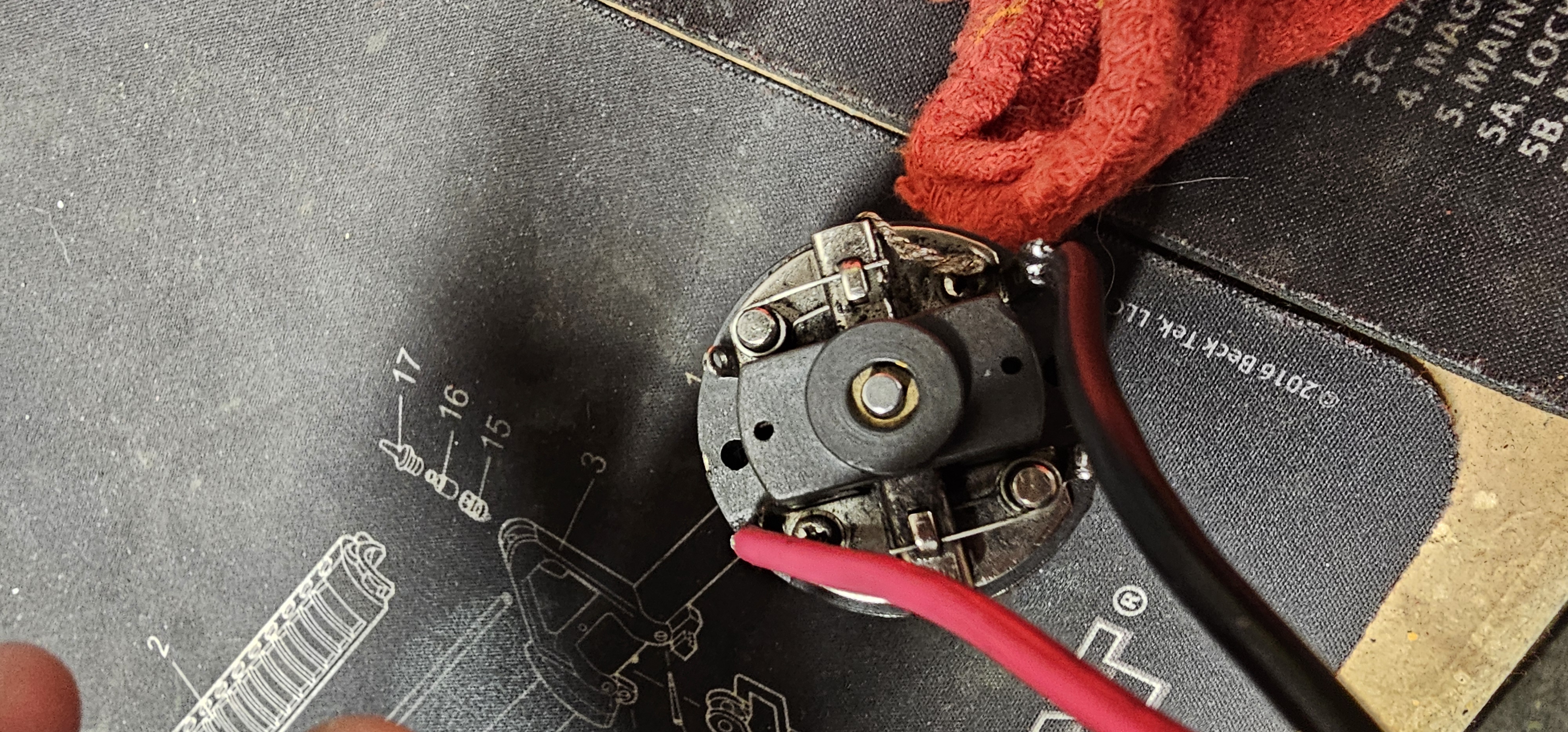

Replaced the brushes. Cleaned it up. Dropped some oil in the bushing. I don't know how to take it apart so I can't check the commutator.

I have never opened one, but I have read various methods on this site. If no one responds, you might try searching. Your motor has been opened at least once already as evidenced by the motor tabs. You might be able to get a small flat blade screwdriver under them and pry them up to remove the cummutator since they don't appear to have been pushed all the way down last time.
In case you don't know how JuicedCoupe determined that your brushes were shot just from the photo, look at the springs, specifically the part pushing on the back of the brush.

The brushes were shot. The new ones were a lot bigger when I replaced the old ones. I saved the old ones for "original parts ' I have collected. I will probably give it a quick run and then shelf it with my other restoration jobs and original builds from long ago.
