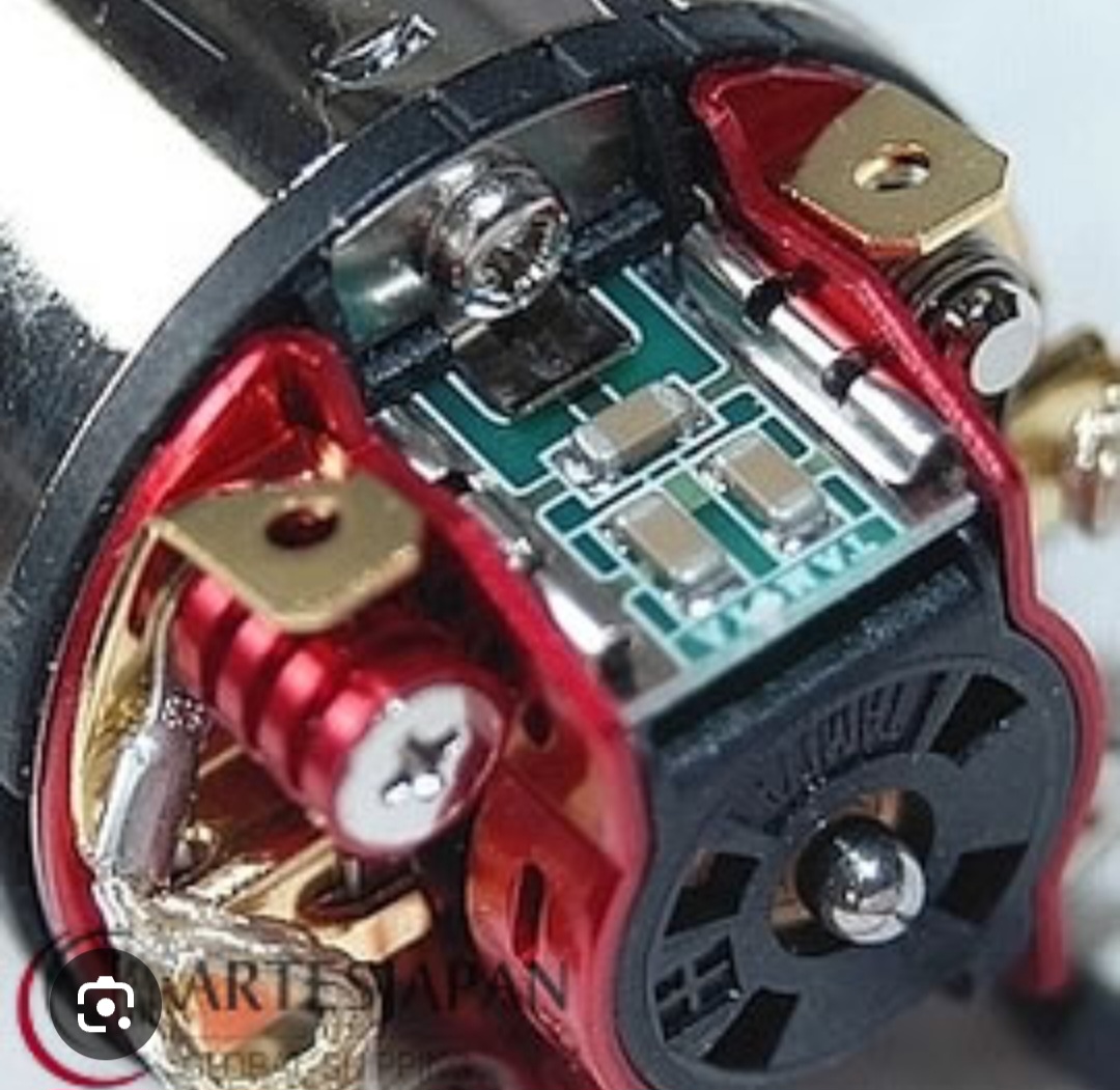

For reference, some modern motors (Tamiya, Yokomo) do have caps. The ones on the Tamiya are on a small circuit board.
