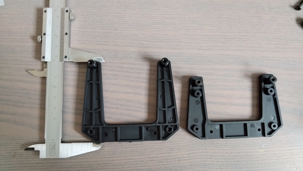

1. Front shock tower SM-33
It uses long shocks front and rear. Regular Outrage front shock tower for comparison.
Over the years the front shock tower must have bent under the spring load.
I feel buying a new one will result in the same result down the line. Is there a a stiffer version of this part?
The short shock tower can be replaced by a carbon one for the Ultima. (Tie rods wont fit but that's a diffrent story...)

As for the shock tower, I started to model it in FreeCAD and will look for a Vendor to make it from Aluminium sheet material. What thickness should I go for? 2.5 mm?

Factory Works (member GoMachV) could make your shock tower in fiberglass or carbon fiber. He's done excellent custom parts for most of my projects.

I actually found the long tower on the website. Not sure about the geometry though...
I'll shoot them a message.
Thanks for this!
