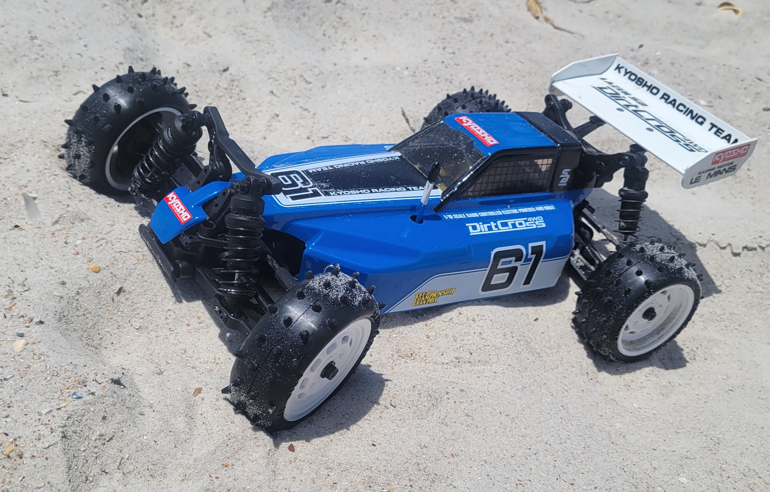

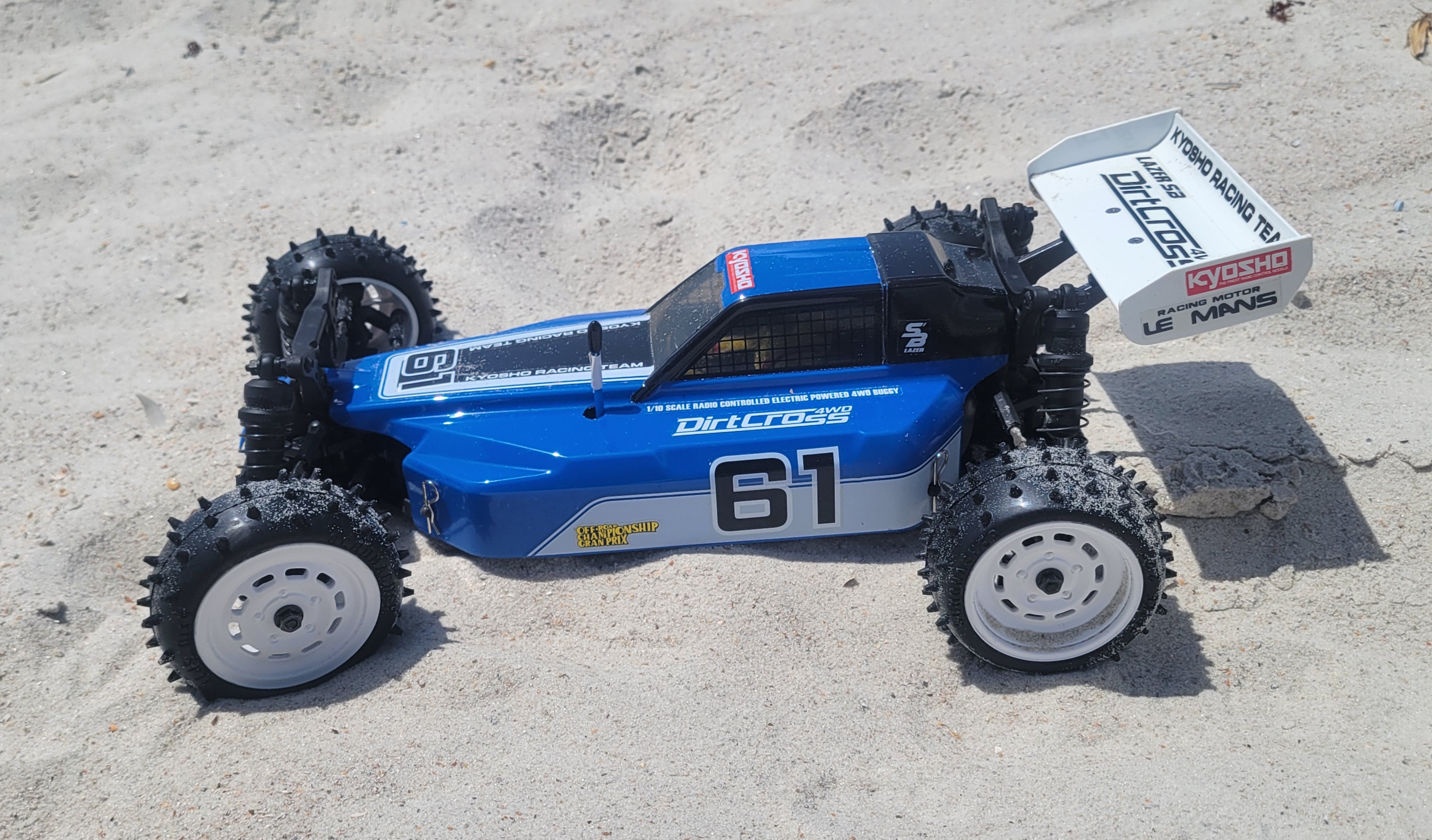

So, it's basically box-stock except for the option wing mounts with a Javelin hard plastic wing and aluminum wheel hubs. For the esc & motor I had an unused Mamba X and 1406-5700KV motor that was needing a new home. The Mamba is big but fits fine on the battery side with a shorty pack. I geared it 18/73 which is 10.82 FDR according to the manual. For tires I chose Schumacher "Full Spikes" front and rear in Yellow compound.
Here's a couple of pics:

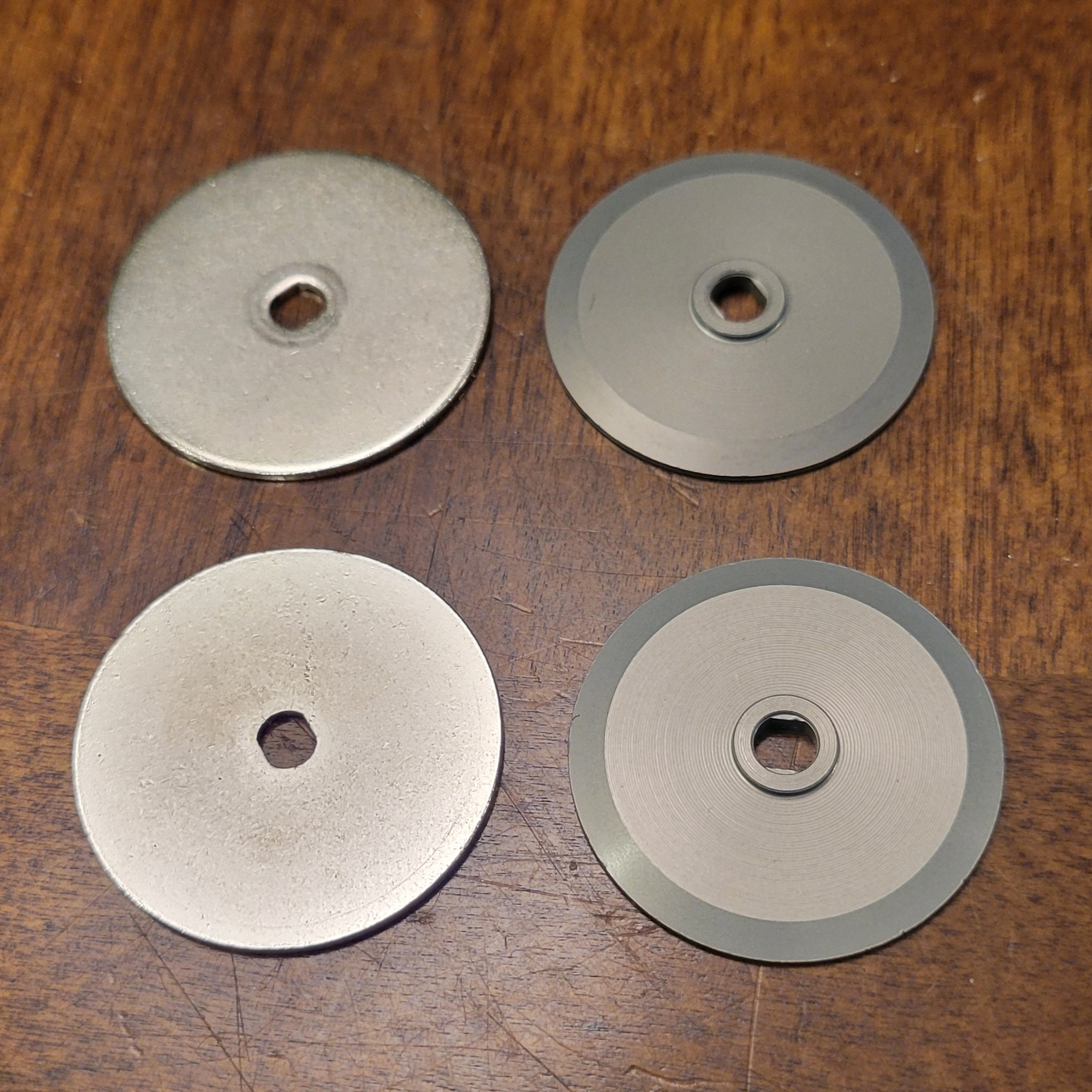

Also, the kit supplied slipper plates were not much more than flat washers. The ZX-5 LA204 plates are more substantial, can be used as an upgrade and also work with the B4 spur gear and slipper pads. Pics posted below...stock on left and LA204 on right:
