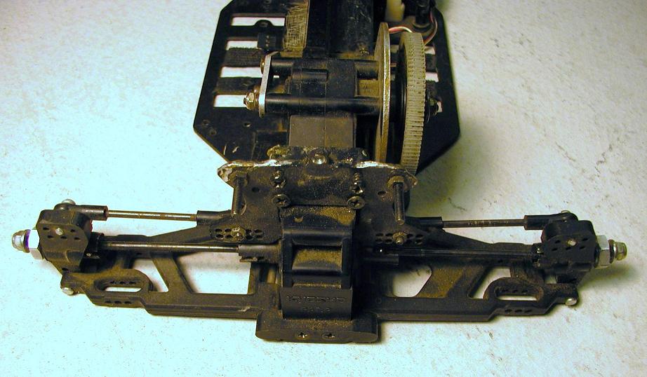

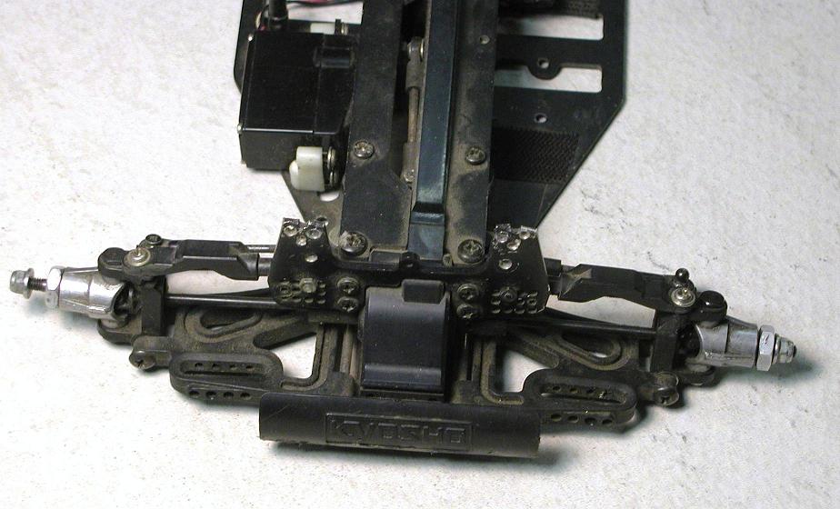

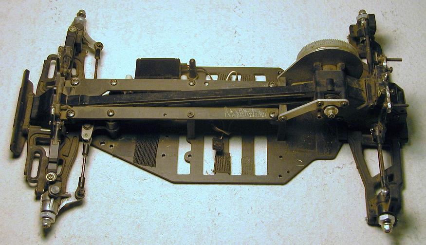

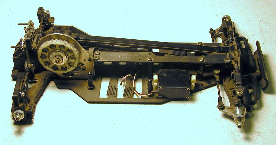

Here goes...These are pics of the car how I received it, shame what people can do to a car :roll: I got it cheap though, and it has a CF chassis that is in decent shape. I don't believe it is stock -maybe composite craft? Also it came with a different front a-arm and hub set. RS maybe?

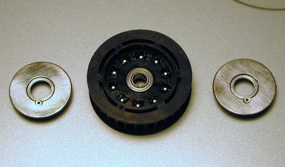

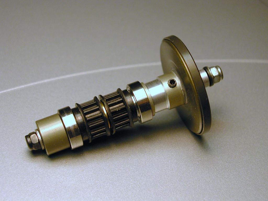

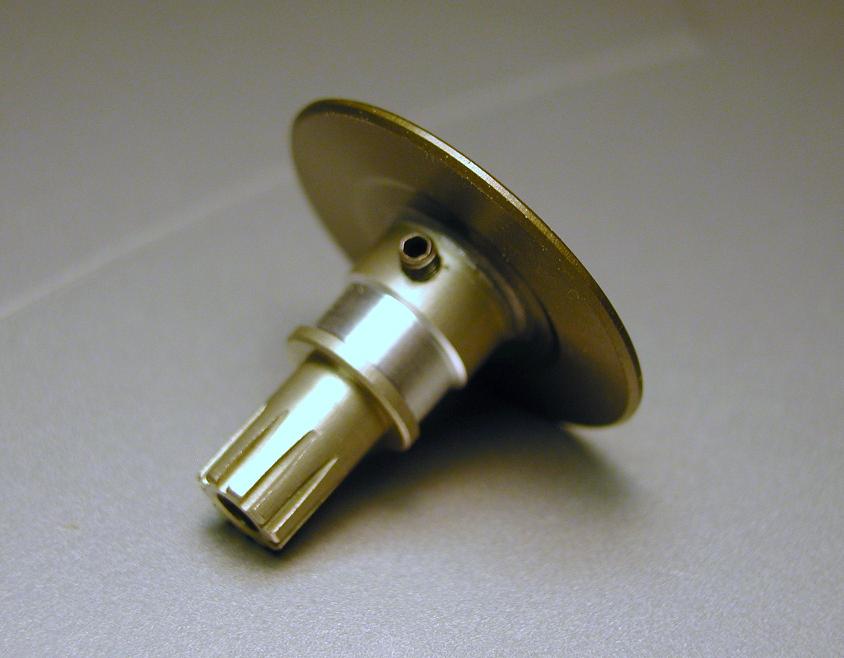

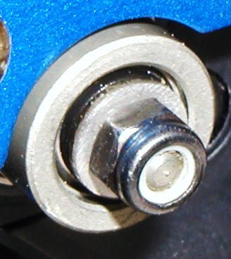

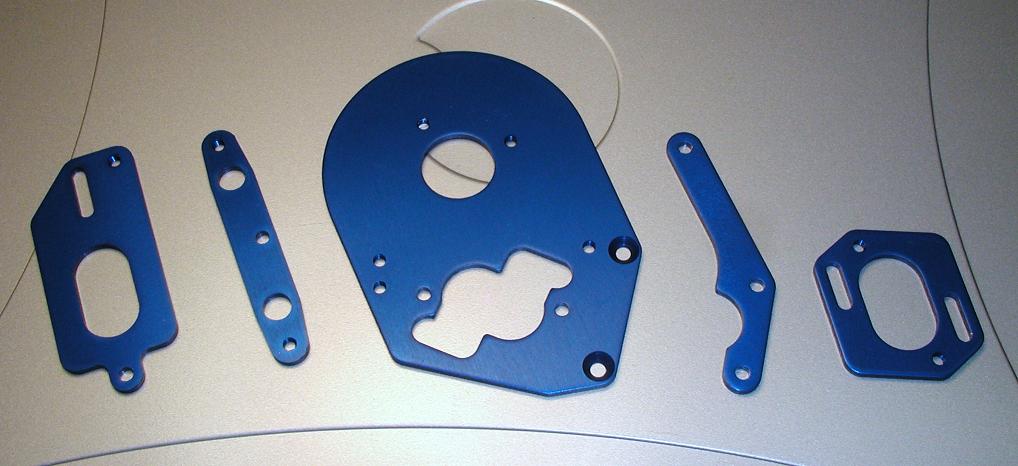

Here are some of the mods that I have done to enhance performance/reliability or looks. First, I retrofitted a modern style Schumacher slipper assembly to the original drive hub. Than I pinned the differential drive rings and bored a 8mm hole in the diff pulley so it would be bearing supported. Next, I replaced the aluminum washer on the layshaft that covers the one way front pulley with a thrust bearing (maybe helps with side loading :), and finally had all the aluminum parts (aluminium if you prefer :) anodised blue. Had it done at a local shop (2 full sets for the car actually) only cost me $60 USD. The guy said he could have fit more on the anodising tree if I had brought them :(-maybe next time.
Lazer one way close up.jpg (49.19 KiB) Viewed 2379 times
Lazer modified layshaft low res.jpg (93.69 KiB) Viewed 2367 times
Lazer slipper mod Low res.jpg (55.55 KiB) Viewed 2367 times

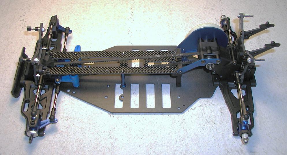

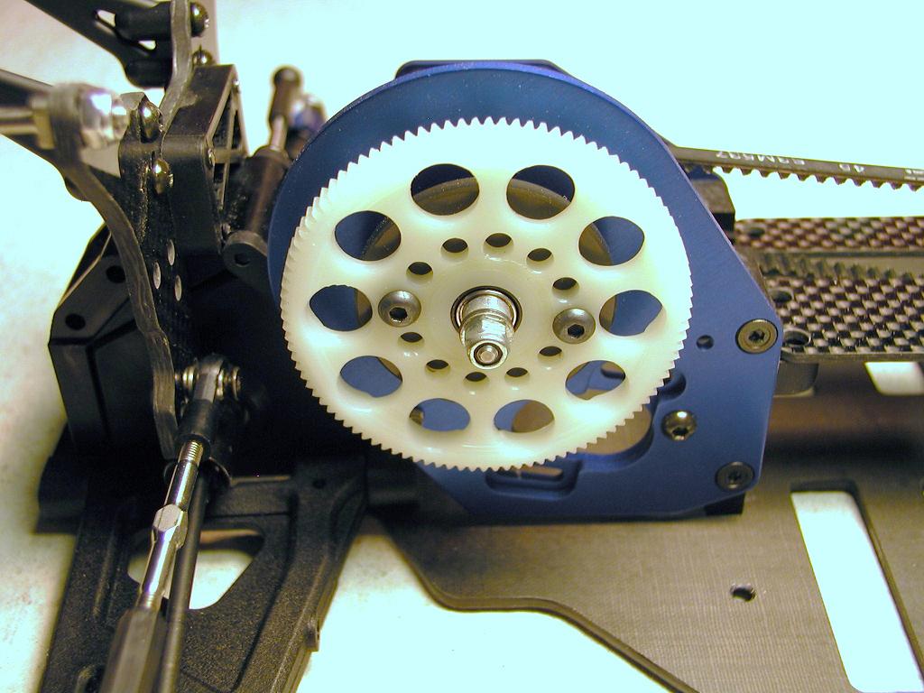

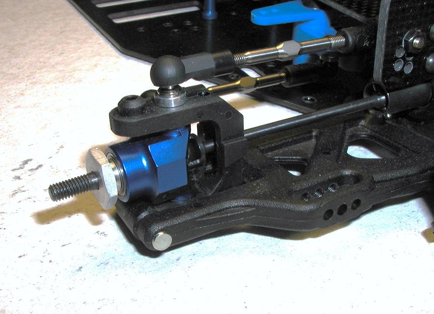

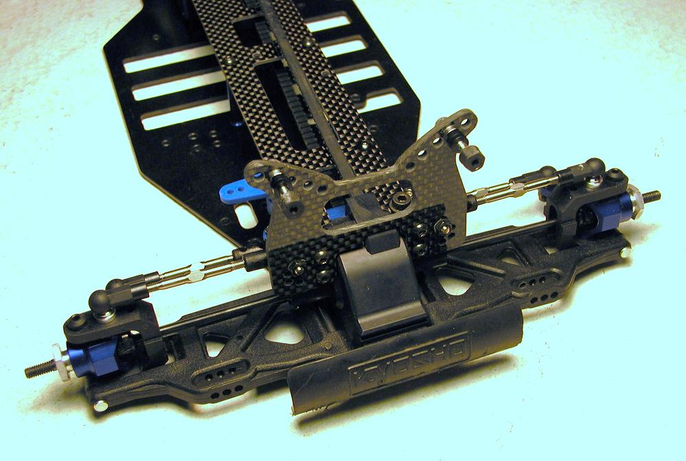

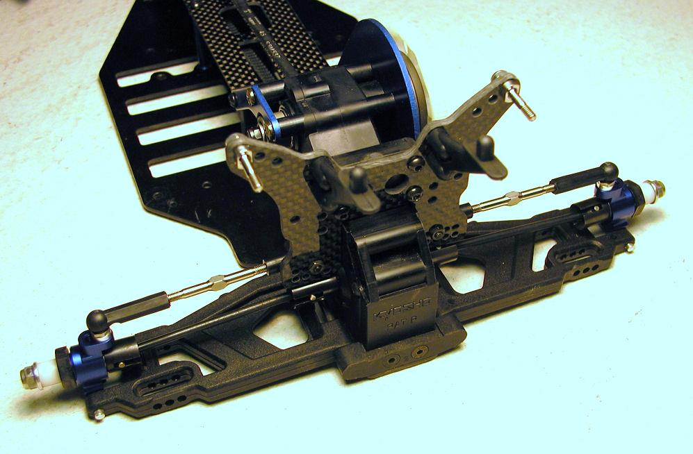

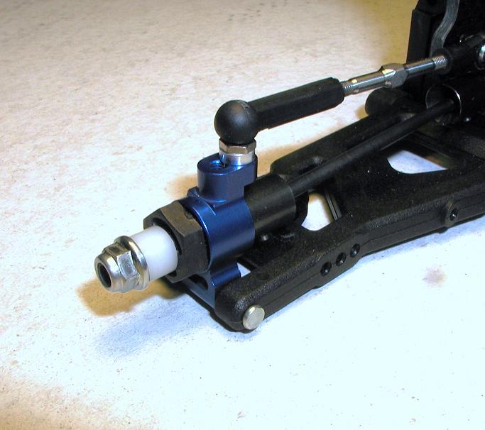

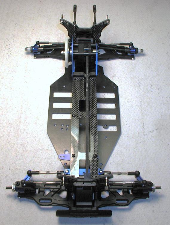

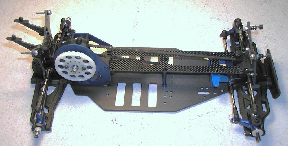

Here it is, mid project. Nearly all new plastic, new shock towers and upper deck from Fiber Lyte, one way front diff, creamic bearings, rear ball diff, optional heavy duty steering, aluminum steering knuckles and rear hubs, Lunsford tie rods, ZX5 wing mounts. Soon will mount the shocks, new gear cover, rear sway bar set and a body. Hope you like.
Lazer top low res.jpg (80.72 KiB) Viewed 2359 times
Lazer steering hub low res.jpg (91.24 KiB) Viewed 2354 times
Lazer spur-slipper low res.jpg (113.03 KiB) Viewed 2354 times
