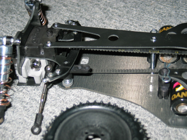

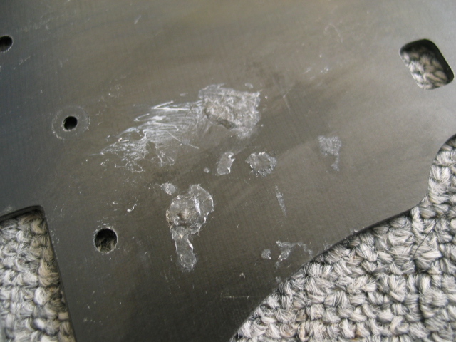

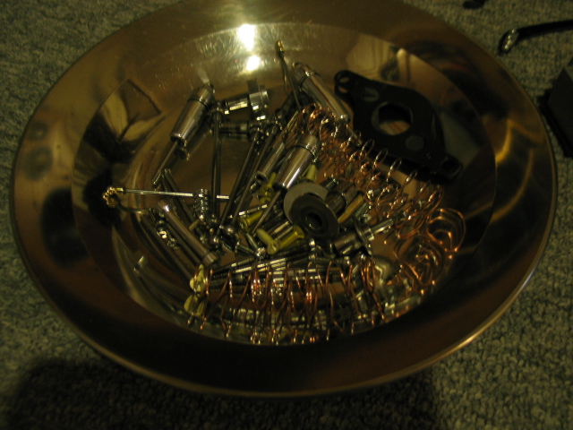

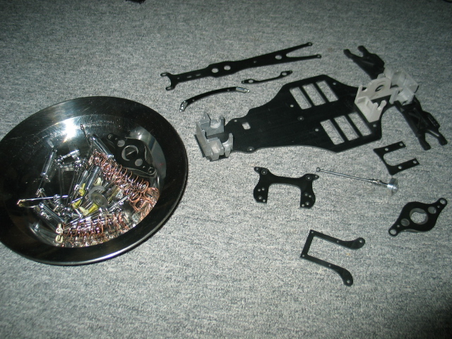

this is my latest project..lot of polishing invovled really got stuck into it today and im quite happy with the end result.. got to love the buff!
and the bead blaster

Nice job Gary,
A few years ago, I polished up the magnesium bulkheads, motor mounts and hubs on my yz10. After a short time, it became dull because of the oxidation. I re-polished everything and I sprayed some clear coat over the parts.
Just an FYI, I used a wire brush on my dremel to do the job. It cleaned up the part from a gray color back to a silver color (but not too shiney).

thanks gents ive woke up this morning and glanced over the yok as ya do
and noticed the magnesium starting to tarnish alrealdy were as the front and rear alloy ones are still spot on think i will clear coat roger thanks brother
body is in good shape ill repaint it out of respect for the mighty works

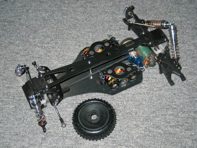

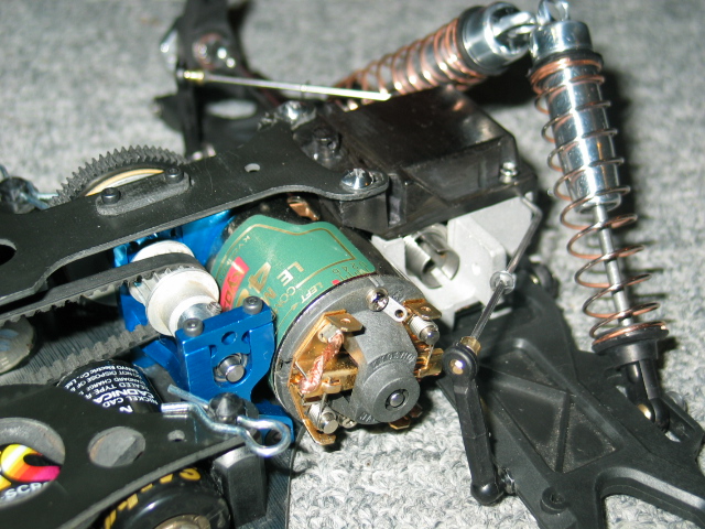

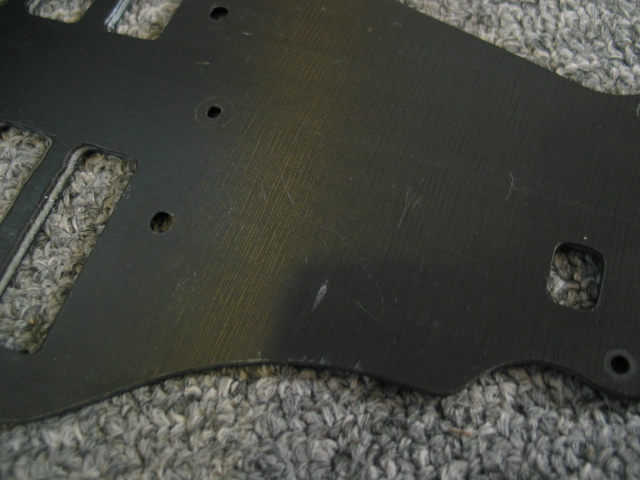

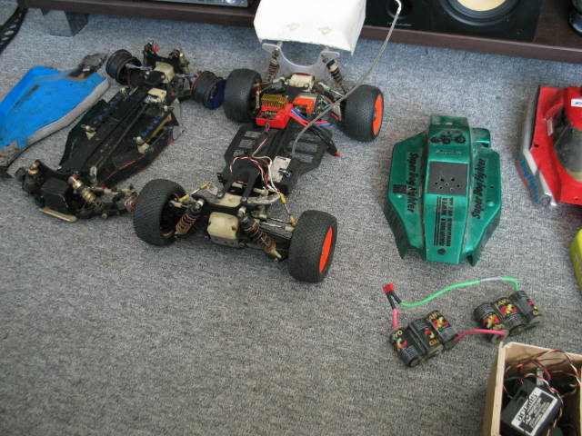

this is where im up to after a week of polishing, dying and cleaning going for the black stealth look

Really nice. I personally wouldn't have dyed the white bits but it looks very good. What's the hop-up motor mount you have put on there, Corally?
Such a funky design especially that front, torsion bar system (is that the right word?).

im a fan of the white also a lot of the parts where very badly dis-coloured so the quick and earier option were to dye of coarse anyone got any spares for these i need rear shock tower,front arms one more matching ti turnbuckle and some new bulkhead covers would be nice....the motor mount is team suzuki ed
