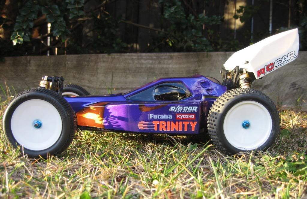

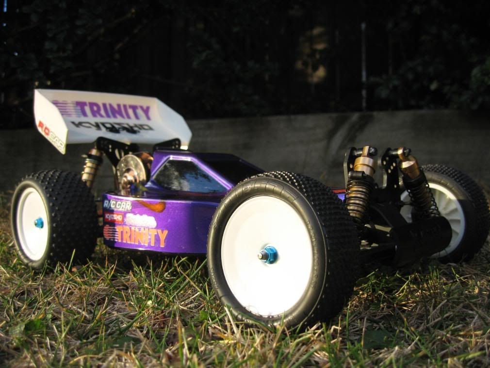

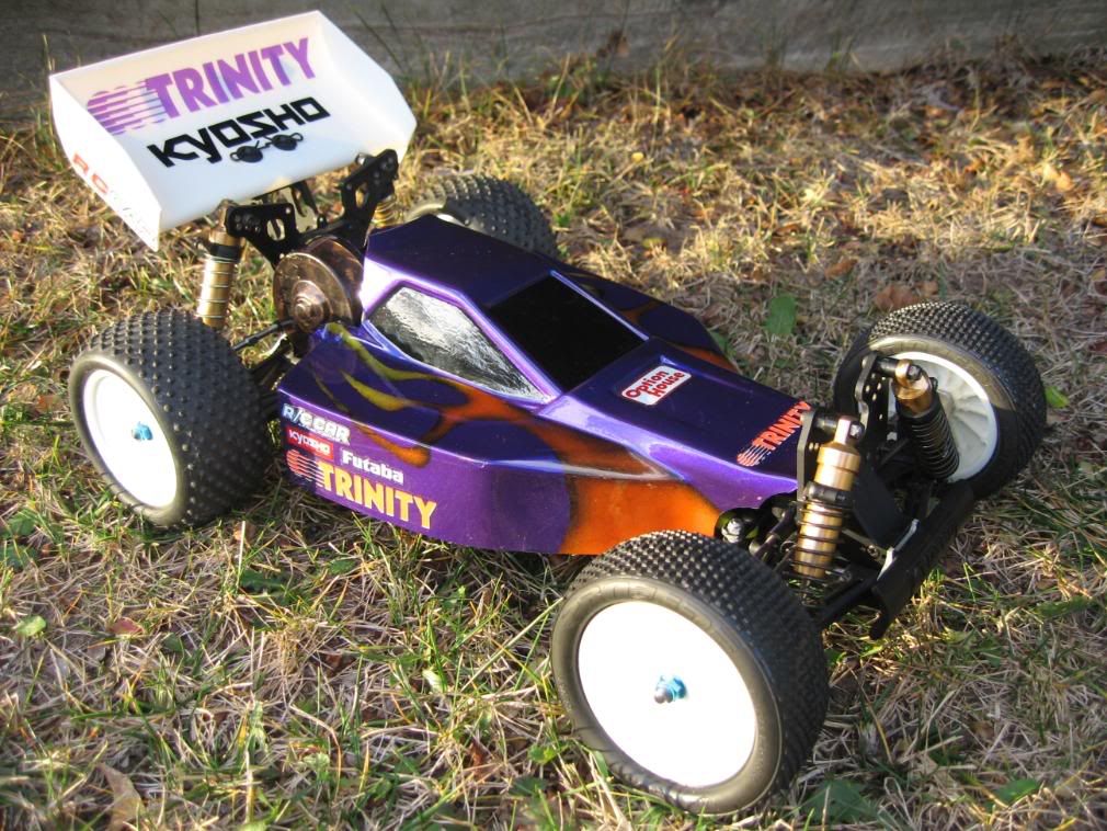

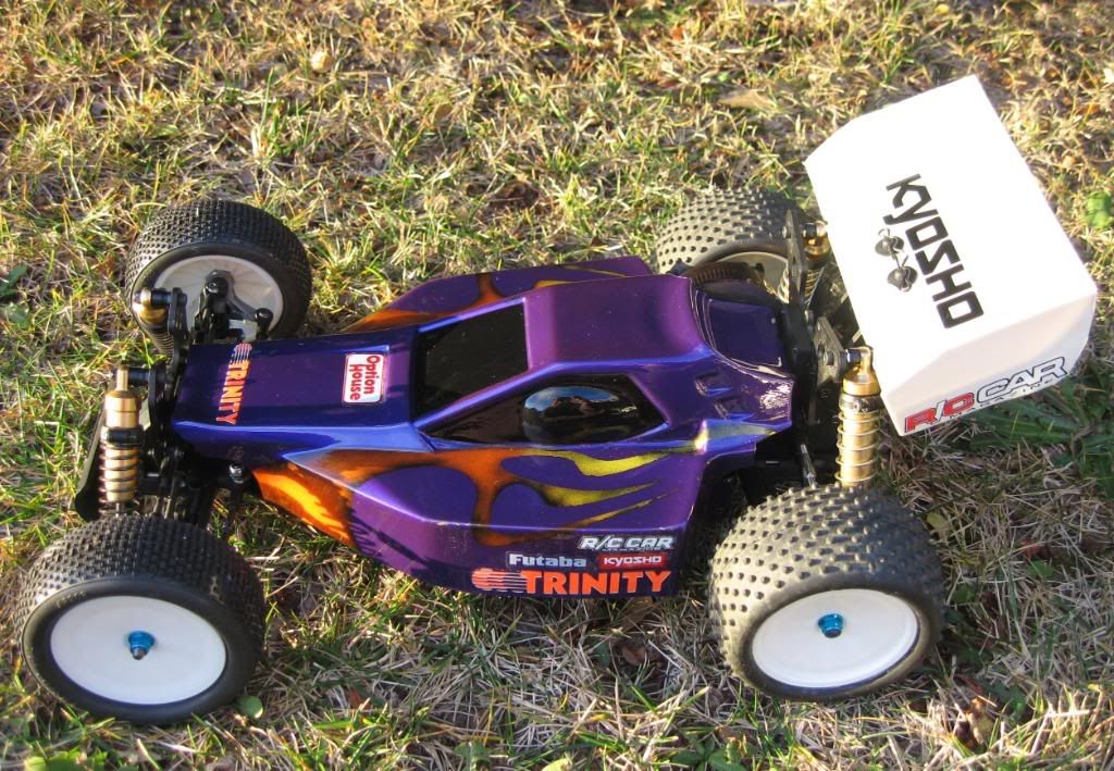

Hi Guys,
I have been feverishly trying to prepare some classic cars for next weekends large vintage race meeting here in Australia.
Last year I ran three brand new un-run cars - the Marui Samurai, the AYK Viper and the Kyosho Lazer ZX-R.
This year I am going to be running some nicely restored cars. The first one that I have gotten ready (well - almost - just need to tidy up the wiring and a few other odds and ends), is the SWB Kyosho Optima Mid.

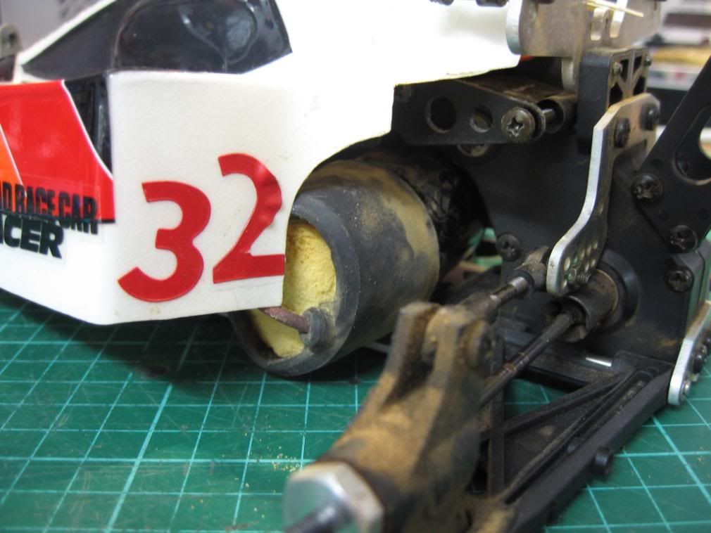

This car was a bit of a clunker - as you may note from the "before" photo's. I completely stripped her down, rebuilt using ball diffs. Also added Gold shocks and a repro body from Marwan. I decided to get a bit funky and add a brand new Trintiy "Butterfly" chassis and A&L steering set up. Also did a few mods to the drive train that I used to do back in the old days. This car runs super free now.
I did a really quick paint job on her - mainly because the original body was toast - and Marwans repro bodies are well priced, I can pick up another one and do a much better job for the shelf later on.
I will let the pics do the rest of the talking - I hope you like her - Handles pretty well on the "test track". (road out the front of the house with slicks on!!)
Let me know if you like her!
I have a couple of surprise runners that I am finishing off for this meeting - I reckon I might raise a few eyebrows with one. (Hint - its a 4wd conversion car!!) ;)
Cheers
Darryn

I likey, how mad does it look in profile being SWB with those 2.2s they look massive :twisted: , looks a bit like a 1:18 buggy 8)

That's exactly what I was thinking...the proportions are almost cartonish!! It looks great. I like the Lazer front and rear shock towers and Medium shocks up front.

LOL - yes - the modern wheels and tires do make it look a bit over the top.....I still have some originals, funnily enough - last year the old school tires worked way better than the modern ones....

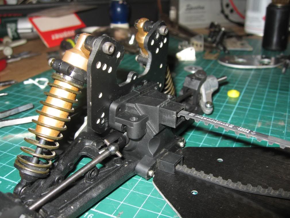

If you want to take it a little further:
You can use the lazer arms without any modification on your mid, just need the correct c-carriers and rear hubs. This will add much to the stabilty.
Add the ultima RB5 CVD's with crosspin clamp hexes and you got yourself a perfect racer for short traks

Well, I think it looks a little funny with the big tires. The wheelbase is way too short for the 2.2s. :| But, I'm so happy to see a "clunker" brought back to it's former glory. :wink:

The outer diameter of the tires (including the spike height) didn't actually change when the rim size went from 2.0 to 2.2 you know.
The tire just became lower profile.

I thought about putting the arms on it - I really did - however I wanted to keep it as "mid" as possible. The towers just give me a few more tuning options! :)
The car doesnt look too bad in the flesh - and as has been mentioned - there is only a few mm difference between the original tires and these ones - the fact that they are disc wheels makes it look worse than it is......you would not really notice it on a LWB!
