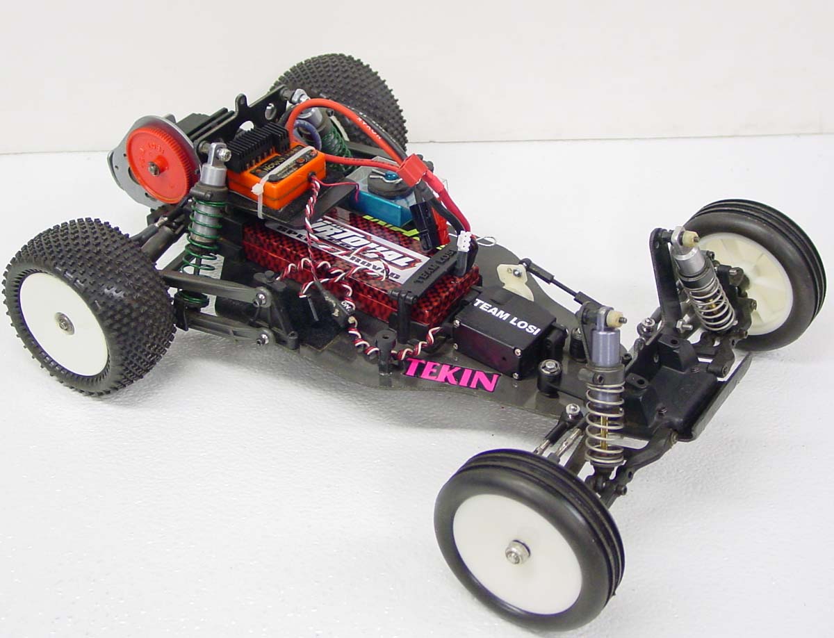

aconsola
Posts: 1999
Location: Upstate NY
Re: Modern rear tires on a 5-link losi?
Post by aconsola »

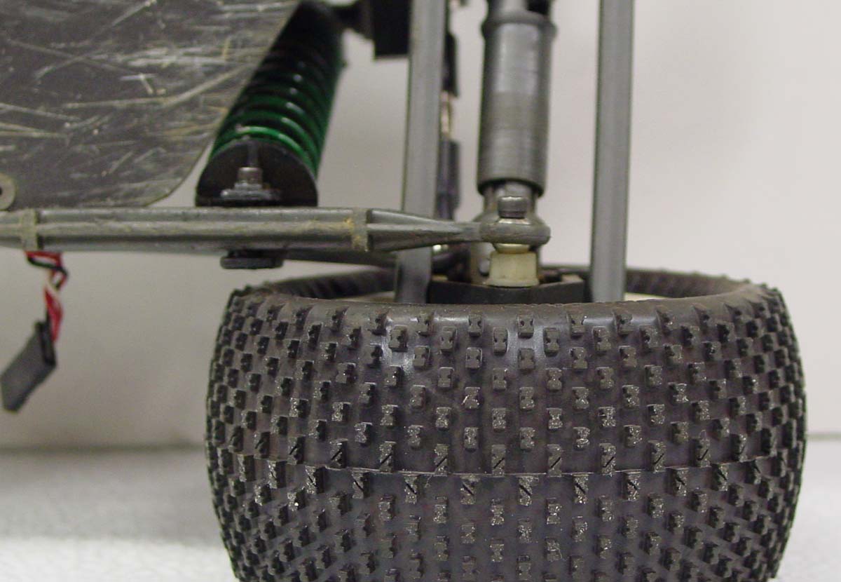

I bought some more wheels and played around a little.
I got a pair of b-4 wheels, these are very deeply offset in the rear. using a .125" wheel spacer puts the overall track width of the rear tires at just about 250mm, which is the upper limit for buggy width according to the ROAR rules online. I found an RCCA flyer/quick refrence guide from 1991 in with all my paperwork, and it says the same thing.
With the wheels setup like this the front inside of the tire rubs slightly on the shock mount at the link. I used a 4-40 nylon nut under the lower ball in the hub carrier to space the link inwards. This gives plenty of clearance, even when taking into account all the 5-ling slop.
I put a matching set of b-4 wheels up front with standard ribbed tires and it comes in at just under the 250mm. This should make it very easy to source wheels and tires as b-4 stuff is plentiful
so the final recipe is:
b-4 wheels all around
.125" wheel spacer
space lower link in 3/16" at rear hub carrier.
next job is to see how to get a lipo into the x2 chassis. :)

aconsola
Posts: 1999
Post by aconsola »
here are some pics. The SMC/dirt oval spec 3200 lipo fits perfectly.
