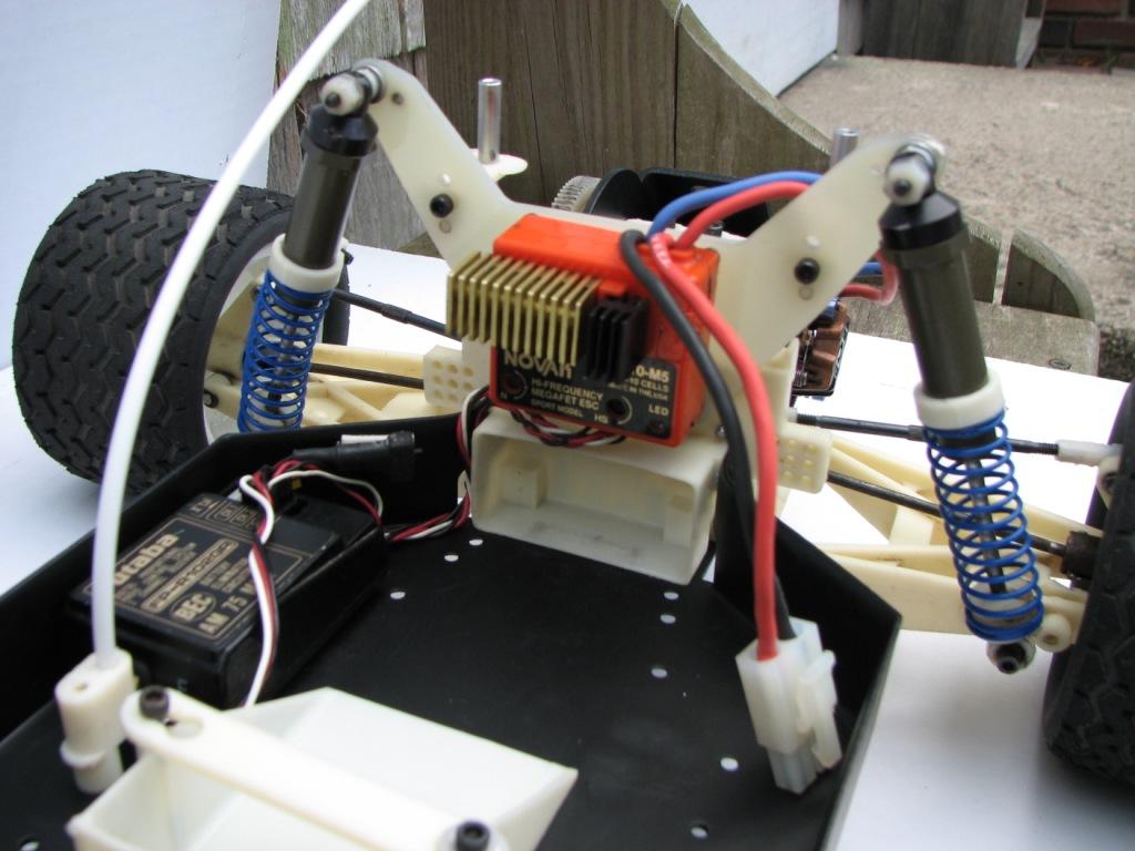

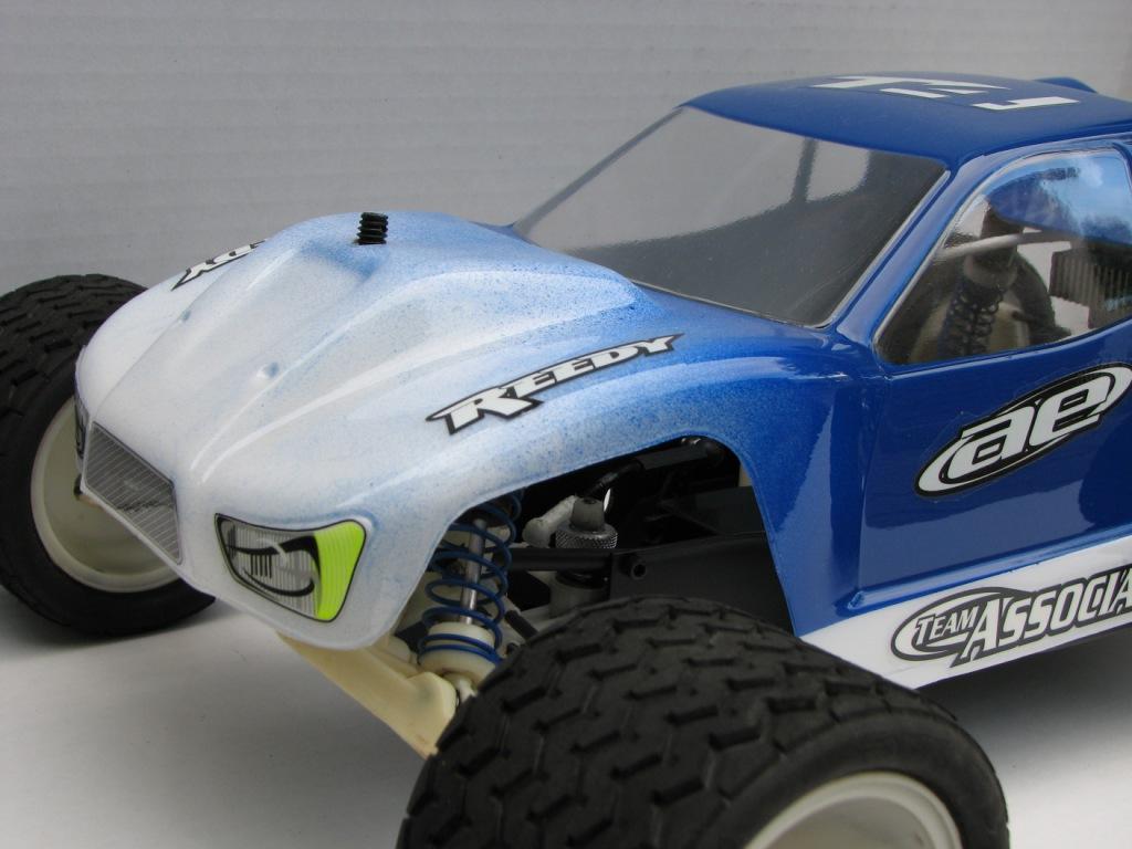

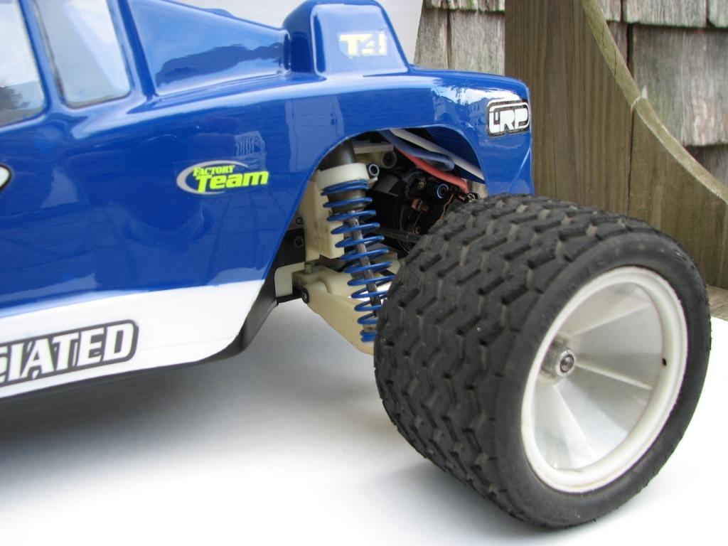

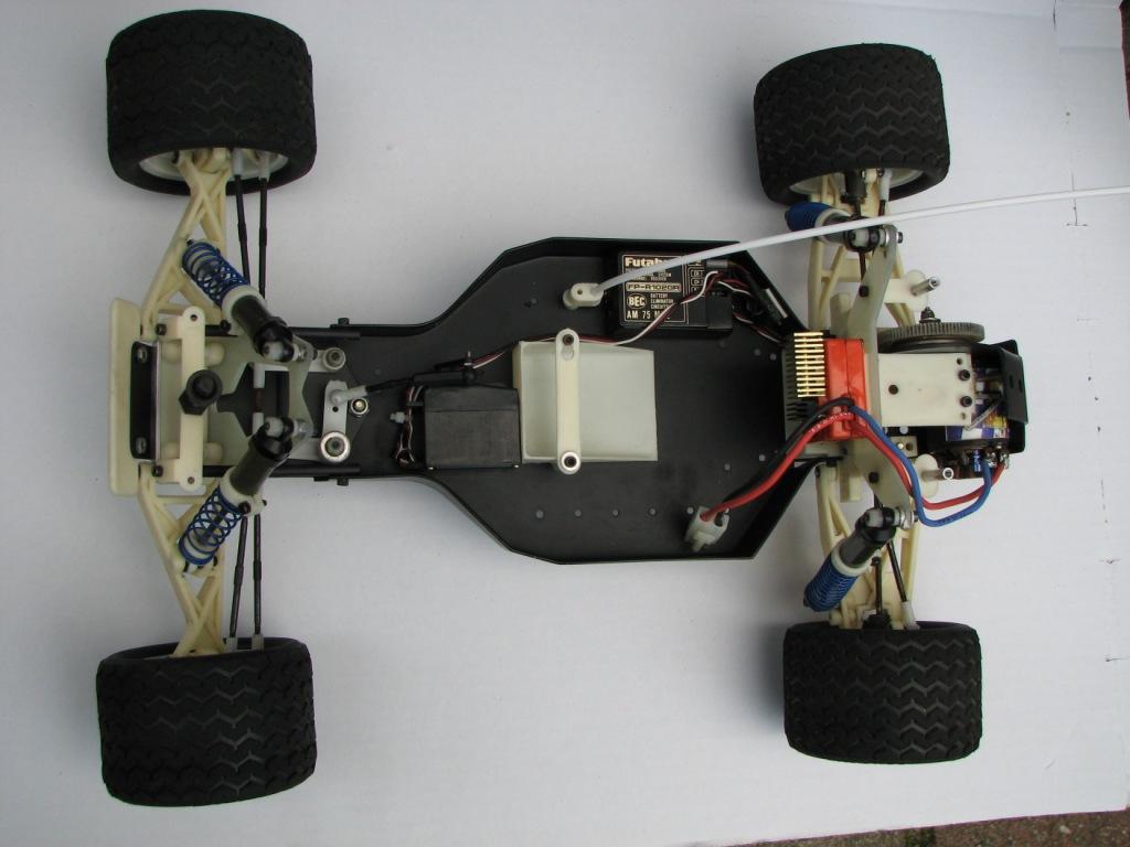

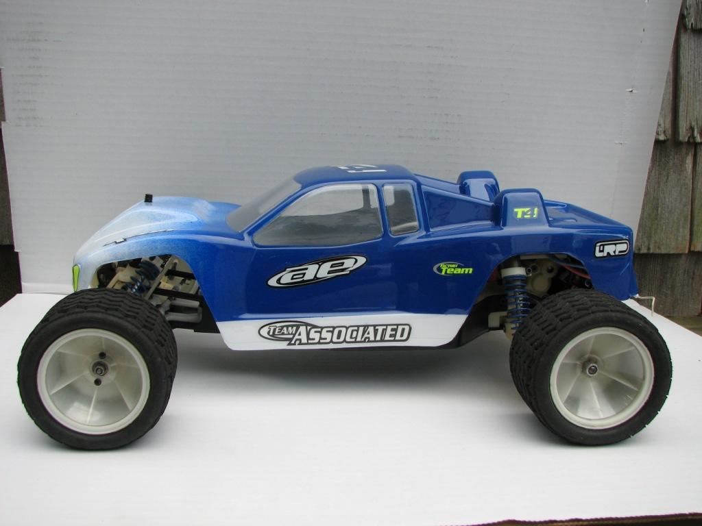

Now finished after a few mishaps my rc10t i still cant find a body or decals well for a reasonable price so i went with a t4 body. This looks nice but not what i want. Is this the team version with the hardened shocks??

It looks like a 7001 "Race Truck" (the first truck kit), note the two hole front and rear shock towers and lack of a graphite trans brace. The Losi wheels and Striker tires don't help.
I can't really tell 100% if the front arms have a single shock hole, but they appear to.

Two hole shock towers do not make it a Team Truck. The Team Truck got three hole front and four hole rear towers.reign79 wrote:Well i am a pan car guy so the tires are only natural and i have put the factory rims on the losi ones just didn't seem right. So help me out the two hole shock towers make it the team truck? I have the graphite tranny brace but was unsure of the version. Thanks for the info Ryan

Try a 10T2 body, it fits almost perfect, all you need to do is buy the rpm body mounts and mount the body post on the inside mounting holes.
I did it to my truck and it worked out great.

+1 on the T2 body. The T4 looks too T4 for me.....
Do not buy the "vintage" T2 bodies off ebay (unless they go cheap of course). You can still get them from Associated or anywhere that stocks their stuff.
