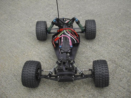

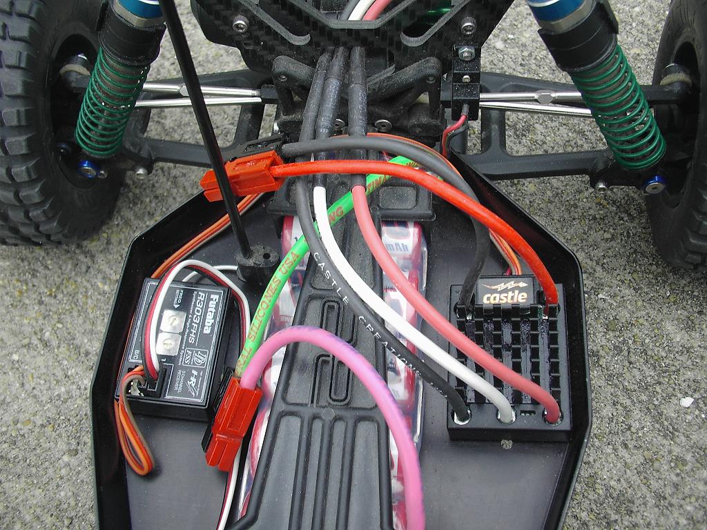

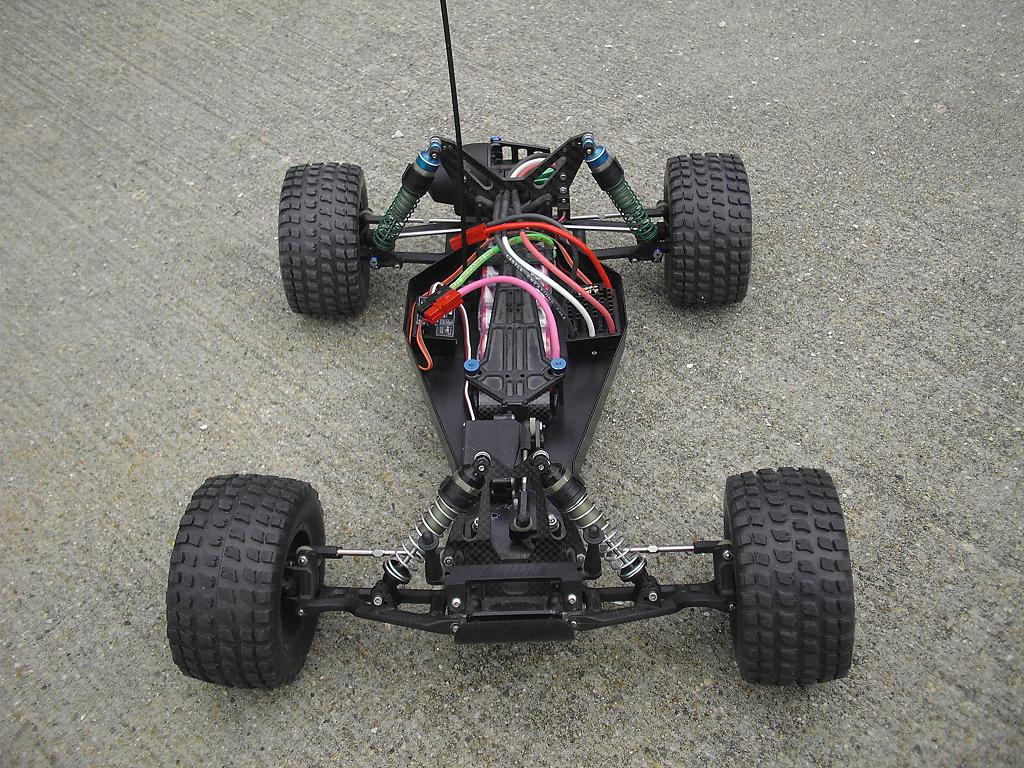

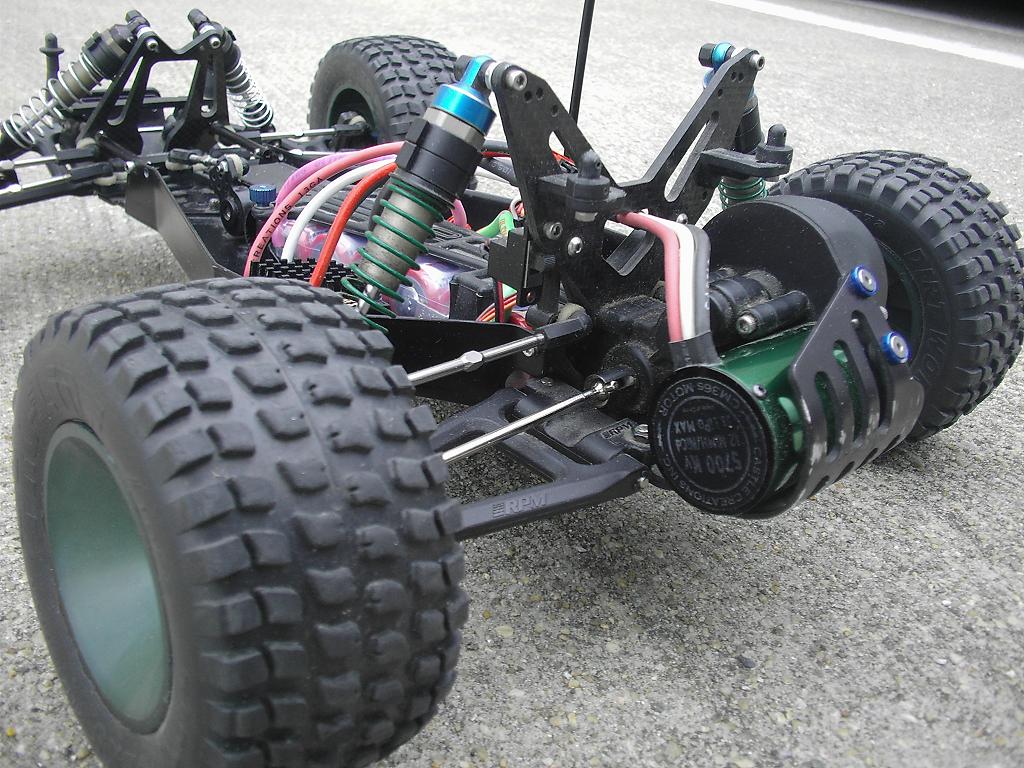

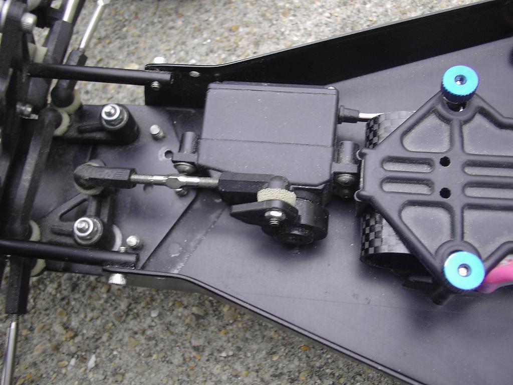

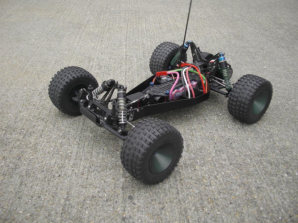

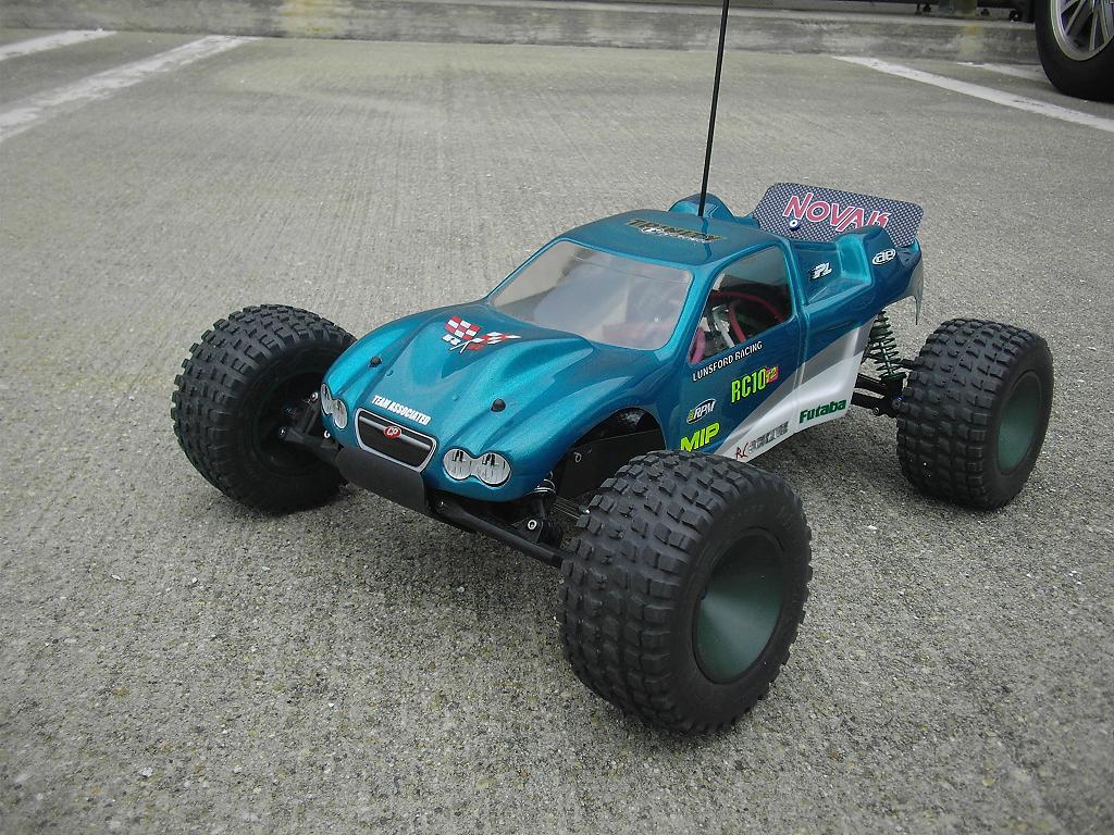

Hi everybody . This is my RC10T2 , i aways want it to owe a T2 in the mid 90'S but i was busy wasting my time and money on tamiya sedans . on the year 2000 i purchase a RC10GT and i was amaze with its performance but i always had the itch to have a electric stadium truck . at the beginning of the winter of 2007 i finally decide to go electric big time , first by buying a RC10T2 & second by getting a brushless system . i purchase this truck on ebay for $50 bucks and spend a few hundreds to take it to what it is now . i got pretty much all the RPM parts that were available for the T2 including some that were made for the RC10GT that also fit this truck to . i install the RRP metal gears inside the tranny to bombproof it from my CASTLE CREATIONS SIDEWINDER 5700KV . i got MIP shinny cvd's & ball bearing steering . my other electronics are the FUTABA 4PK radio and receiver ( my new receiver its 2.4ghz FAAST and its not shown on my pictures ) with a FUTABA high speed metal gears digital servo all working on HRS . i increase the wheel base by 1/2 inch by moving the front kick plate one hole forward and to increase the width i use the RC10GT front extended axles & RC10T4 rear cvd's axles tips with spacers , that will make the truck more stable and allows me to use T4 bodys . i got some videos of this truck on you tube . go to http://WWW.YOUTUBE.COM/PUNMAXXRCFX i hope you enjoy my pics . thanks !!!

nice ride though.
