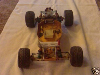

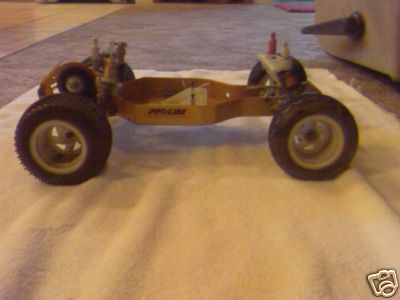

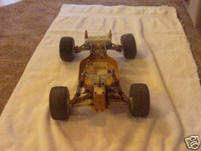

OK... I got this one off ebay a few weeks back. I think I pay to much for it. No... I know I pay to much for it. It was suppose to be some kind of truck conversion, RTR all you need is electronics. You know how it goes. Boy was I surprised. :shock: I mean each part on the car had something wrong with it. It literally had sheet metal screws holding it together. :evil: So I'm sitting here looking at this thing like what to do. Thinking to myself. Way did I buy it. :x Maybe I have the sickness. Or maybe it was the heat of the auction. Anyway I have to do something with it. To justify me buying it in the first place. So I turn to you guys and gal for a helping hand on what to do. Any suggestion would be highly appreciated. Thanks for taken the time to read this. And let me vent. :cry:

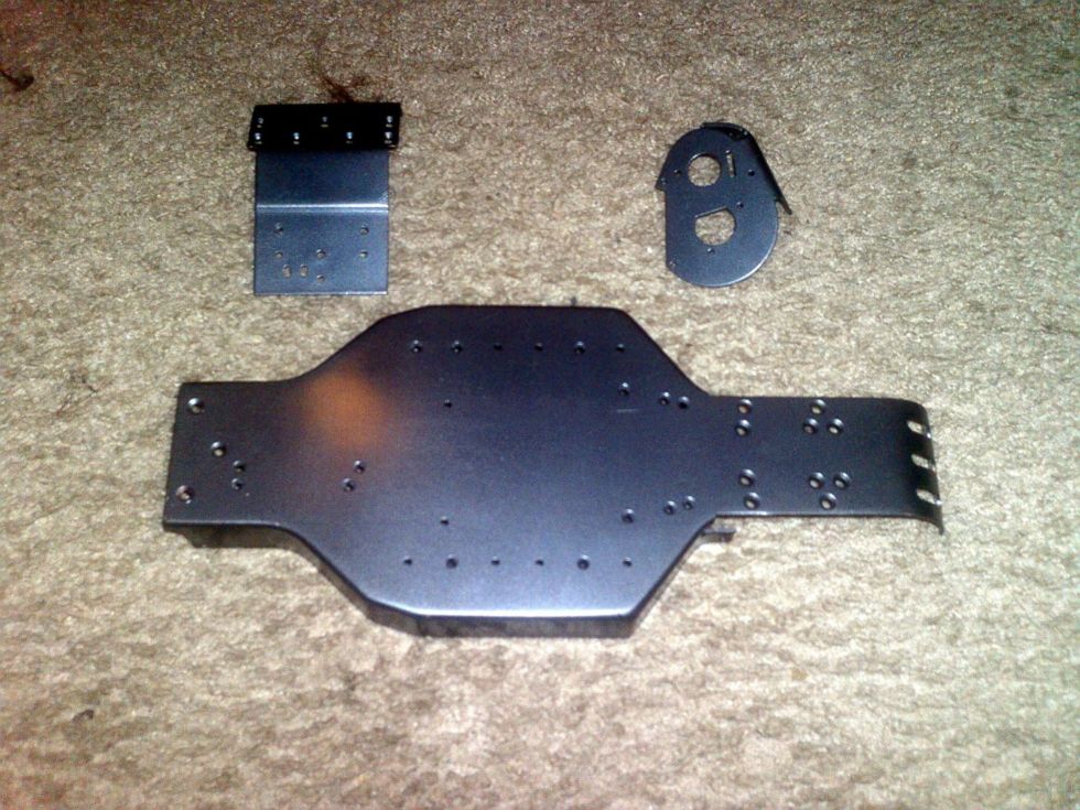

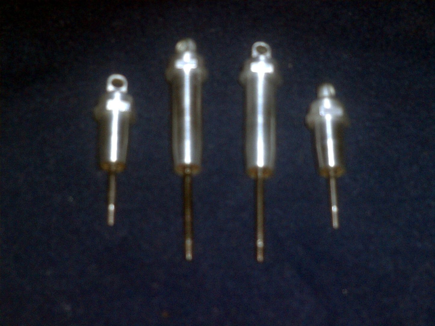

Easy-Off'd the shocks and went over them with some scotch-Brite pads. The chassis next. :twisted: I think I'll freshen it up with some paint. Don't want to spend anymore than I have to. Sorry for the pics need a new cam.
n33no
Posts: 138
Joined: Sat Jul 05, 2008 3:37 pm
Location: St. Louis MO
Re: Don't Know Were To Start
Post by n33no »

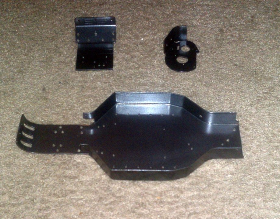

Done with the chassis. Sanded down the bottom to get out the scrathes and what not. Then I sprayed it with Dupli-Color Filler Primer. After some more sanding I painted it gun-metal gray using Dupli-Color auto spray. Then top it off with their clear coat. Turned out pretty good.:D Next step will be all my white parts. I think I'm going to dye them black.
