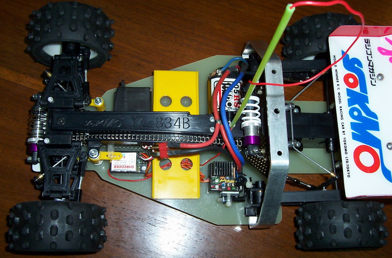

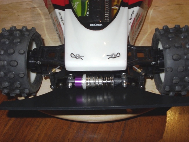

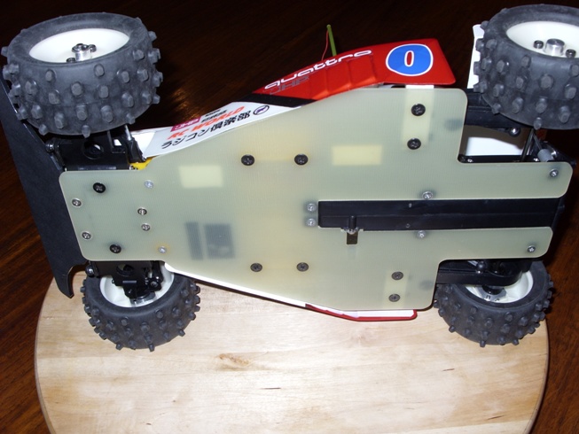

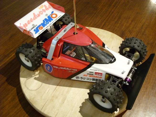

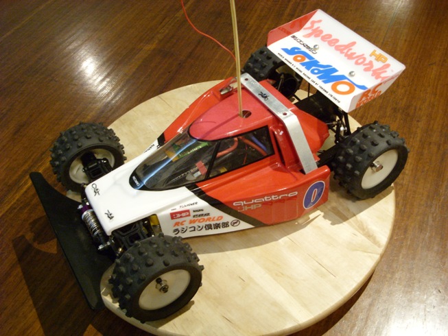

Well, this is my fully modified runner. well, not 'soooo' modified :D What I did was to retain the original suspension concept with minor modification of the geometry (unlike a conversion of 2 shocks to 3 shocks like the RPS, or 4 shocks, etc..). The original suspension did not work at all, mainly the Kydex chassis was way soft and the suspension pivots flex horribly. Not to forget the original shocks leak more oil than I put into it. :twisted: With some improvement in material, carbon fiber and FRP upgrades, the suspesion actually works quite well!! Soft tires also help the suspension too. But I never dare to jump this car, too precious :mrgreen:
Bottom up.
Bottom up.
Side view.
Side view.
Another side view.
Another side view.

This one has:
FRP chassis, RC10 wing, front lower alloy arms (not in picture), carbon fiber suspension pivots at all corners, custom front and rear roll bars, HPI threaded shocks, modified tamiya F201 rear suspension pivot, Yokomo 05RS turbo motor (flat can lik Trinity midnight), mini bumper, yokomo turnbuckles for the rear suspension rods, carbon fiber rear suspension mount, graphite motor mount, lowered battery mounting bracket (5mm), new yokomo wheels, duratrax tires...
Drives like a dream.

One thing I was astonished: the number of ball bearings. More than 20 for such a small car....

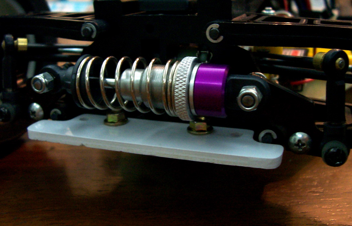

Here are the close up of the suspension modification.

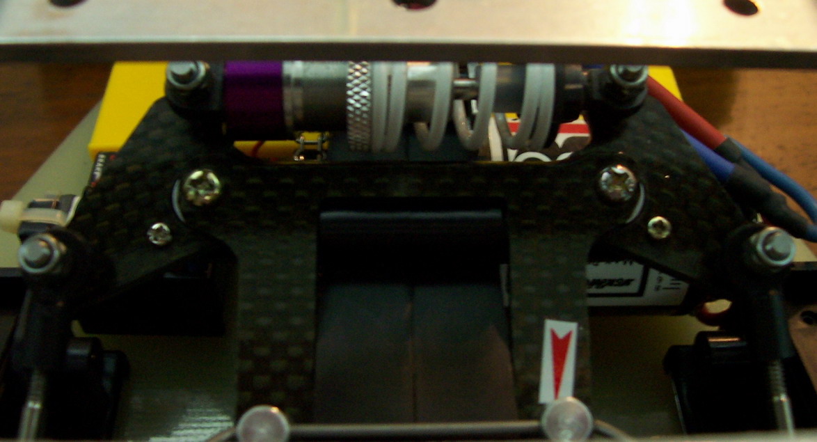

Front suspension with custom roll bar. Lower arms showed as original but in fact it is now made of aluminium, hot trick type but in black color. 3mm corlite graphite material added for the suspension mount.

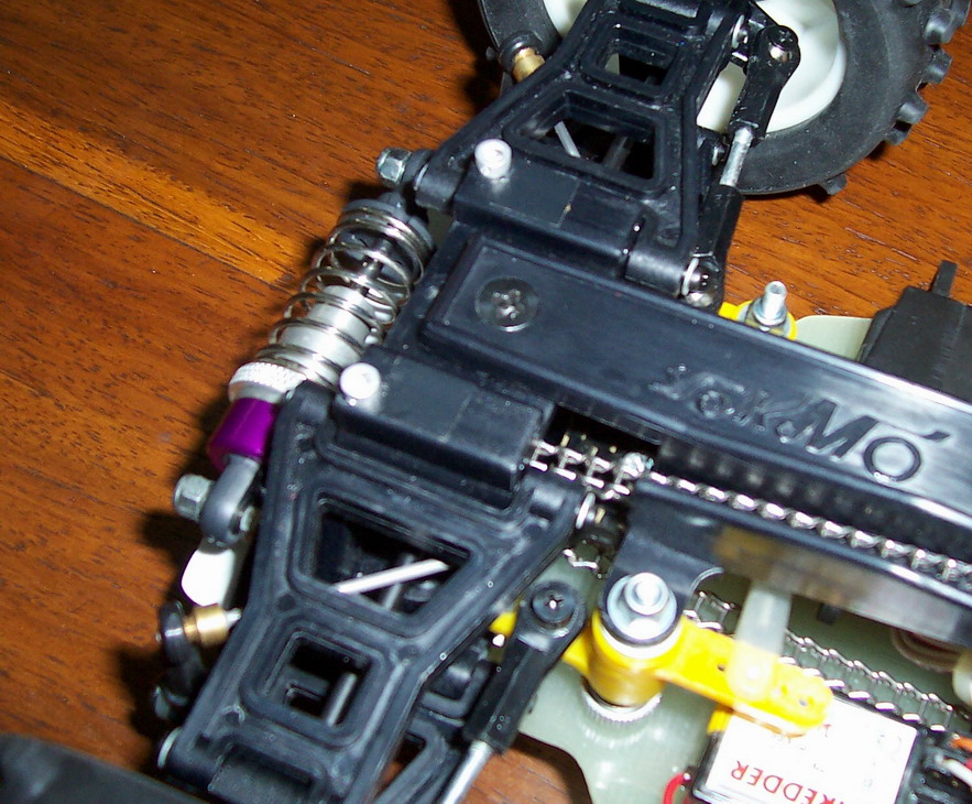

Rear suspension reinforced with 3mm Corlite custom brackets, modified Tamiya F201 pivot rocker arm, HPI shock, Ti Turnbuckles + AE and Losi cup, picture a bit dark, excuse my photo technique. :)

Nice looking car. Can I get some more pictures of how the front sway bar attaches?
Cheers

This is a front view of the roll bar, hope this help, I know it is very dark but I am no good with camera :roll:
Another close up of the roll-bar.
Front view, I am no good with camera....
