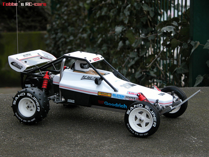

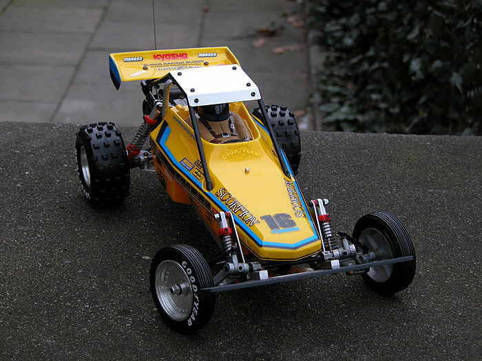

Hi Eau Rouge
The differences are not many: The decals and the box as far as I know. The chassies is the same, at least on the earlier versions. In Europe, the Scorpion was released by Graupner and the latest "normal-Scorpion" came with the white 5-spoke TS-rims, red frictionshocks and differential (some also had the 3-hole rear dampermount) and I don´t know if those upgrades also were on the later Cox-versions, the earlier version is practically the same though:) Other small differences (at least on the later Graupner-versions) are the small "lips" on the rear plates that holds the suspensionarms to prevent the dogbones from falling out since without them, the rearaxle tended to get pushed down too far. Also, the front pivot-arm were the same as on the Tomahawk and the TS (a little more robust). These are also small things that I am not sure about, if they also were seen on the Cox-versions. Hope this helped You out at least a little
/Tobbe
/Tobbe
