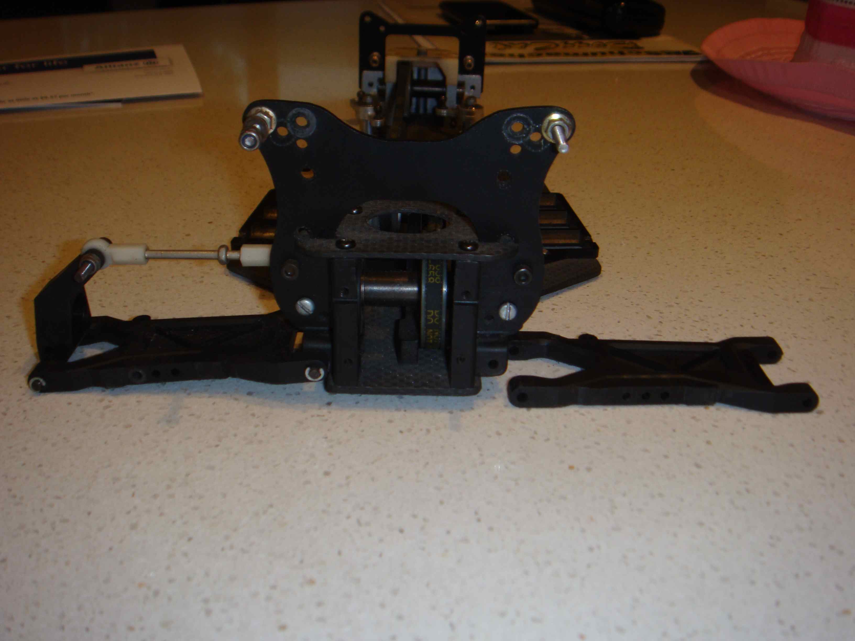

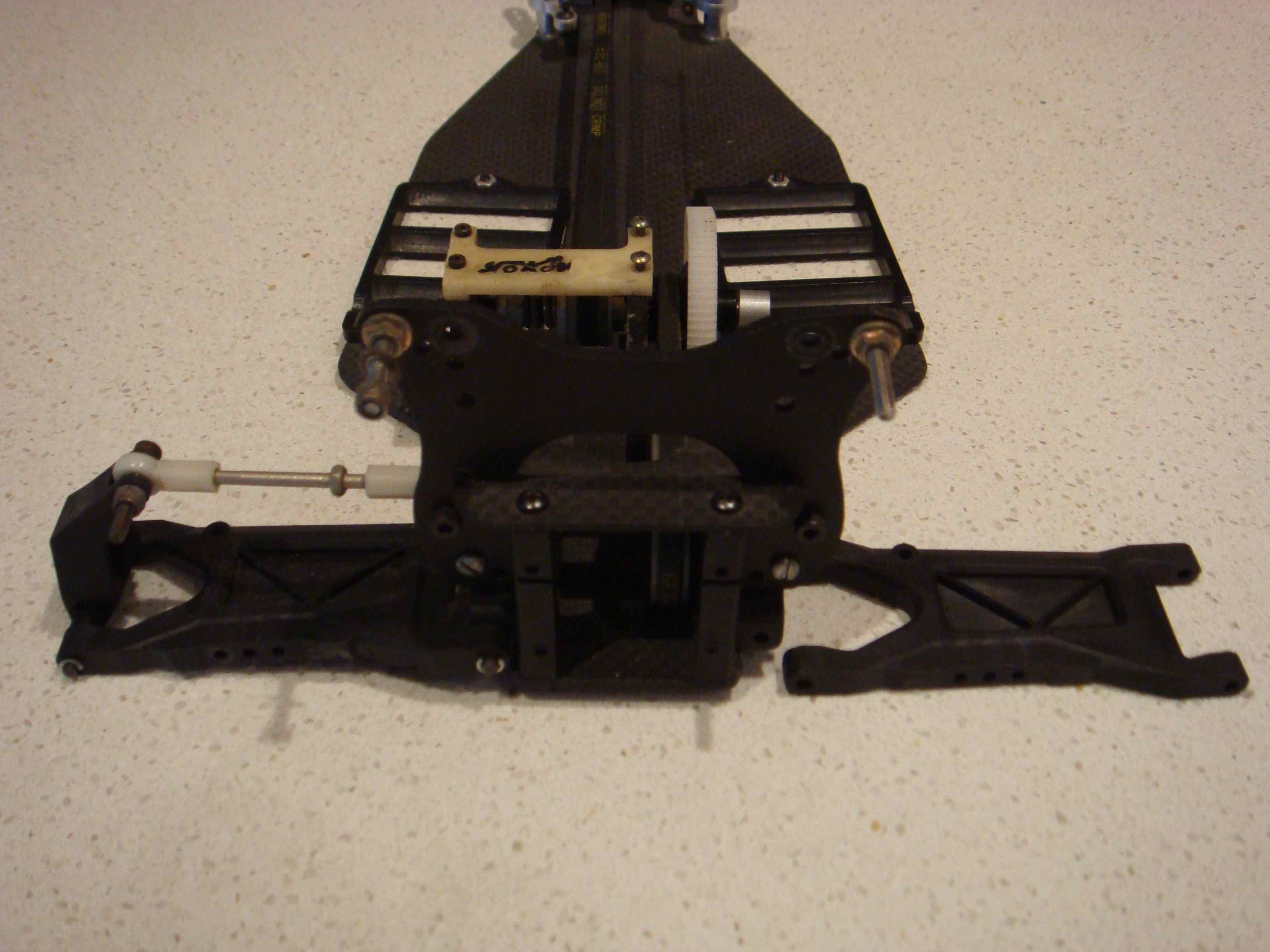

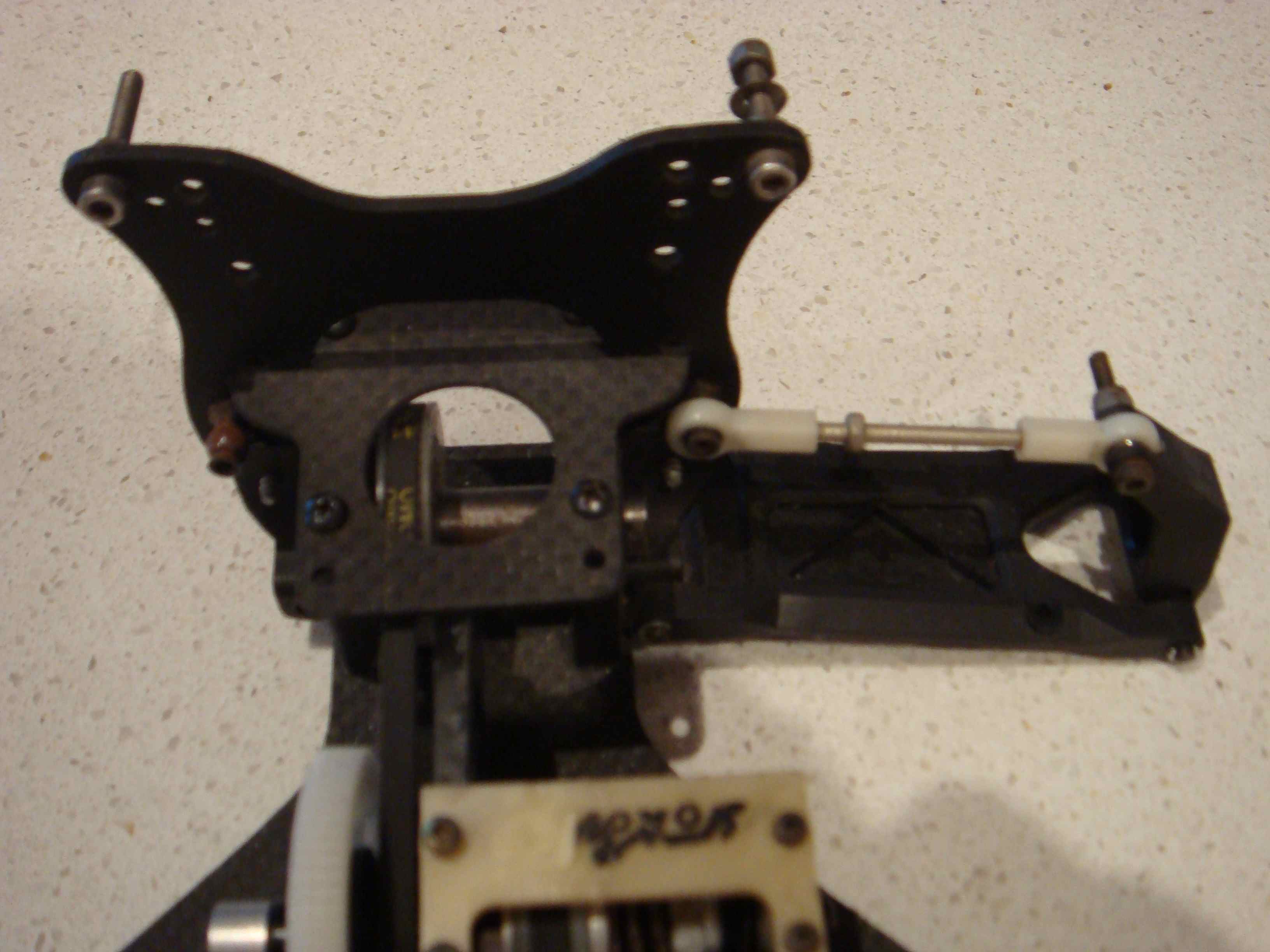

So now I have an 870c (Japan/Euro version) I would like to run 2.2 inch rims, I also have a set of rear arms and only one hub as pictured.
Are these 91 Works rear arms? And is this a RPM diff set up?
What needs to be done to the 870c to accept the 2.2 inch rims?

don't pin me down on this, but from what I remember from other posts on this forum it looks like you have a corally chassis, the arms are works 91 (so it's not an 870C actually). I don't think the bulkhead is RPM (if it is it would have RPM 's logo on it).
The magnesium (if it is magnesium: they changed to aother castin material later I think) was famous for dulling straight away in contact with air
buff it, clear-coat, don't run it: motorheat may crack the coating.
2.2 inch wheels with the narrow offset should be a straight fit on those arms. Make sure you get the correct length U_J's for the front and rear, and correct hubs too: all are different from the 870C versions.

The A-arms pictured in this post are Works '91/93 arms. The rear bulkhead looks very similar to the RPM version but uses a different "bulkhead cap". I don't think that chassis was made by Corally but I can't be sure.

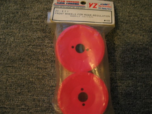

hi scott, i have these buddy they have the blue rubber bands in the pack

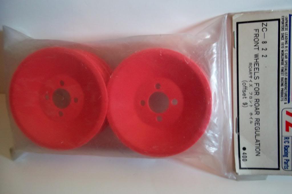

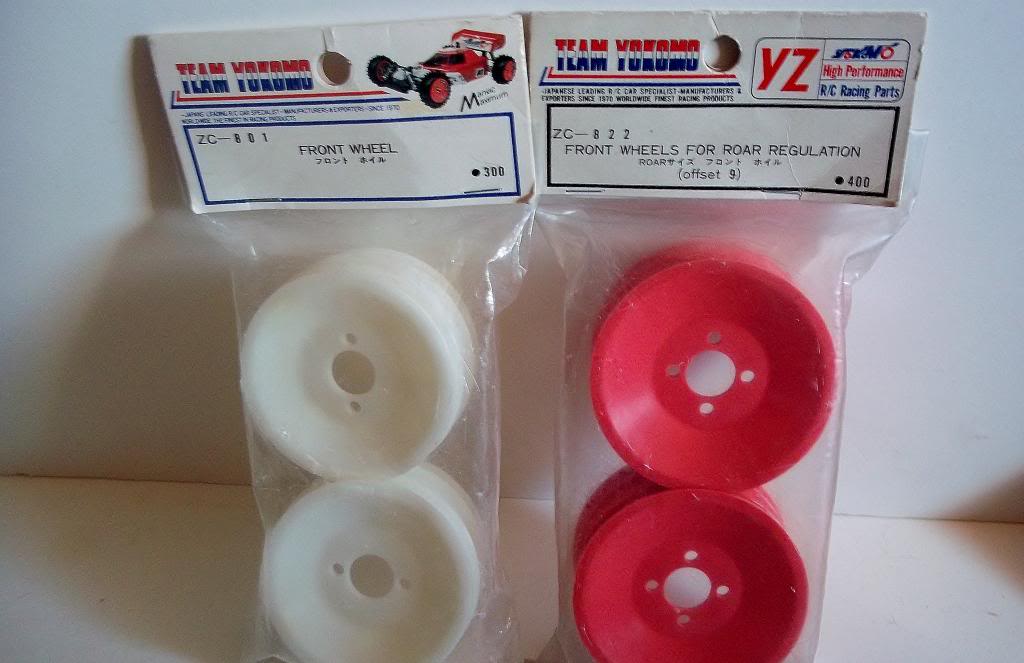

Old Problem, but ZC-822 Front Wheels solves the front problem you are having.
