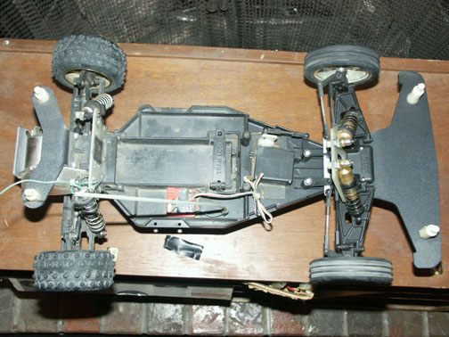

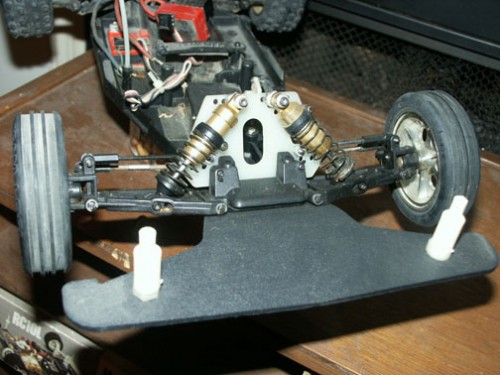

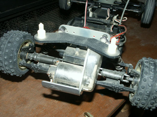

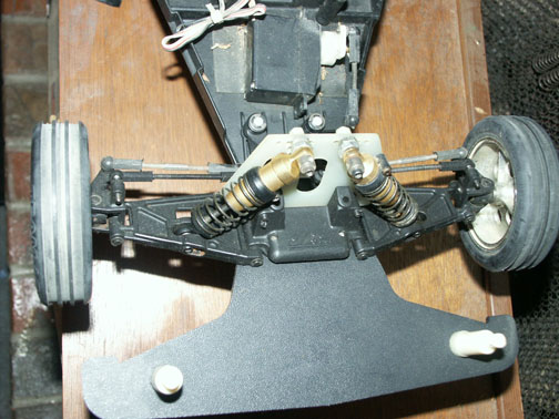

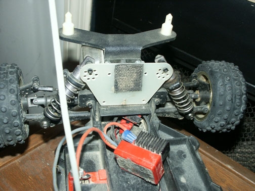

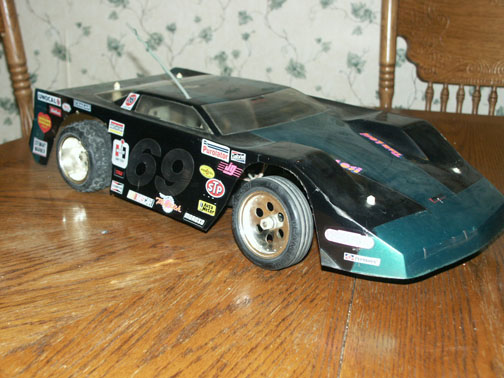

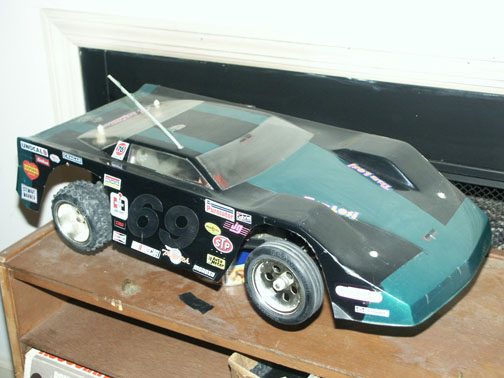

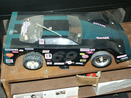

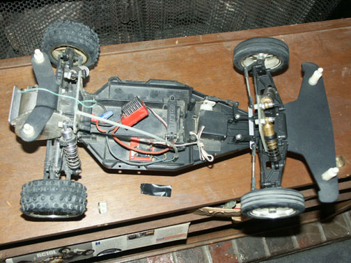

here are a few quick pics of my car, remember its been up in my attic for about
15 or so years , i know i have to clean it..lol
i never got to race this either i ran it a few around the house.
if anyone could give me any info on parts that are available that would fit so i could
go run some dirt oval i would be very thankful.

Re: new guy with junior 2
Wow that looks to be in great condition for its age! Very nice looking oval racer.
thanks, so let me see, your calling me old...lol
the pictures really doesnt do it justice, it's not as dirty/ dusty as the pics
make it look like. the shocks need to be rebuilt or replaced.
i just realized you been in it for 20 years...
Looks great, just put a couple screws in the lower holes for the rear shock tower, and install a chassis brace up front and you are good to go.
k, can you please tell me what you meant buy a chassis brace in the front?
remember i havent been in the sport for over 20 years.
- Posts: 1999
- Location: Upstate NY
- Been thanked: 12 times
Losi part # a-4047 molded chassis brace. it is #18 in figure 16 of the manual: http://www.vintagelosi.com/Manuals_files/Junior2.pdf It is page "8" of the print manual, but on p 11/36 of the pdf.bhamptn wrote:k, can you please tell me what you meant buy a chassis brace in the front?
Without that there a front end impact is much more likely to crack the chassis plate.
oh ok , i just got the brace out and looked at it but with the other plate for the shocks on the front the brace will not go on un less i put the original tower back on
then the body would not fit
ok guys, after going over and checking things closer tonight i have decided to rebuild the shocks and put the original tower on the front so i can put the brace on.
question? are there shocks available that i can walk in my hobby shop and buy and/or a rebuild kit? 2 of the collar are broke and no compression.
thanks in advance
thanks in advance
Yes, Losi still makes the spring clamps and retainers new. The cartridges are now a shorter 2 o-ring design that works perfectly with the older shocks as well. The golds in the front of your ride will probably need a metric 3mm oring to rebuild. (not entirely sure on that one) Then again, the RC10 orings may work too. Your LHS ought to have everything you need.
Oh, and Duratrax makes 2.2" wheels for their BX buggy that have the correct offset for the old X2... Front and rear both fit.
