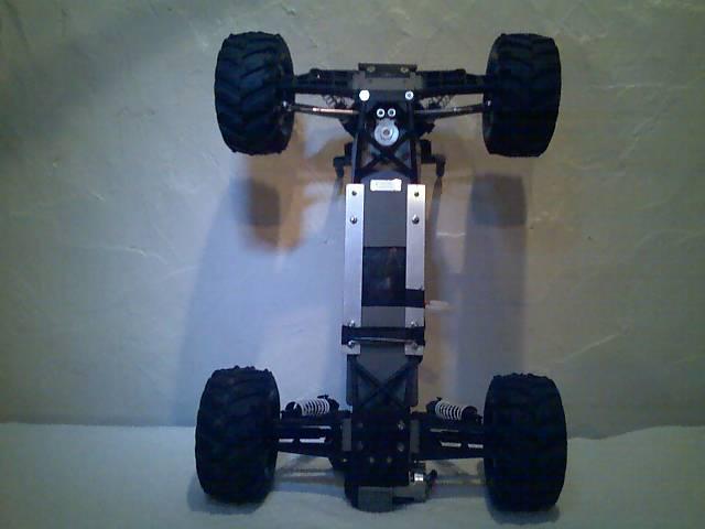

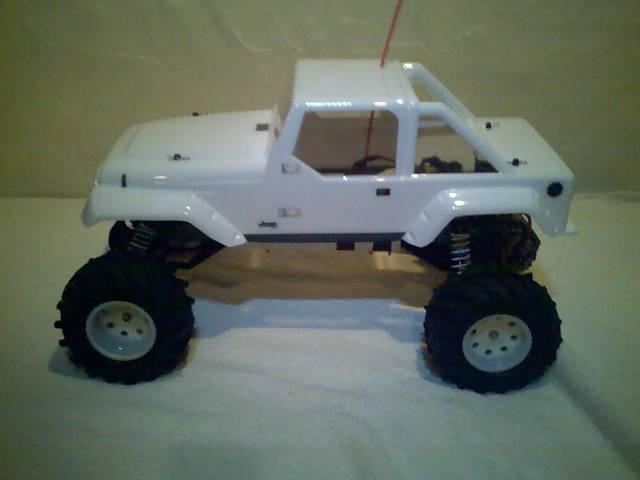

id like to see someone to extend the chassis on an rc10t and put an sc8 body on there .i extended the chassis on my stampede and run an hpi jeep (think 1/8th scale)body. it handles much better now
