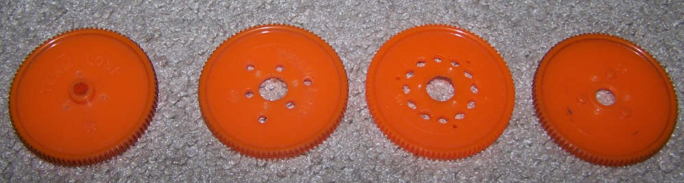

You might be able to use a losi spur on that slipper clutch. For the JR series, losi actually had 3 styles of spur gears.
I began using an A&L slipper but I wanted to use the stock losi spurs (profiled). At the time, losi only had the original design and it didn't work with the A&L. I asked a local guy to modify some stock losi spurs so I could use them with the slipper. They were great!!! A couple years later, losi came out with their own version which I wound up using since they were easily available.
First - Original style
Second - Original style modified for the slipper
Third - Losi spur that you might be able to use for the TPS
Fourth - Used on the pro SE
So if you can find the 3rd spur, it may work for you. Losi made all sizes with this design:
82 - Yellow
84 - Purple
86 - Red (size for the buggies)
88 - Green
90 - Orange (size used for the truck)
92 - Blue
Good luck...
