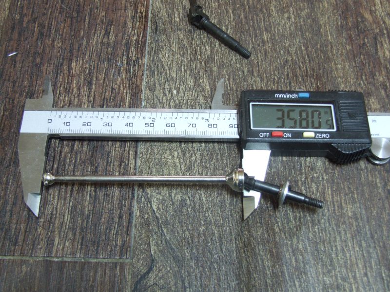

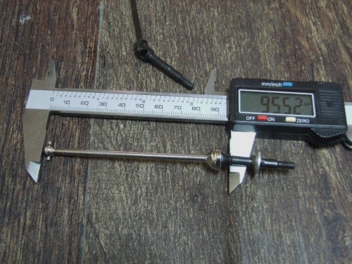

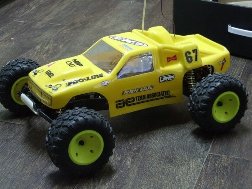

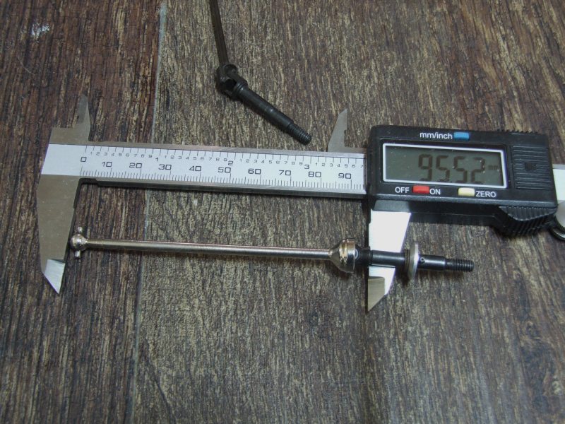

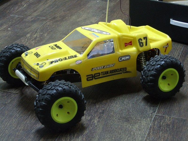

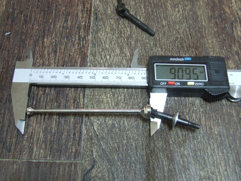

I'm running my T2 with some T4 parts. the wheels are proline velocity for T2/T3. is it same one for T4 :?:
but, I cannot remember where I took the bones from. anyway, the bones are slightly longer than stock T2's.
and, this T2 has same treads with T4.
and, 1/4" axles + 1/4"x3/8" bearings + T4 rear hubs work fine with RC10T wheels
thanks for the rear wheels to a01butal :wink:

vintage AE
Posts: 3012
Has thanked: 29 times
Been thanked: 36 times
Re: RC10 vintage buggy chassis to modern Truck conversion
Post by vintage AE »
That looks good, I like it. Do you think 10T arms attached to a graphite chassis with a stealth tranny will work with the T4 hub/CVDs/wheel combo? I don't know if the distance between the tranny and the hubs are the same with your T2 as it would be with the setup I'm thinking of using.
59burst
Posts: 1011
Joined: Sat Jul 26, 2008 9:52 am
Location: Bothell, WA
Post by 59burst »
I need to check the length of the bones. then I'll update

Post by 59burst »
check the length of the CVD bone. it was measured in metric and inch both

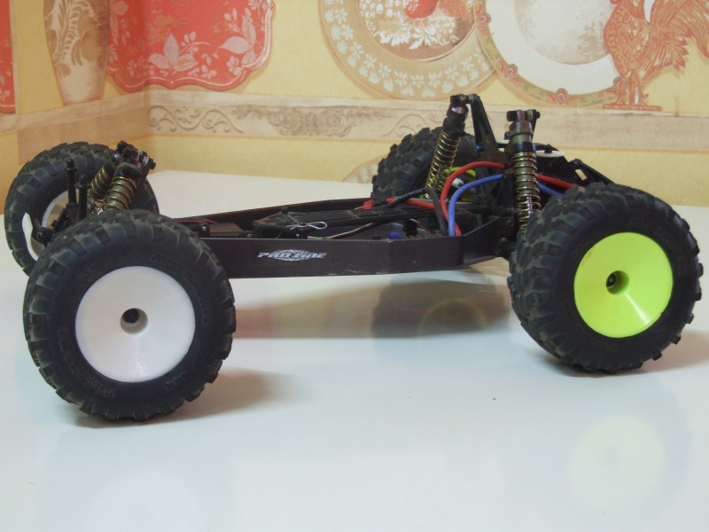

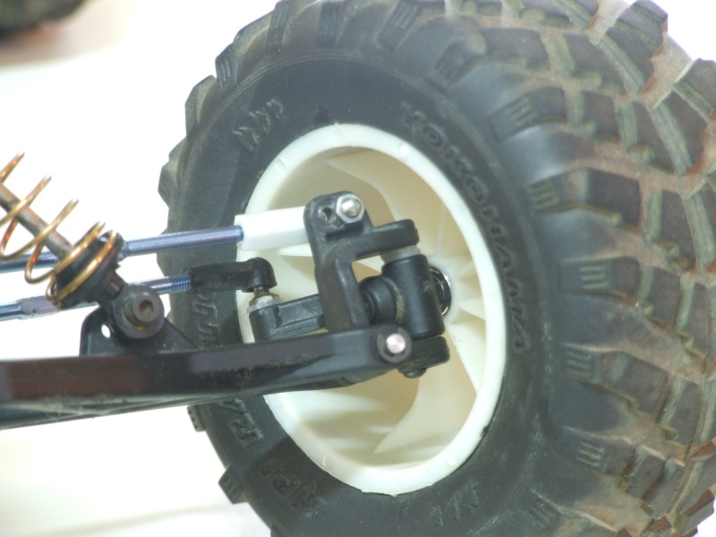

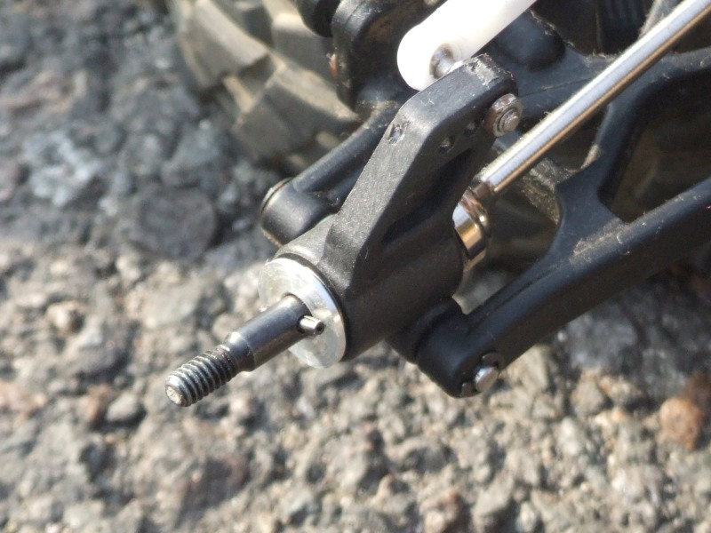

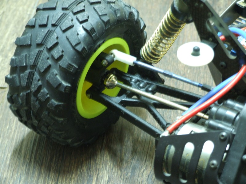

torrnado_firemagikk wrote:i have a converted rc 10 to a rc10t, i used t3 axles on the rear and they have worked fine, in fact i have a "hines 57" rc10 t
I ended up finding the right combo for me...it's kind of a hines 57 too with t2 CVDs joined to modern quick connects on a TQ graphite chassis :twisted: I had to modify the front end a lot with a rotary tool to fit a 10T front end on, and then a A&L tall shock tower so I could convert it back into a buggy again :lol: :lol: :lol: . Think of it as a 1/8 scale RC10.
Here is a link to the build http://www.rc10talk.com/viewtopic.php?f=36&t=10162

I ended up using the Rc10T CVD bones and the new quick connects for the T4. Works absolutely awesome!!!
