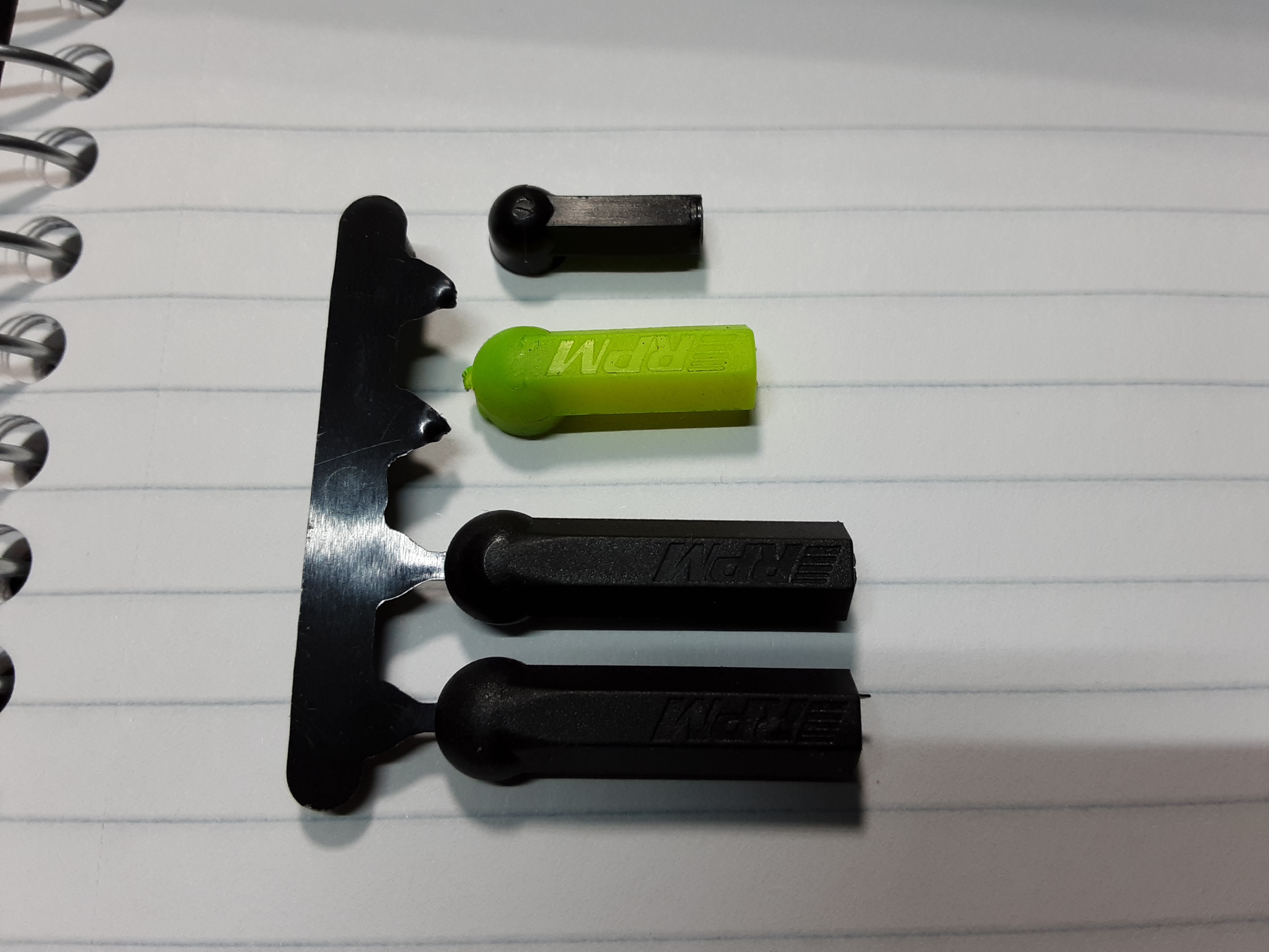

Re: Do I need different tired lengths with the rpm long cups
This is all three sizes.
The AE 6274 cups are 16mm OAL, 6mm wide, and have 9mm thread depth. These were recently discontinued but can still be found.
The standard RPM cup is 20mm OAL, 7.5mm wide, and have 13mm thread depth.
The long RPM cup is 26mm OAL, 7.5mm wide, and have 19mm thread depth. They also have additional clearance on the bottom for travel.
associated also made the low friction versions, which are narrow like the ones shown, with a longer shank:
https://www.michaelsrchobbies.com/team-associated-asc7499-low-friction-ball-cups-b4.html
