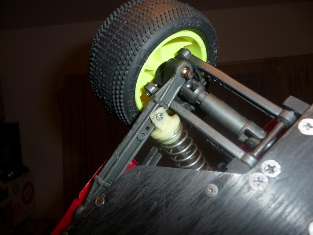

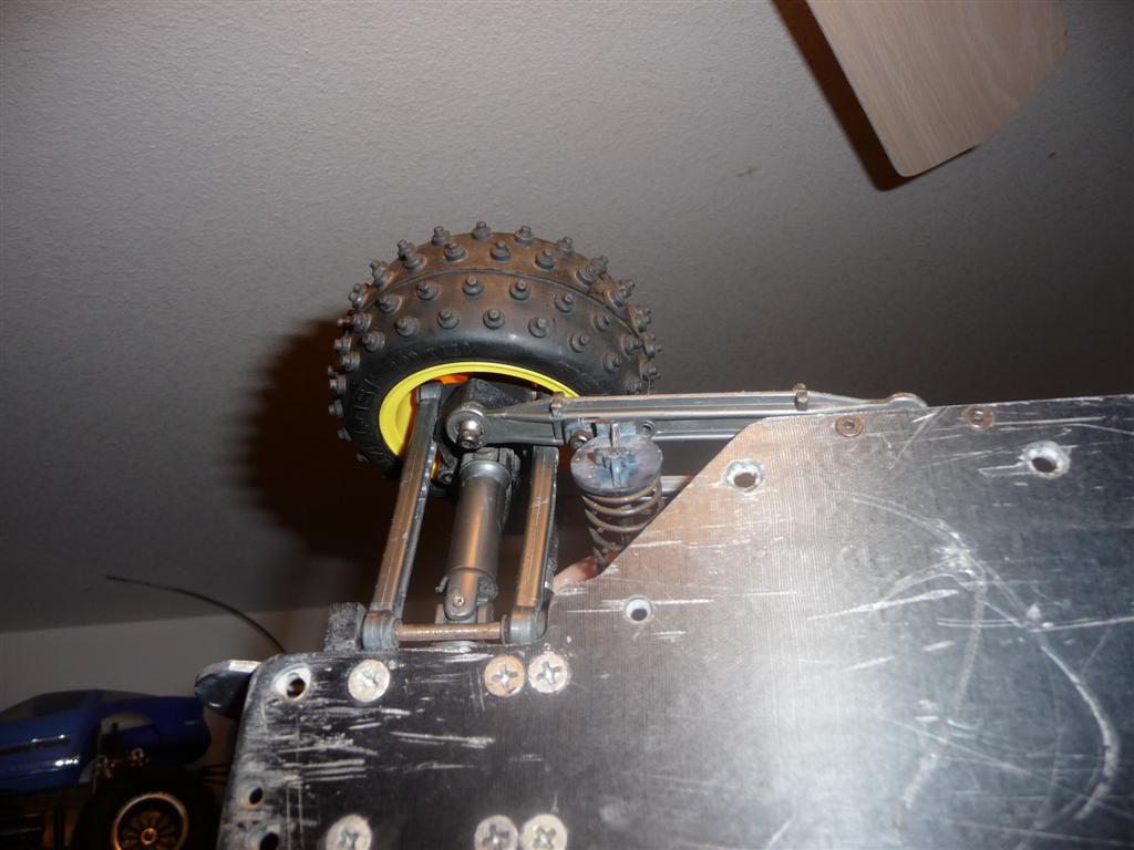

So I bought a couple of well used JRX2's and both of them have some issues with the lower rear shock ends. One is just broken and the other one has an oddball, possibly home made end. What do I look for to replace these? Are there any aftermarket pars available? These are apparently the week link (no pun intended :P ) on these 5-link suspensions.

I do not know of any aftermarket lower rear shock ends, I wish there were some made out of aluminum or delrin. The stock ones always seem to crack along the mold lines or just snap off.

for anyone that plans on racing with a 5 link, i would suggest having someone (dynotech, etc.) make them out of delrin or aluminum. ya, they might cost you a decent amount to get them done, but it's not like the originals are that easy to find....... or all that cheap when you do.

Thanks for the info guys. I suspected as much. aluminum would be cool! 8)
