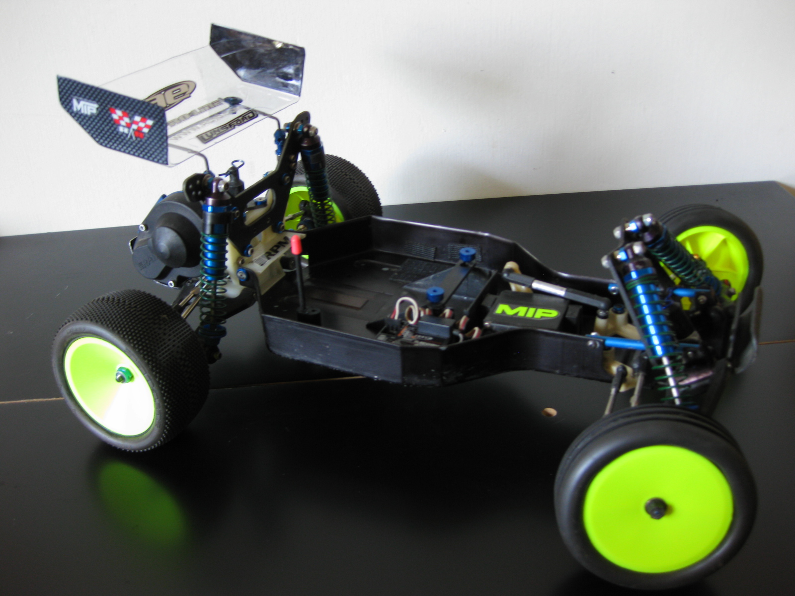

this is what happens when creativity meets a bunch misc parts laying around........

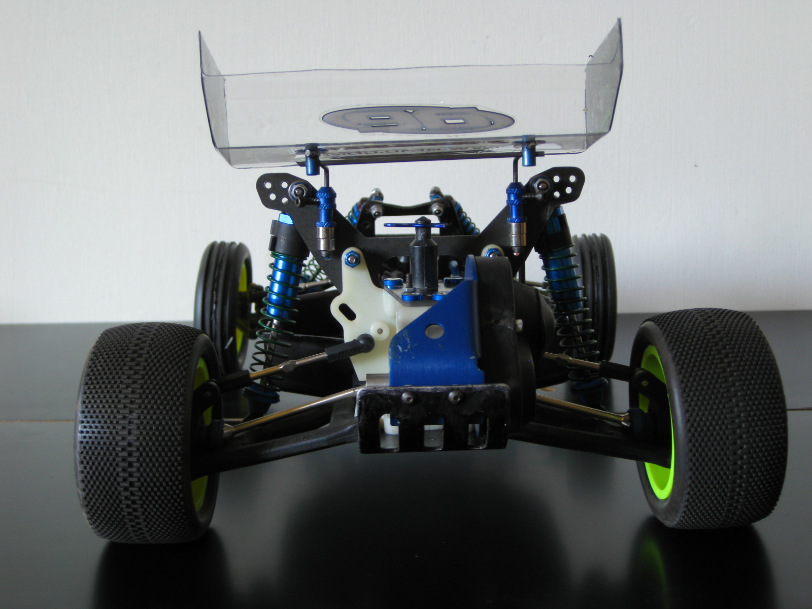

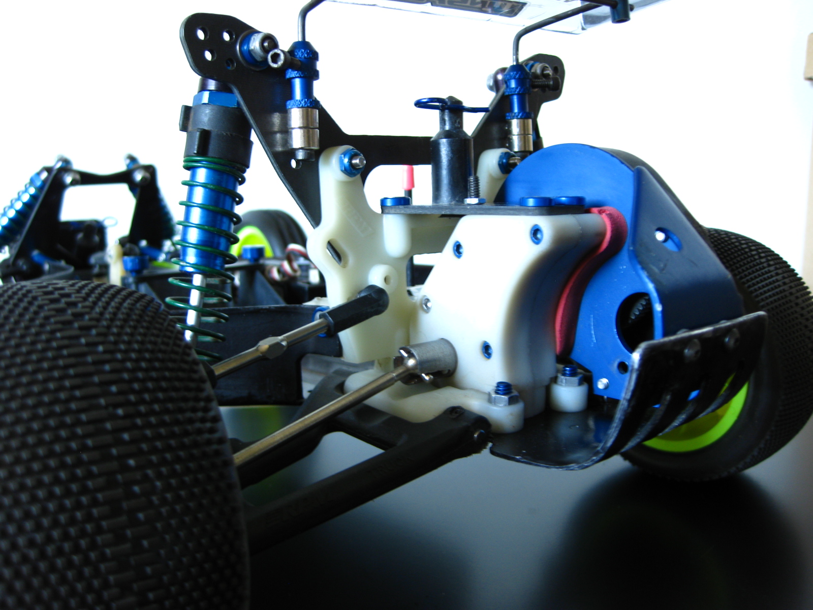

it all started with a worlds chassis that had been narrowed "not by me"
-in the rear
old rpm truck arms "pre 10t"
b4 cvds
rpm worlds inner arm mounts
rpm big bearing carriers
rpm 2.6 truck trans
rpm 10t bulkhead
composite craft 10T rear tower
1.32 shocks

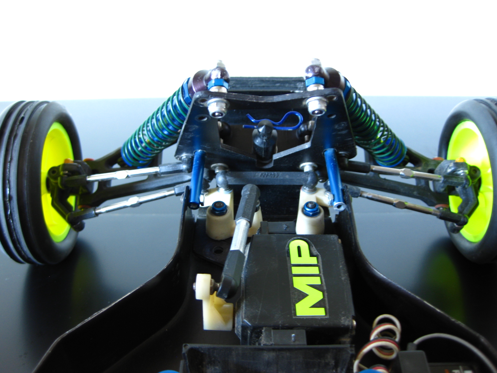

-in the front
white mip steering....ooohhhlalala
10t truck nose plate
10t front bulkhead-- modified to fit arms
10t blue nosetubes shortened
rpm rc10b3 front arms
rpm worlds front shock tower
1.32 shocks "yes rears up front!!"
rc10b4 FT spidles and carirers w/ trailing axles
so how does it drive??
AWSOME!!!! this thing soaks up everything... and since its super wide its uber stable...its a blast to drive..
- with b3 wheels its F/R track width is a bit wider than a b4.
_ Ive got about 15 hours logged on it now, time to put it on the shelf before i wear out all the parts!!!

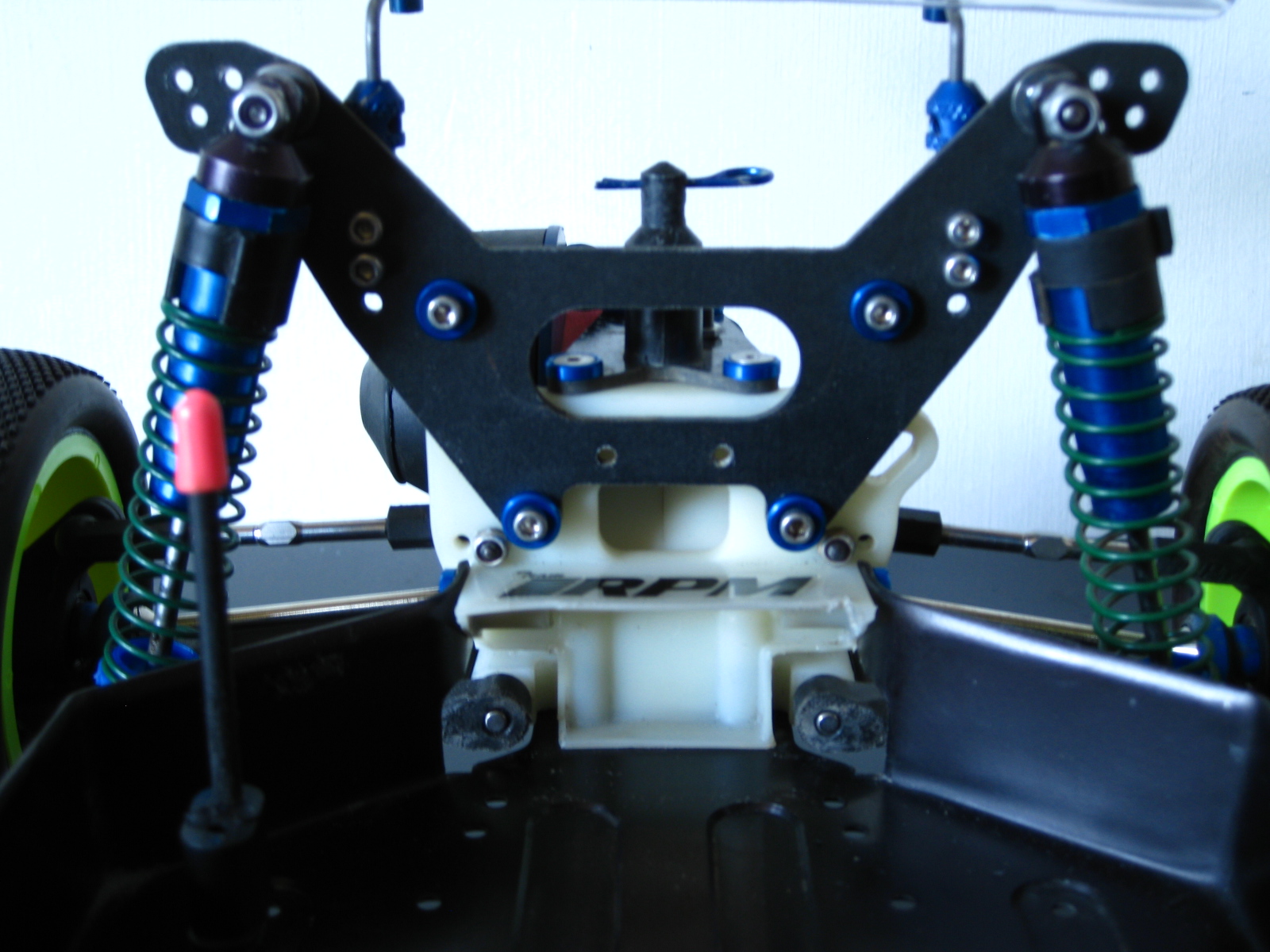

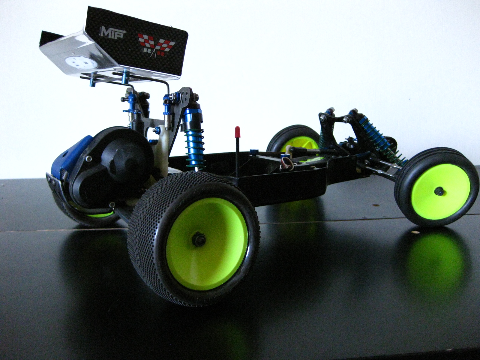

-in the rear
b4 cvds
rpm 2.6 truck trans
rpm 10t bulkhead
1.32 shocks

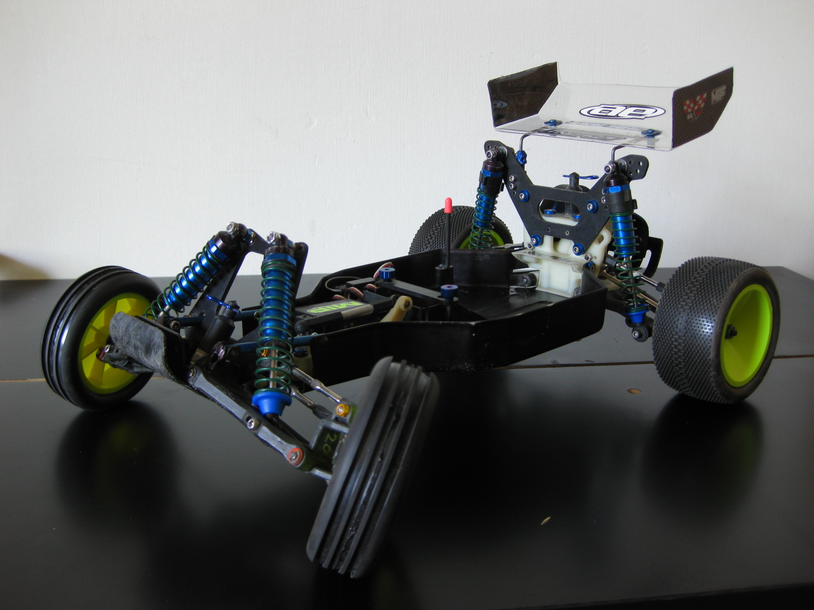

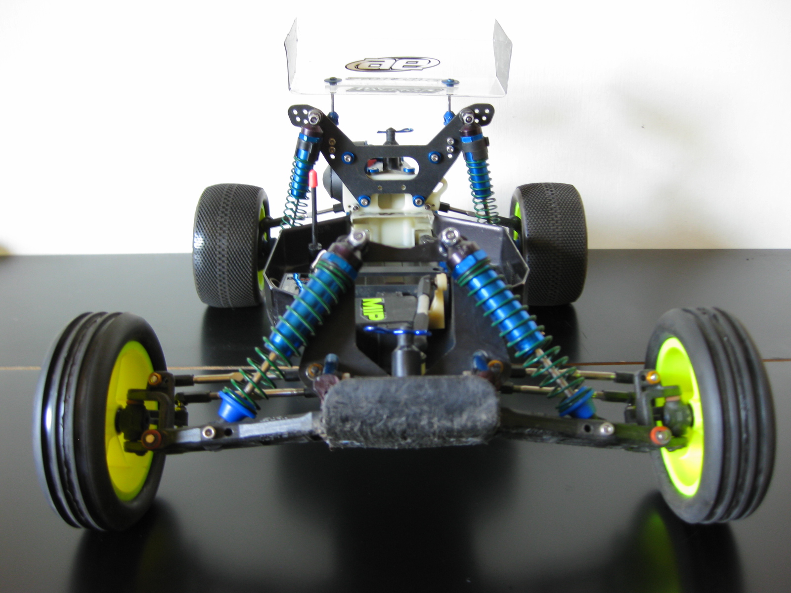

-in the front

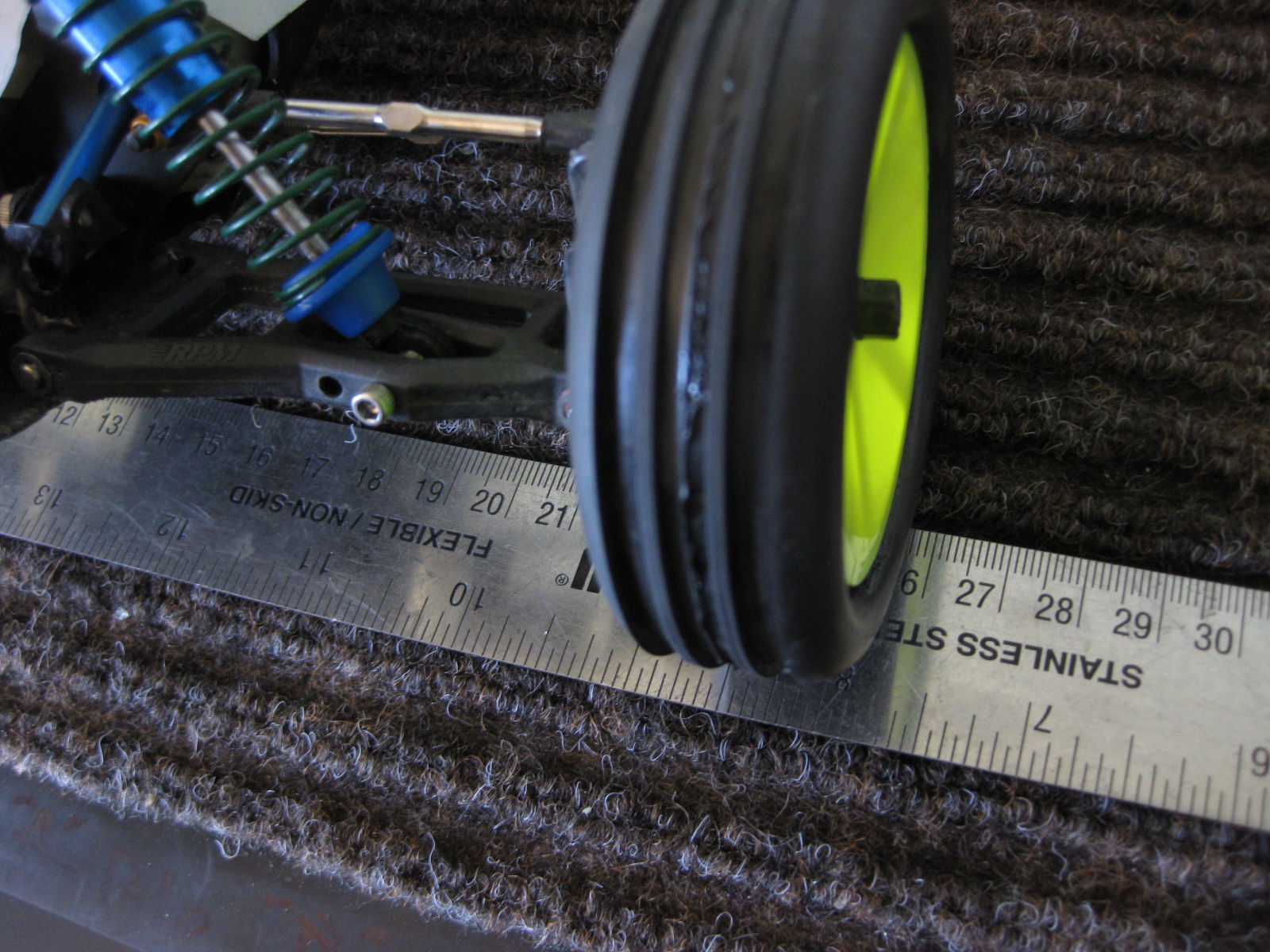

the arms on it are 3/16 longer than rpm worlds........

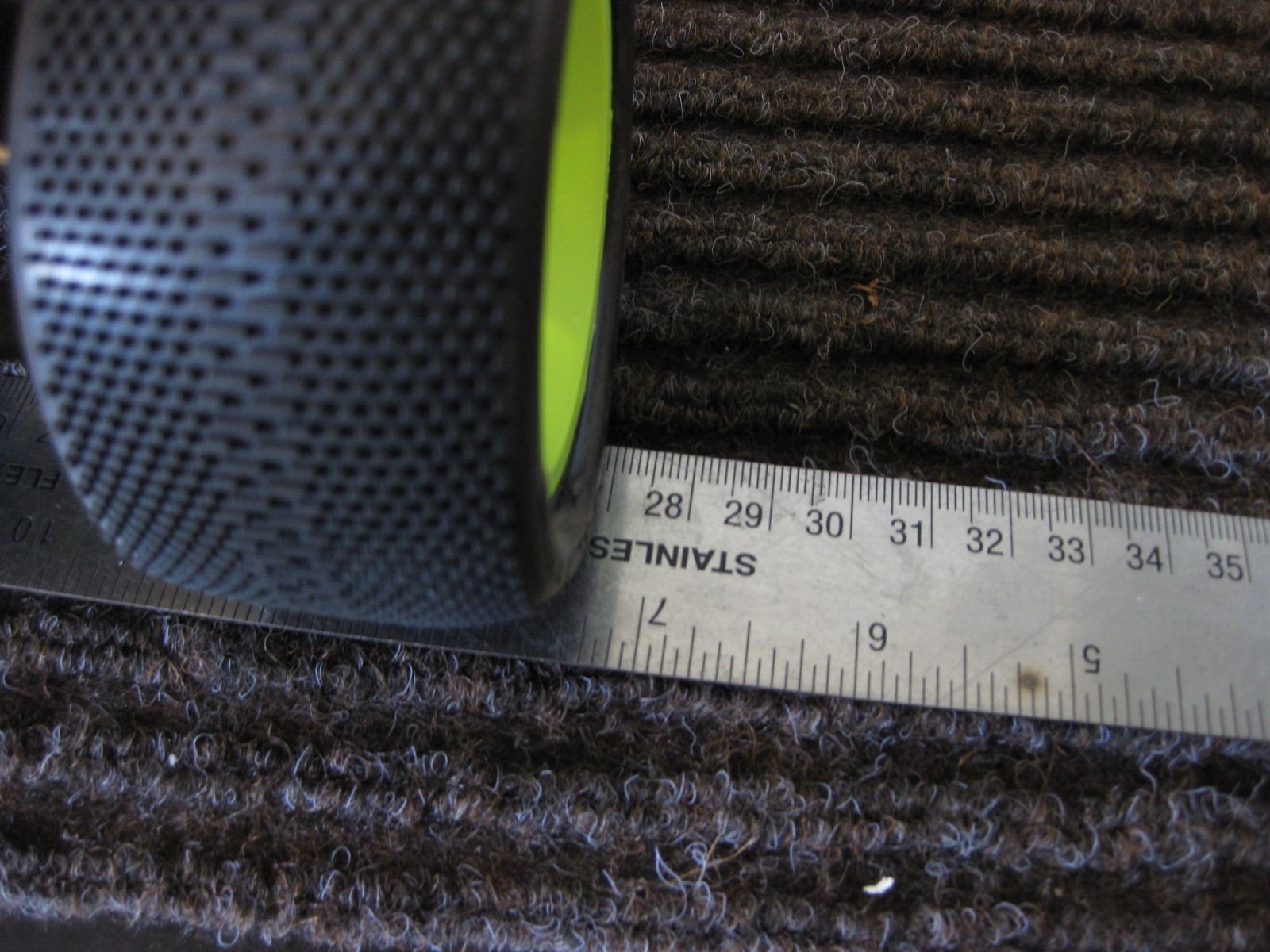

Me likey a lot!! How much wider is the suspension over the B4? Also, are the rear arms not at wide as the 10t arms?

the rear arms are shorter than standard 10tmatteo wrote:Me likey a lot!! How much wider is the suspension over the B4? Also, are the rear arms not at wide as the 10t arms?
i dont have a b4 to measure off of, i had met a guy at the track, and we compared then.

A B4 should be max 250mm wide per IFMAR/ROAR rules.

well i guess this car wont pass that measurement!!gregm wrote:A B4 should be max 150mm wide per IFMAR/ROAR rules.

it should be 250 not 150 mm , but, yes, you're out.

with b4 wheels it will fit in the box.........Mr. ED wrote:it should be 250 not 150 mm , but, yes, you're out.
