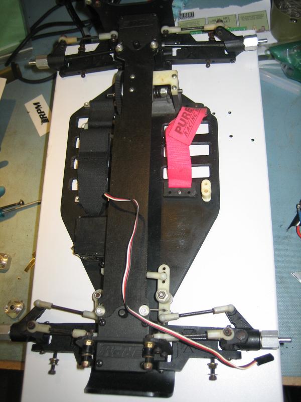

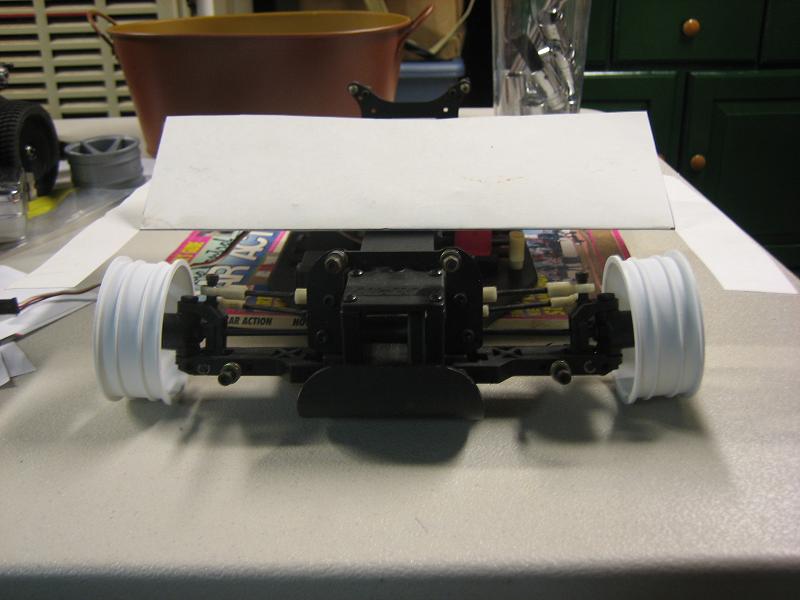

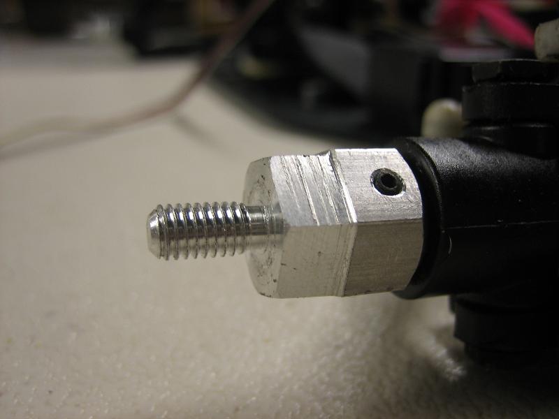

OK, I finally have some updates. I managed to drill out the standoffs with a 5mm drill so that they fit over the axles.
measuring up the overall width, it clears 250mm quite nicely. will need wheels that basically have a flat face, so that they don't protrude past the threads. I quickly filed off about .015" from each face of one of the hexes, and it fit nicely into a traxxas wheel i have here. Now I'll need to drill and tap for some set screws, I think I will be using a 6-32 grub screw. In a couple of pics, I used a width gauge made of white cardboard, and I am attempting to show the clearance, quite poorly. I apologize. I think I will also need a small shim behind the standoff to keep it from rubbing on the bearing. the factory parts have a small lip machined on the face for this purpose.
In looking at some of the pictures on this thread recently, it looks like the lazer wheels will work well. I'm planning on picking up the cyber10 5 spoke wheels to see how they work.

good question. I used a peice of a #10-32 screw with the head cut off, screwed that into the standoff, and mounted it in the chuck of my drill press with the quill stop in the down position. Then clamped the standoff in the machinist vice in that position, and put on a clamp on that to hold relative position. Unlocked the jaws of the chuck, and released the quill stop so that the chuck will return to normal position. Placed drill bit in press, and let the drill find center. It's d@mned close to perfect.
it would have been easier if my chuck was bigger, but I couldn't fit the hex into the chuck, otherwise, I would have used another standoff as the jigging tool, to set up each sucessive one. I usually don't like chucking threads, as they can sometimes be off, but my drill press is nice and new, so the chuck isn't chewed up.
I would have used my lathe, but this in peices, and another project on the list.

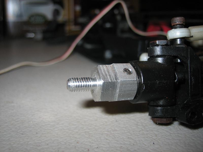

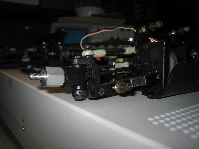

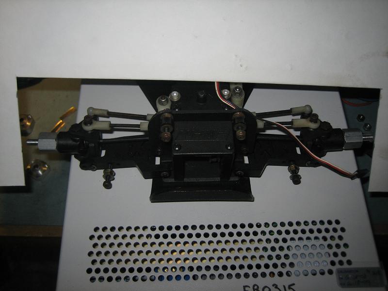

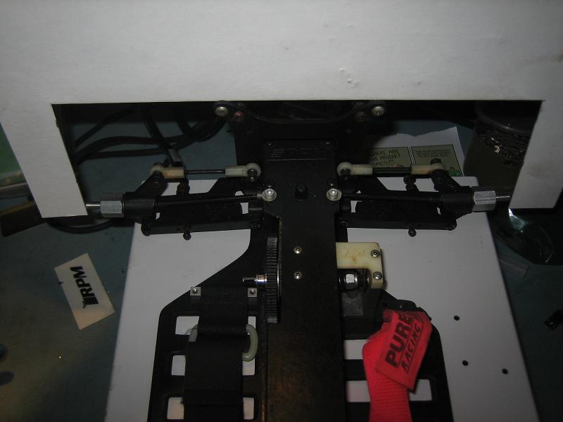

small update:
waiting on cyber10b wheels from tower, and the rears are out of stock.
meanwhile, back at headquarters, I was able to drill and tap for set screws, and file down the adapters to 12mm. see the pics:

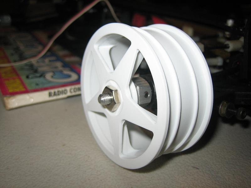

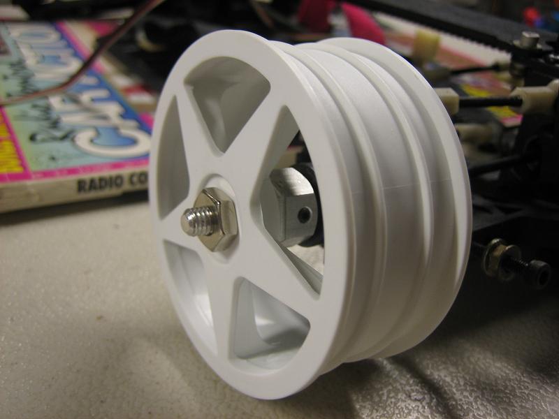

Re: possible way to mount modern 2.2" hex wheels to your YOKE.
here are the front wheels mounted up. waiting on rear wheels to get back in stock...
