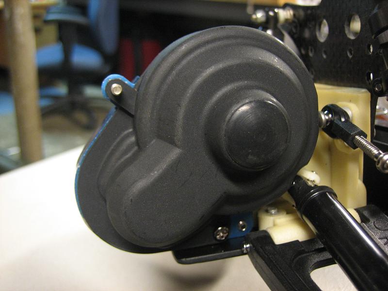

oh, also, if you are planning to make these out of lexan, any of the newer traxxas gear covers look the same, the only difference between them all is the mounting holes, so the cover, with a molded flat flange could be used for pretty much all of the old style metal motor plates, just the trimming determines which one it fits.
for example, I found that the rustler/stampede/etc gear cover fits the blue eagle trans, but the mounting ear needs to have a spacer behind it. The hole pattern is the same, but the new trucks have a protruding mounting block, so the ear doesn't sit flush with the edge of the cover, I had to install a screw and nut arrangement, and the cover gets secured with a nut on the outside. I hope you can follow that description. This cover would fit the trx1, but the top ear is in a different place. If it was made of lexan, and had a long flat flange, like would occur from the molding process, it would fit both trans'.
If that isn't clear, I can snap a pic.

here are some pic with a rustler/stampede gear cover: dark blue is a blue eagle, pale blue is a trx1. cover fits on eagle with the aforementioned 'stud and nut' arrangement. TRX1 mounting tabs do not line up.
