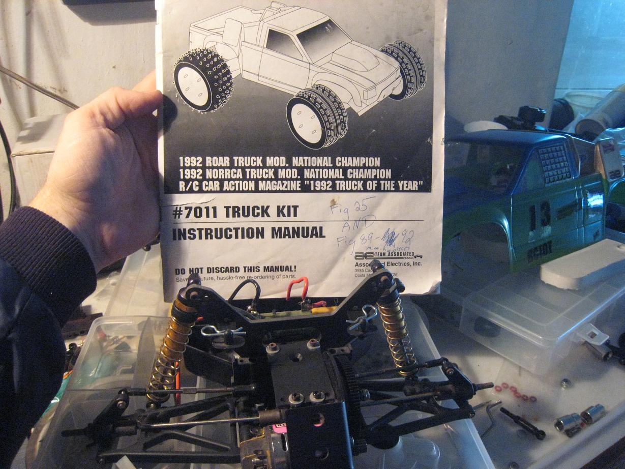

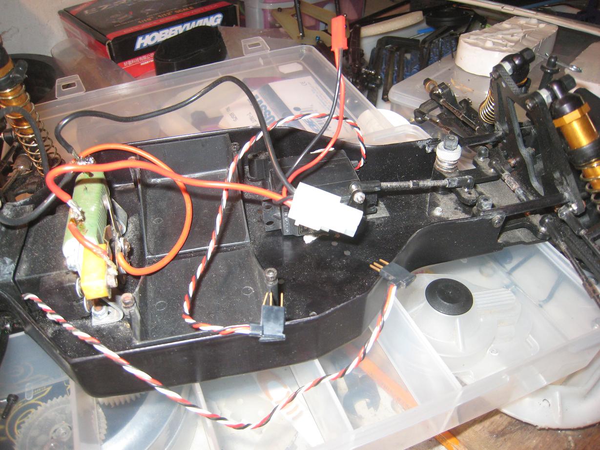

Got this on ebay for $68, I'm quite pleased because of it's minty goodness :D
Other than that I am amazed by the way the truck has been put together, can you spot the wierd stuff?

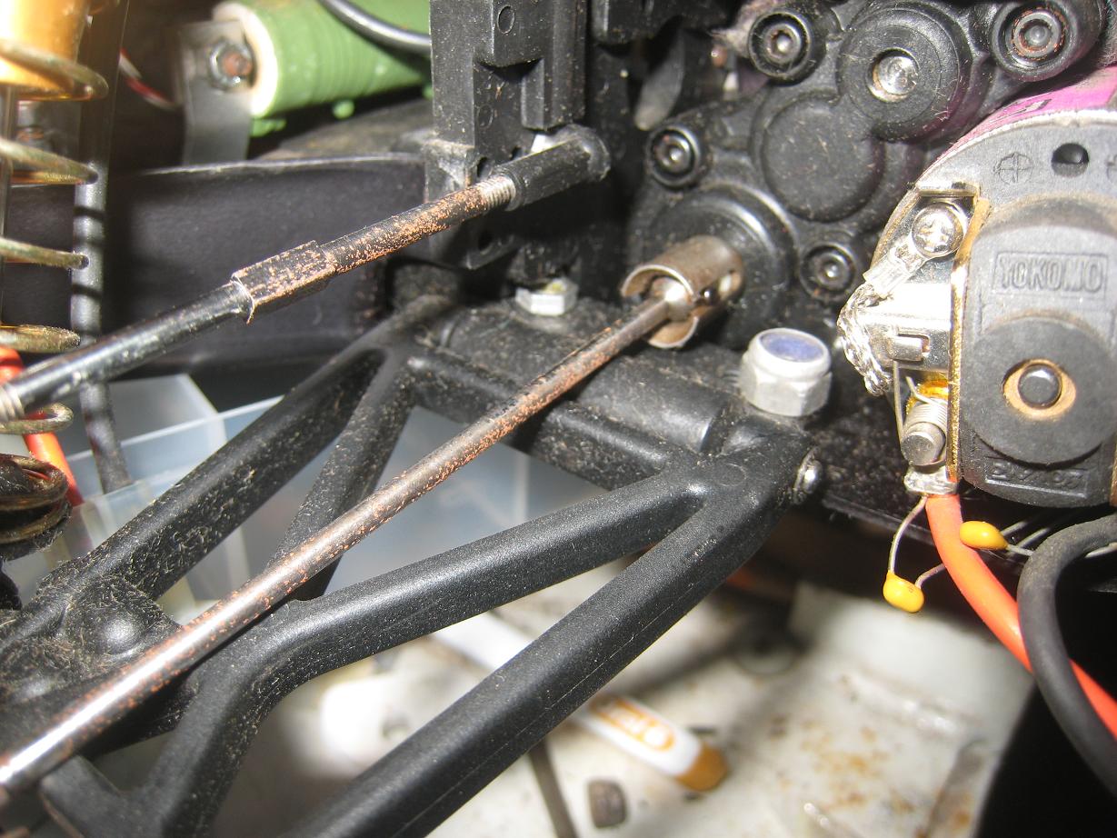

The only weird thing I see are the giant 8-32 nyloc nuts on the rear arm mounts...other than that it's a late 7011 kit...with old Futaba 'G' plug electronics. Do tell more.

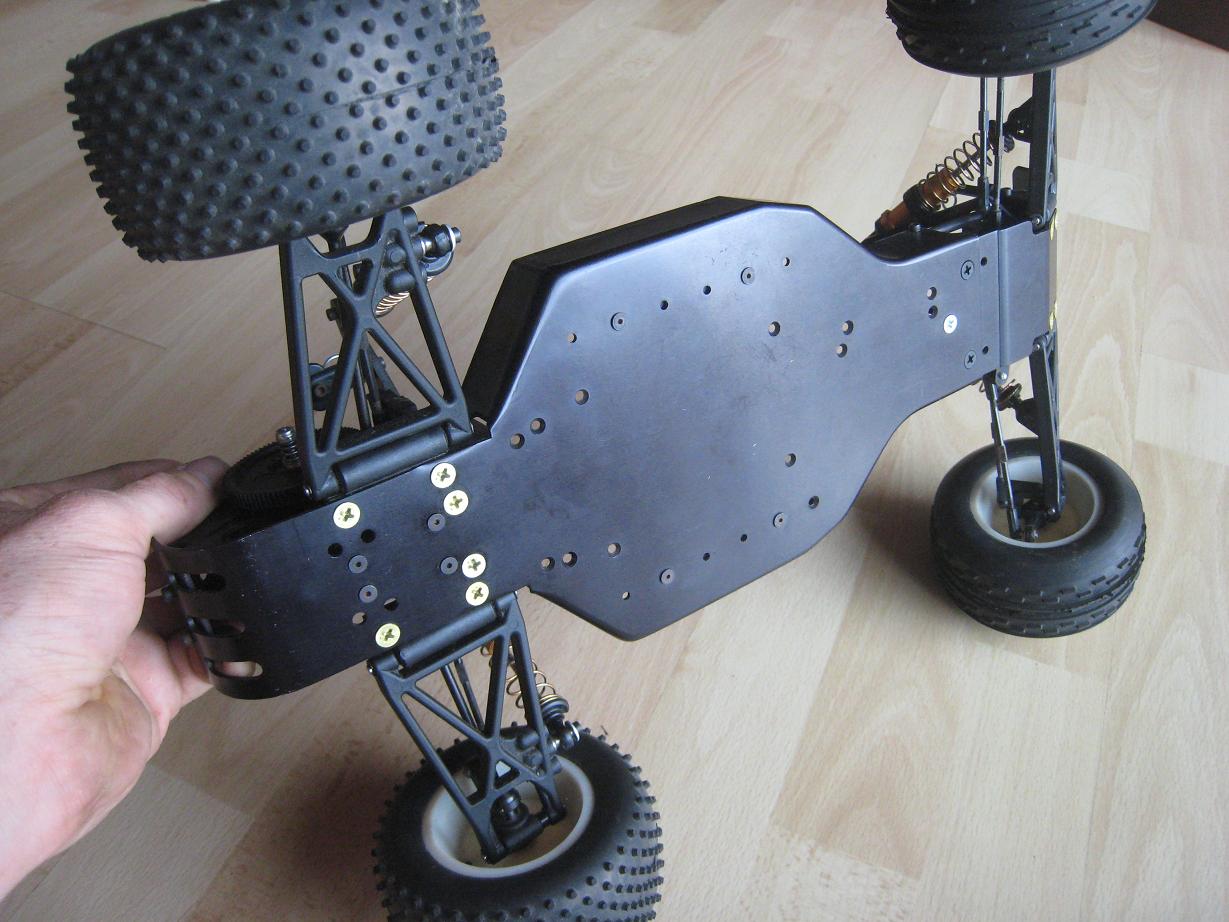

Looks like the rear arm mounts are on upsidedown?

the mechanic speedcontrol and baterry orientation are not what you'd expect on a black tub

The rear tie rods are awfully far inside the bulkhead, but I assume that was done to lower the ride height. The old electronics, especially the speed control seem a bit odd for that truck. It obviously would make the truck run though. I guess you run what you can get your hands on in some cases.

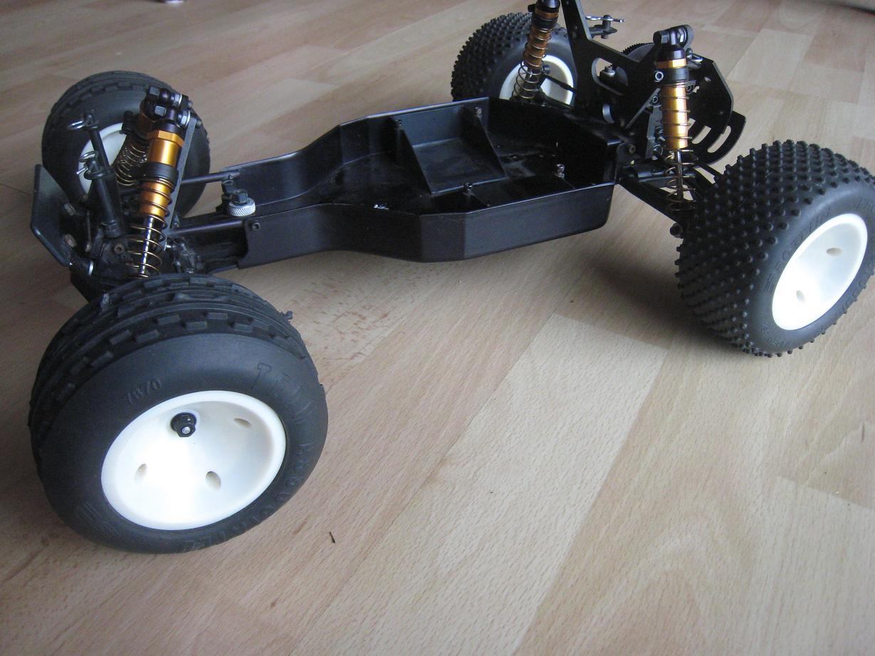

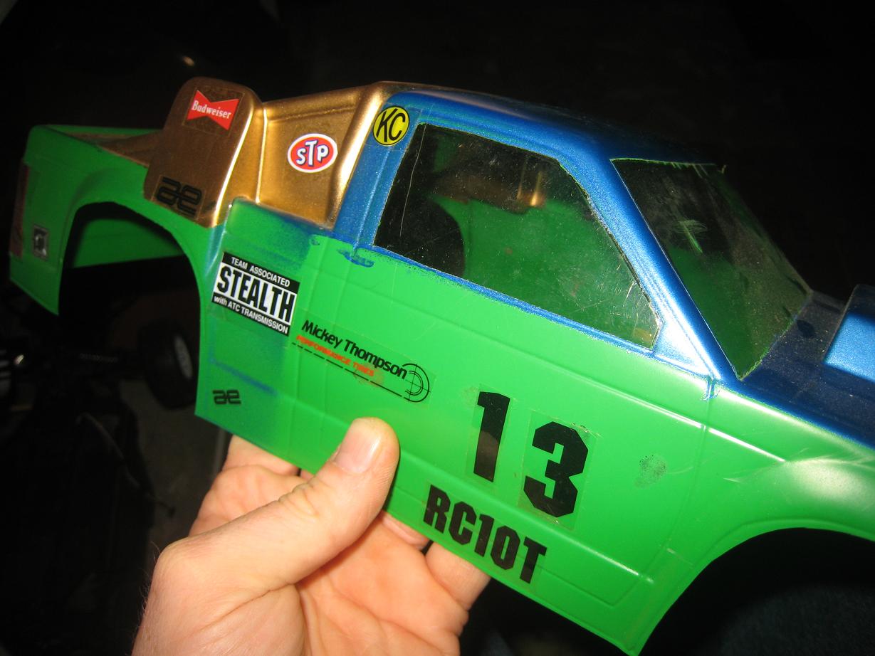

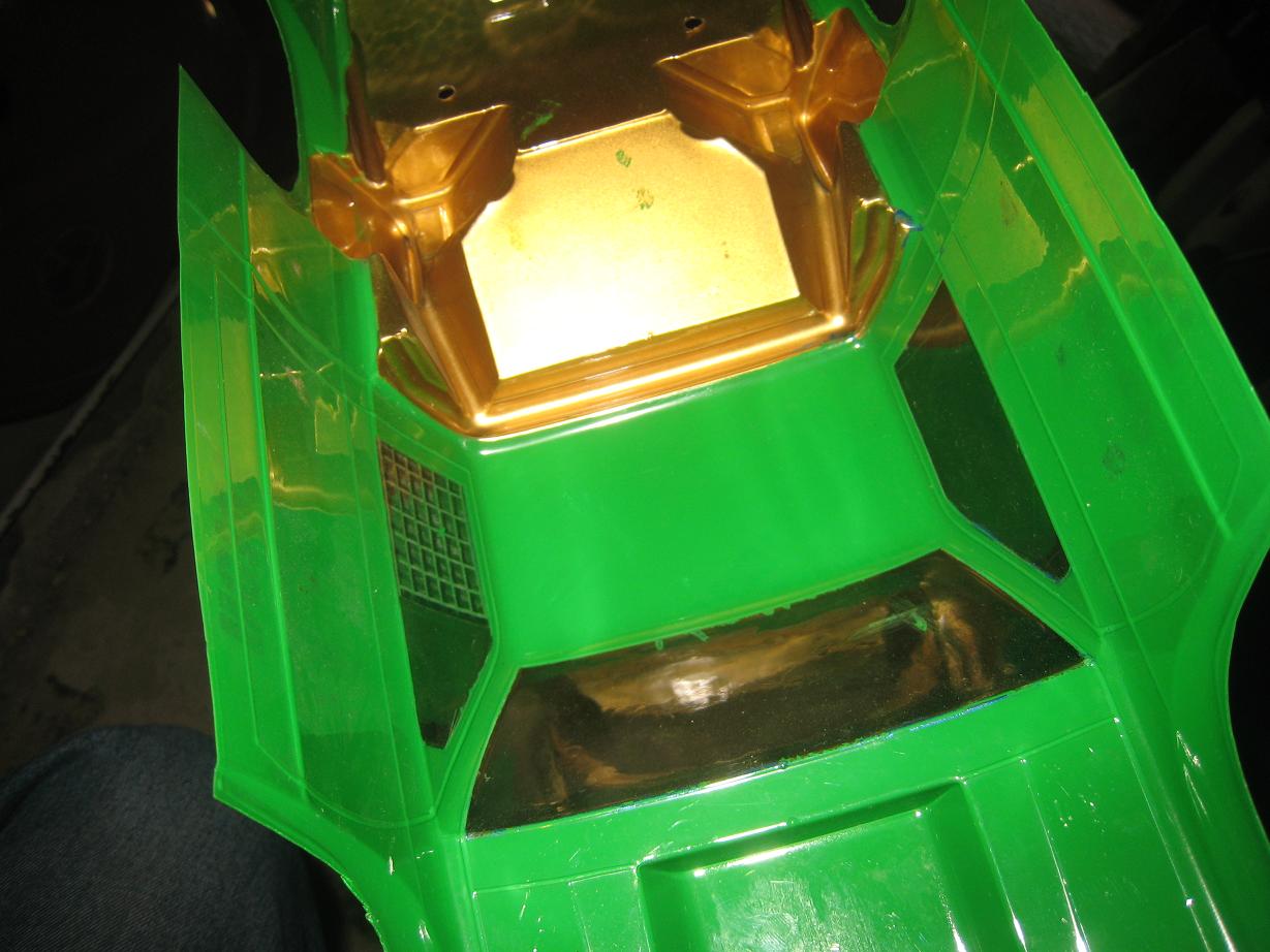

Bingo, rear A-Arm carriers are upside down and have nuts holding them on, Body has been painted with great patience, paint the outside and... oh damn... didn't post pics of 'em but the 3 piece rims are assembled with the allen bolt heads on the inside of the rims... it's mmmadness :lol:
Things that might be ok but are strange to me:
These a-arms are very different to my other 10T, more chunky yet thinner.

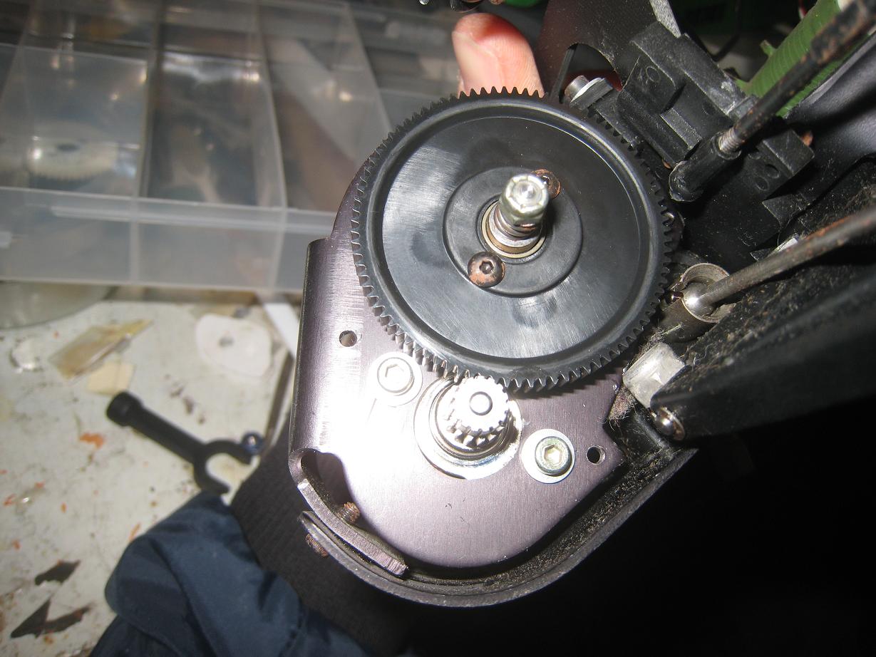

Spur gear a lot bigger than I am used to and also quite chunky.

Spur gear looks the same as what originally came on my T2 and T3

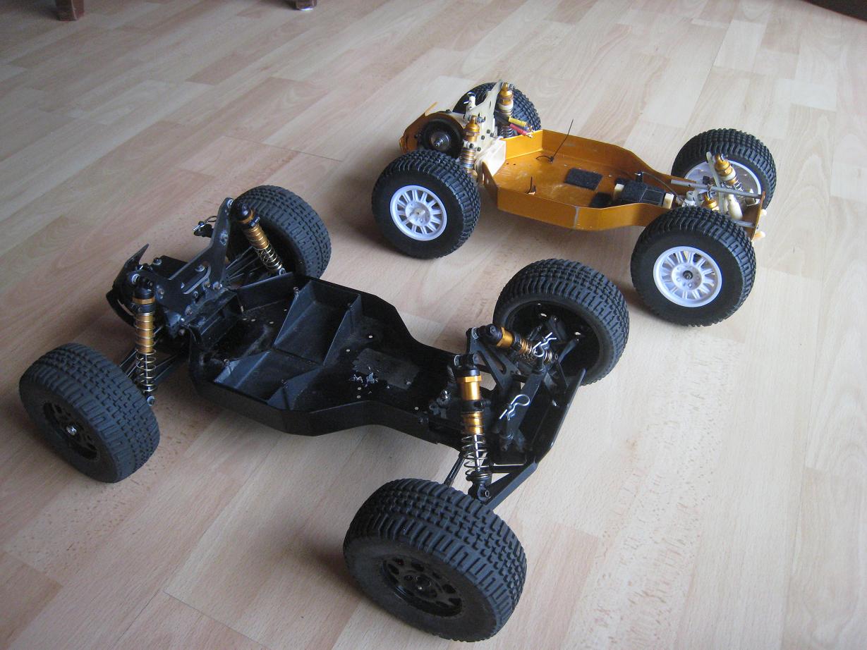

I toyed around with my SC10 wheels for interest sake.
