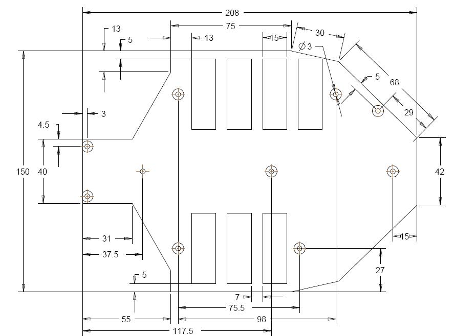

A couple of years ago Woober Goober was good enough to lend me his saddle chassis plate for the AYK Boost/Radiant 4WD buggies. I then took the chassis to an engineer who struck up a deal with me to have all the plate work drawn up on C.A.D. It cost me 2 days of labour helping him with a renovation (Im a Carpenter) but in the end I came away with all the shock towers, chassis side plates and the lower saddle pack chassis drawn up on a file I could then use to cut some platework from.
Around 6 months later my good friend Antony in Melbourne (owns an engineering firm) helped me cut the files from fibreglass sheet. The pics below demonstrate the process,
-Jason.

Woober also made a tracing of the chassis and supplied lots of measurements to help me along. Obviously I had the file altered from the 7 cell configuration back to a 6 cell.

Thanks for the draw, what is the exact thickness from Race Prep Graphite chassis...
Thanks PRP.

around 3/32" would be my guess (2.5mm?)

Hi tried to design the chassis in CAD for my friend PRP, but some dimensions looks wrong, and the width are missing, 150mm ??? not sure !!!
