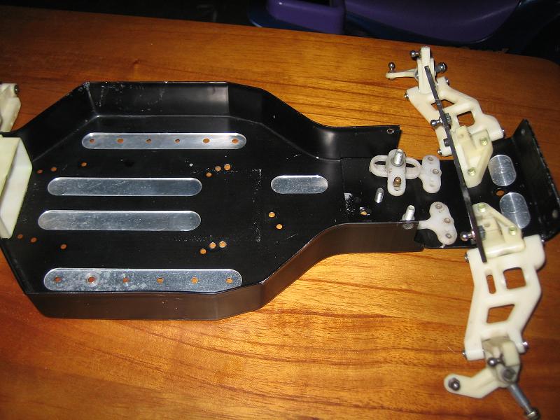

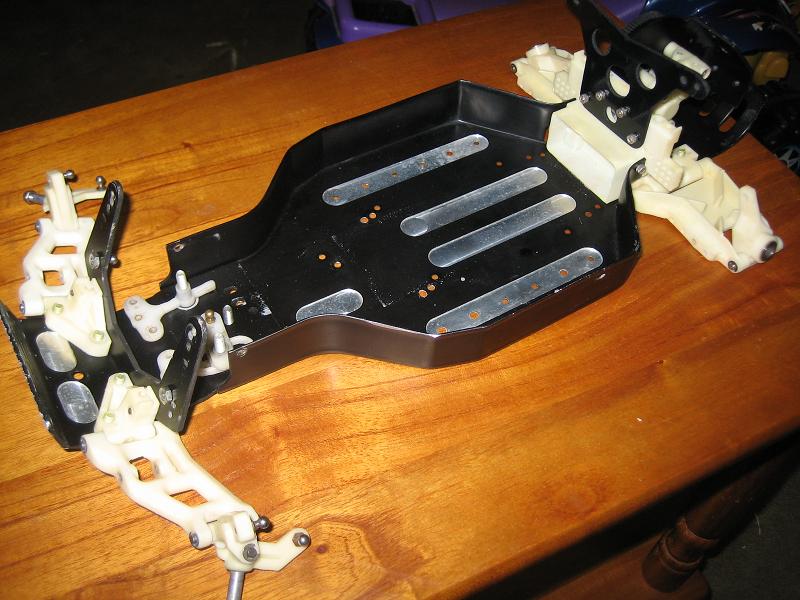

So this is my latest hodge podge of parts I've been picking up in bits and peices.....it's a collection of white parts, mixed with a little handmade 'worlds' chassis complements of ebay, with a sprinkling of new parts for good measure. She's a runner, though i'm gonna stick some film on the bottom to keep it from getting scratched up any more, and probably just do a little around the yard running.
the pieces are all used, and have their share of battle scars. The shocks will be originals de-anodized and lightly brushed, with white parts.
had a few members help out in a few key areas, so thanks alot, i won't mention by names.
I'm going to continue the faux 'worlds' theme by adding my own version of 'worlds' shock towers, although i might stick with the yellow/green g10 'glass instead of carbon, so that the only items that are black are the nose, chassis, and motor plate, with everything else a light color. otherwise, I'll keep the carbon front tower, and make a carbon faux worlds rear one. I can't decide, I'm going to make both and see how they look. I'm probably going to make my own bellcranks out of some raw nylon i have to mimic a set of losi bellcranks i have on another car.
will be using rpm white ball cups, making polished aluminum nose tubes, and carbon fiber trans brace. regular old stainless steel all-thread links unless i bite the bullet and go with the associated titanium turnbuckles to add a slight bit of color.
I have yellow B2 wheels front and rear to go on, again, used, but will clean up nicely.....need to decide on a body, and what kind of running gear to set her up with......enjoy!

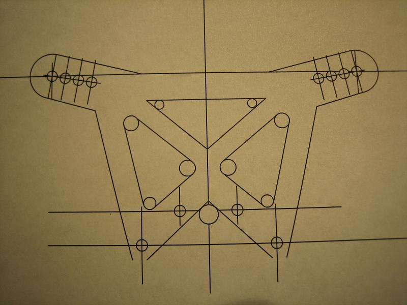

Looks good! Who did the milling? You draw up that shock tower?

I drew up the shock tower, I worked off of a couple of different sources, it's not exactly like a worlds tower, but I just think they look cooler than the standard tower. I have the means to make anything I want, much easier than spending $$$ for a real one, hahhah
It's not a real cad program so radii are hard to do by hand, which is why you see all the circles and unfinished edges. I use the program(visio) because I have it, and it always prints out for me at exactly 1:1, so I print it, cut it out, and make a template.

i'm kinda torn what i want to do. I have 2 options, well, i guess 3.
I'm going to make a rear tower following that template, as a template/drill guide out of standard yellow/green g10. I already have a team car front shock tower that would match the color more or less, so I have 2 light colored towers that way.
After making the glass template/drill guide one, I'm going to transfer that to some carbon fiber, I think. So i can match the existing composite one, or build a custom 'worlds' style for the shorter shocks out of carbon.
yeah, I was collecting these parts and leaning heavily towards an aluminum tube chassis, but that takes alot of time and effort which is in short supply these days for me, so I saw this milled chassis on ebay, and tried to get it. I saw a sweet blue anodized one around the same time (not factory anodized, but great job), but I won this one before the blue auction ended.

I was planning to get the blue tub didn’t. Your 10 is looking good I would suggest making both front and rear towers from the same material. You have a custom tub might as well make more custom parts for it.

i agree, go with front & rear custom carbonI would suggest making both front and rear towers from the same material. You have a custom tub might as well make more custom parts for it.

yep, my plan would be to have either both fiberglass, or both carbon, I'm going to make both (as needed to make a set) and try em out to see how I like them.
I agree, that is one cool thing about the rc10, the parts were made with some thought behind them, but also made from simply shaped materials, so the common guy could whittle his own if he really wanted to. Once you start making oddly shaped molded parts, the tools to replicate get complex.

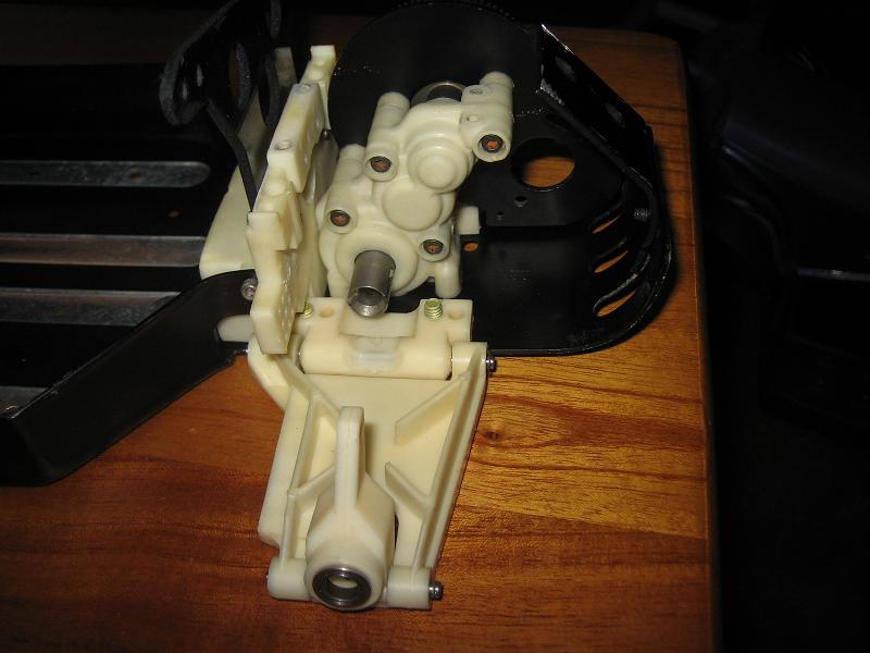

Not much work on this so far this week, although I did make up a couple sets of nose brace tubes for this car, and another one.
has any one seen that the top of the stealth trans and the top of the bulkhead are at different heights? I started mocking up a trans brace to cut out, but i notice that there is a heck of a misalignment. was the height of the bulkhead changed with the intro of the stealth? it plain doesn't look right, but everything i see in the manuals just bolts that brace straight down.
I didn't think so, because I have a 6 gear with a nylon brace, and it looks misaligned as well, but the nylon has some give, so it flexes down.
can anyone comment on that? I'm thinking I'm going to build a small spacer plate to go under the bulkhead side of the brace to level it out, so it doesn't stress the trans or chassis.

Huh, thats weird. They didn't change the BH when they went to the stealth aside from some different ball stud holes. From the pic it doesn't look like the BH was hacked at all. I don't know whats going on there but it isn't right.

yeah, i'l take a pic to show what i'm seeing. it's got to be ALL bulkhead and trans' scenarios from what i can see though, if they didn't change the bulkhead....it's probably off like .050-.075" at least. I know my chassis is warped a little, but it would have to be one heck of a bend to see that much difference, and I know it's not.

I don’t think they change the BH for the stealth but I do remember adding some spacers to the BH so I didn’t have to force the plate down. It might be a fabrication error, or the chassis is a bit bent on the rear section. I remember some misalignments on these cars; like adding spacers to the rear screws that attached the motor plate to the chassis.
I would probable add the spacers and keep on going.![Smile :)](./images/smilies/icon_smile.gif)
