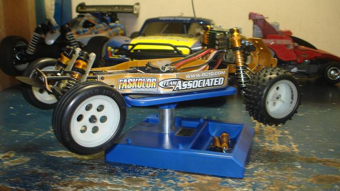

First:
I always forget to start a thread about a build until it's almost done. So here are some pics of my almost completed gold pan runner.
Nothing much. A&L Steering, Proline wheels, AE 6873 tires front, AE 6823 tires rear, ball bearings throughout, JG front bumper.
What I think came out real well (for a runner) is the Chassis. when I got it it was painted blue. Then I painted black over the blue. Well one day I decided to try some stripper from work and well, I think the Gold looks better :wink:
Also the wheels were painted gold when I got them. So I used that same stripper on them with great results.I'm going to run a Orion Method 17x2 motor, but leave the Mamba ESC in there so I can switch to brushless whenever I want to. I just need to install the electronics, paint a body and this thing is good to go.

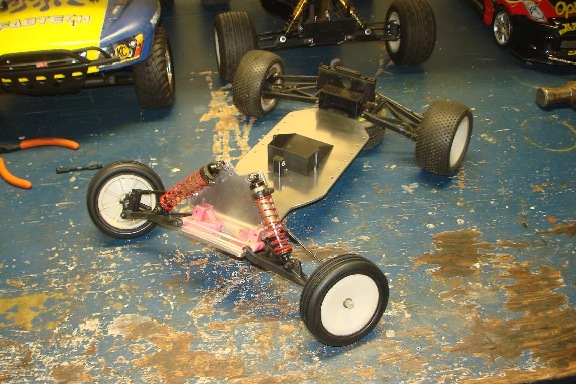

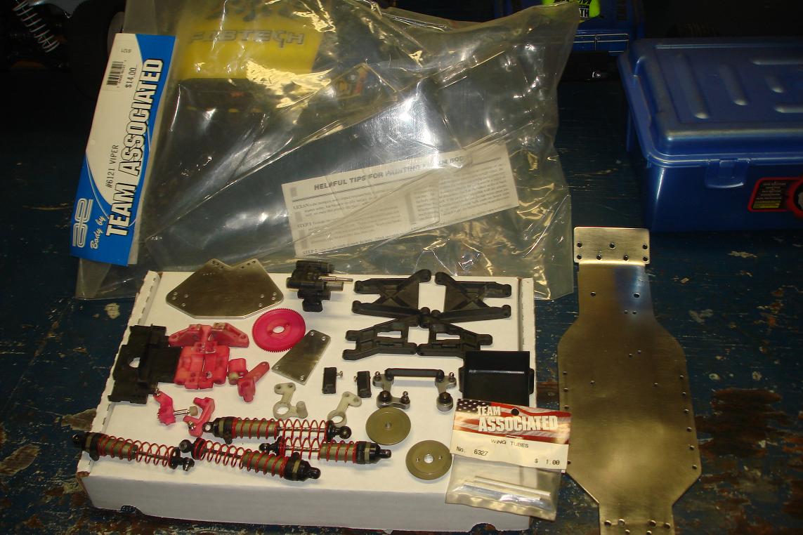

Now for the Current Build:
The Chassis:
And some parts:
I layed out some parts that I was thinking about using. I wanted to go with a Pink/Black theme but I'm not sure if I'm going to use all of them :?
I know for sure the Steering, Viper Body and Team shocks. ... But after I started to clean up the parts I decided I want to do something different with the front suspension but haven't decided yet. And I don't like the way the front shock tower turned out, I might go with fiberglass or composite towers.
Well that's what I got :D
I'll try to keep track of my progress this time :lol:

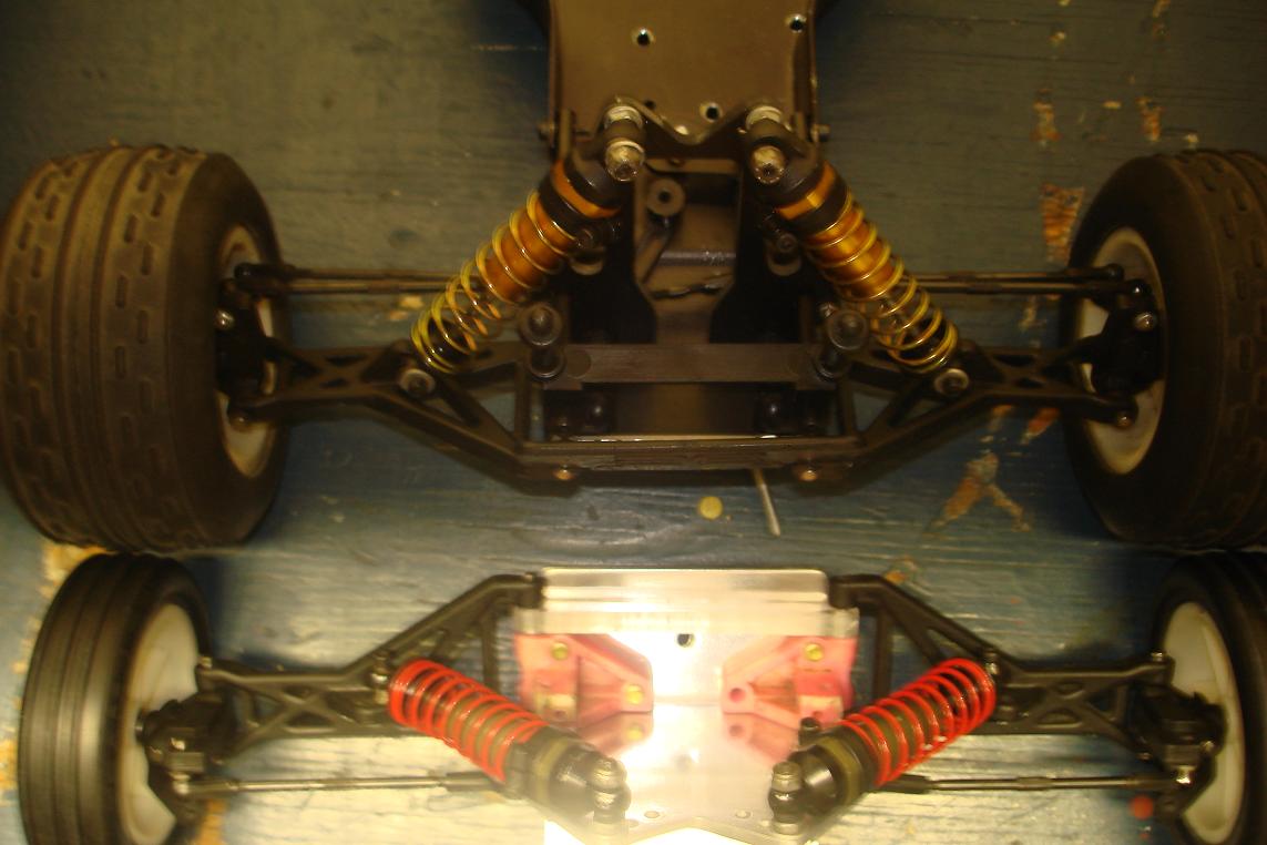

Well I test fitted an Idea that I was toying with. This is a very rough test fitting...
I got the truck arms mounted on the Buggy arm mounts. This makes it way wider than the stock buggy setup and about 1/4" wider (axle to axle) than a stock truck setup
Compared to a wide track Buggy:
Compared to a stock 10T:
This was a very rough test fitting. I still have to clean all the parts and work out the kinks. The red shock springs are way too much, and I still don't like the way the front shock tower came out... a re-design may be needed...

love it-
What 'Truck arms" are those-- the original RC10T arms?
I'd like to try something similar on the Fun Buggy-- where did you get them, please?

Post by metallicats33 »
rears are T2, fronts are off a 10T. The only thing I have left to figure out is the steering linkage and rear shock setup :?

nice-- are you using the RC-10 rear blocks to mount the arms, or t2 blocks?

Re: Custom Aluminum Chassis Build
Post by SteveK »
metallicats33 wrote:rears are T2, fronts are off a 10T.
T2 and 10T arms have the same dimensions, the T2 arms were just a slimmer design. Eventually the GT came with them as well. Those fronts look like T2 arms too.

Jeep-Power wrote:nice-- are you using the RC-10 rear blocks to mount the arms, or t2 blocks?
As far as I know the 10B & 10T rear blocks are the same, I'm using the 10T's. The front blocks for the buggy are smaller than the 10T's arms so you will have to use a spacer on the front of the hing pins.
SteveK wrote:Those fronts look like T2 arms too.
That's what I thought, but either way they are practically the same demensions... I think.

Post by SteveK »
Yup, the T2 was really a very mild variation of the 10T; the only different parts were the chassis tub, tranny, and rear bulkhead. The entire front end except for the bellcranks was exactly the same, the suspension arms have the same dimensions, and the 3/16" rear axles will fit the 10T if the change the bearings. The angle of the rear shocks was different too.
