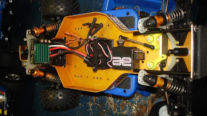

First:
I always forget to start a thread about a build until it's almost done. So here are some pics of my almost completed gold pan runner.
Nothing much. A&L Steering, Proline wheels, AE 6873 tires front, AE 6823 tires rear, ball bearings throughout, JG front bumper.
What I think came out real well (for a runner) is the Chassis. when I got it it was painted blue. Then I painted black over the blue. Well one day I decided to try some stripper from work and well, I think the Gold looks better :wink:
Also the wheels were painted gold when I got them. So I used that same stripper on them with great results.I'm going to run a Orion Method 17x2 motor, but leave the Mamba ESC in there so I can switch to brushless whenever I want to. I just need to install the electronics, paint a body and this thing is good to go.

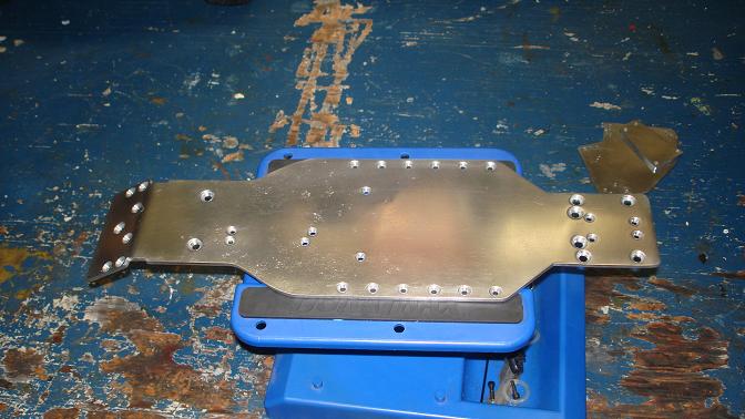

Now for the Current Build:
The Chassis:
And some parts:
I layed out some parts that I was thinking about using. I wanted to go with a Pink/Black theme but I'm not sure if I'm going to use all of them :?
I know for sure the Steering, Viper Body and Team shocks. ... But after I started to clean up the parts I decided I want to do something different with the front suspension but haven't decided yet. And I don't like the way the front shock tower turned out, I might go with fiberglass or composite towers.
