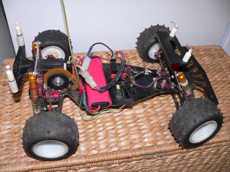

Here is a photo of the truck conversion runner I have; with a graphite chassis and mid-motor mod; combination of the Andy's (rear) and JG (front) truck body mounts. I also just picked up a pair of new tires for it as well:
http://cgi.ebay.com/ws/eBayISAPI.dll?ViewItem&item=220588228064
