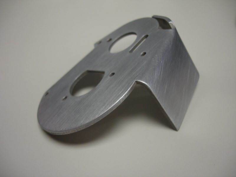

My modded motorplate is finished, a little polishing and then light gold anodizing like my front spring adjusters and she will be ready to put back on the car. Noseplate is being done as we speak! Thankfully my welders owe me a few favors for either engineering or computer related things.

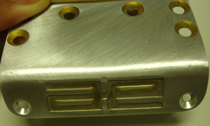

My custom machined heatsinks for the Novak are almost ready, and look exactly like the original one Novak did. Thanks for the great pics of it to use as reference Asso_Man!

Motorplate is done with the welding and grinding. Body post hole removed.
Next step, everything to anodizing.

Ruffy, I really hope than the anodizing process will do not alterate your job.
I already tried to weld some parts (as the square cutting area of the productiong B2 rear lower plate ), after griding they looks ace, but the anodizing process show the welding joint.
It may depends if you use or not the same aluminium to weld your part as the original alumiunim...

Kenooze:
Agreed, that is why I had him specifically use the same type of welding rod for my parts that the chassis is made from, as he has been under that understanding from the onset. We planned for this in advance.
We have extensive background with all forms of anodizing here, the perils of mis-matched materials, and problems from differing dips and temps... including hard anodizing which I have had done on my C-17 trainers for the thrust fan deflector actuators.

fastang; I will ask my Sr. Chief welder and let you know. I assume he used a welding rod compatible with 6061 for anodizing after the metallurgy tests, but I will let you know for sure tomorrow after I ask him.

fastang, I missed the welder yesterday, but cornered him just now and he said that in fact it was ER5356 aluminum alloy weld rod, specifically for 6061 weld repair when the application is to be anodized afterwards. ER5356 filler works fine with 6061 and doesn't have the problem of 'looking different' after anodizing.
ER4043 is generally the preferred filler for 6061, the exception being when color match is required after anodizing. ER4043 will ALWAYS turn dark grey after anodizing ( due to the much higher Si content )
ER5356 is the next best choice and is readily available.
