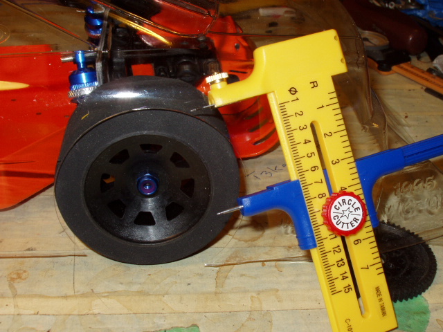

I use #11 X-acto blade, a straight, metal ruler and a small 2x4 block to support the body on a table or my lap. Consider Lexan to be like bathroom tire—score the body (you don't have to cut very hard or deep), then snap it apart. Do NOT tear it, but snap it like a cookie. Cut on the outside of the body always. The inside is far too cumbersome and concave to work easily with your hands and a knife. I use curved R/C Lexan scissors for corners and straight, small cuts after the body has been completely trimmed out. Masking tape for straight edges is a great tip, if you aren't comfortable with your knife skills. Circle cutters are great for wheel wells. Measure your tire diameter and and add ~4 mm to that to start the cutter dimension. Use a small (.0625") drill bit as a pilot hole for body posts, and use either a sharp tapered hand reamer or a small tapered stone Dremel bit to slowly enlarge the holes to just larger than the diameter of the body post.

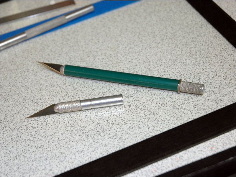

I took one of my original aluminum knife handles and cut it in half with a hacksaw. I ground the end flat, then buffed and polished it, and it fits in the palm of my hand for tricky interior cuts like on the window areas of buggy bodies. Takes a little bit of a different cutting and handling technique, but it works great for certain needs if you have an extra knife lying around.
