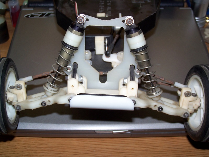

Hi guys,
I'm thinking of picking this one up, will be my 2nd RC10 and I thought it's a good candidate for a runner since I don't want my gold tub getting all scratched up. I do need help IDing the front end (bulkhead and arms) as they seem different. Any help is much appreciated! :D

It looks like an RC10T front end.

it's the 7077 rpm worlds conversion.

sure does look like the RPM worlds front arms, RPM Worlds front shock tower, 10T nose plate and bulkhead. If I remember right, those front arms are hard to come by. looks like a good grab to me...

Lookin' good! Find a set of 1.02" stroke 10t/t2/gt front shocks to throw on that front end. That's what that front end conversion was designed to use and they'll reach the proper mounting holes on that tower. :wink:

the worlds tower is designed to use the .71 shocks, too. so there's nothing wrong with using them.

I always wondered what front end this was, it doesn't have an AE logo on the nose plate. It came on this Team Car I picked up to rebuild/restore? Now I know. :wink:
