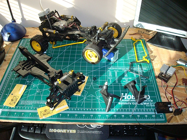

Well I'm back at it again. After working for hours on end trying to get the gearbox situation resolved to no avail I gave up and decided to take a break from it. Well I can't believe it but that was six months ago.
Since then as you can see I got another Kangaroo to use as a parts car. I bought it mainly for the gearbox which works as it should I might add. I've learned my lesson and will not be taking it apart.
