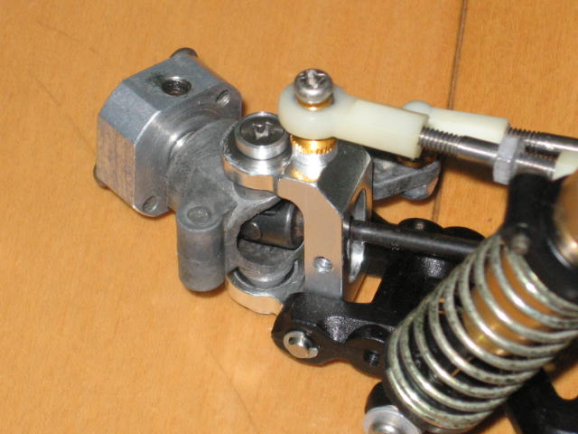

Show some close up of the C-hub, I bet they run ball bearings too :)

here you go........:)

Minimini:
There is a thread screw hole on the front surface of the C-hub. Any idea what that was for?? :wink:

I 'm guessing it might be parts for an optima actually. They are interchangeable

you are right Erik........:)
the C-hubs of 870c & optima are 95% similar........the only difference is that the optima one got a caster angle........while 870c got zero caster........:)
spare parts interchangeability is one of the beauties of vintage Japanese buggies......... 8) .......another word ...... they were copying each other......... :lol:
the thread screw hole on the front surface........is for anchoring the front shock end in optima series............as you know........optima's front shock ends were fixed to the C-hubs instead of the arms.........:)

Thanks. Learn something today :lol:

Did anyone ever identify the C-hub manufacturer, looks like a really cool hop-up?
