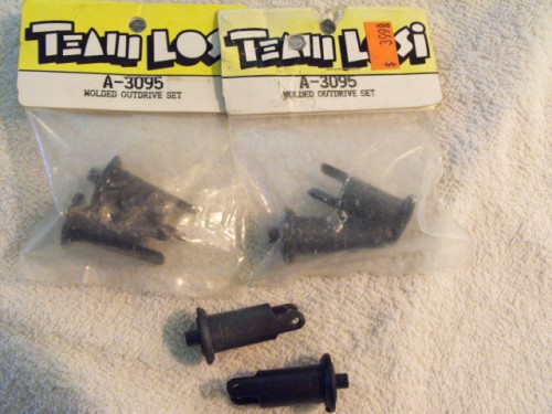

The early XX's came with sliders and the jrx2 and XX use the same axle just the xx use's a newer part number for the same part., I have a bunch of the diff halfs for sale in the BST section.
http://www.rc10talk.com/viewtopic.php?f=6&t=13575&start=0

Classic!, I have some of those 3095 and had no idea what they were :lol:

RCveteran wrote:Classic!, I have some of those 3095 and had no idea what they were :lol:
they will work in the Losi XX or XX retro fit transmissions. I belive they my work in the XXX stuff also. but they were made for the Stock XX.

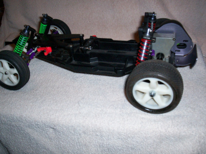

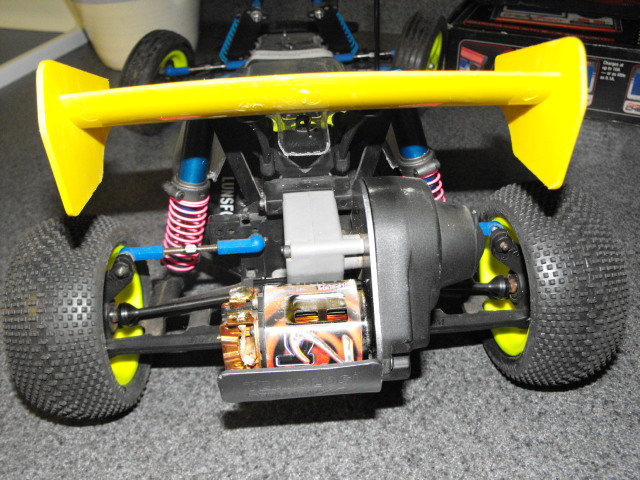

RCveteran wrote:Got it, I have some retrofit diff gears as well. Was the retrofit a diffferent transmission case? Not familiar with exactly what it was but have some parts labeled for it and have seen the term thrown around here.
Yes it was it is used to put the XX trans in the Jrx pro se and LX-T. it will fit all of the cars from the Jrx2 up to the xx with a chassis mod. here is the one in my Pro se and my Junior two. by useing it you loose the top body mount location on the transmission.

Excellent, so it is a different case and regular XX internals. What is that motor you have in there?

RCveteran wrote:Excellent, so it is a different case and regular XX internals. What is that motor you have in there?
It has a Trinity P2K. a very nice brushed motor. but its comming out as soon as my brushless 17.5 that AE. owes me gets here. the trans is pretty strong, I ran a 10.5 brushless with a lipo and it held up but was so fast it wasnt even fun to drive.

That is the motor that was in the kinwald I just scored off ebay. I have not tried it yet but it looks like it was never run or barely. I could tell it was a nice motor with the vents in the cans and the sticker with the dyno data etc.
