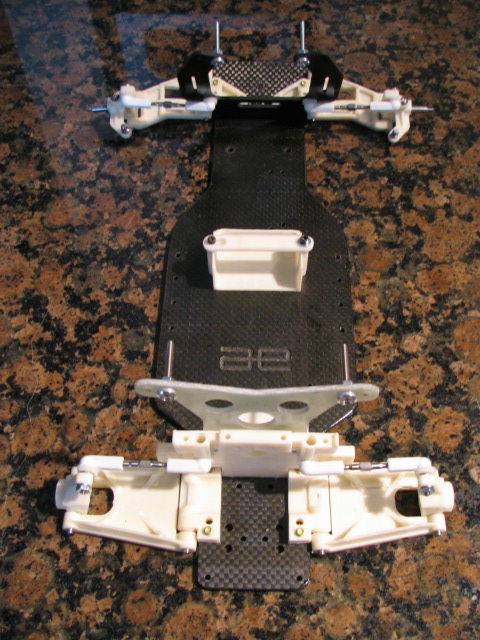

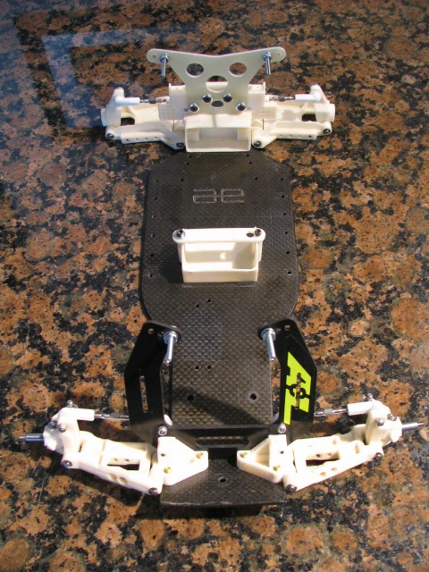

Alright, so I am getting close to putting the tranny together, and man I had forgotten how heavy the outdrives were. I was curious were there even any lighter ones offered (Delrin or Aluminum). I had found some on Custom Works site and wondered will these work?
They are PN# 4381
http://www.customworksrc.com/ProductDetail.jsp?LISTID=80000764-1255375629
Thank you everyone for your help,
Maurice
Some pics of the buggy - and its progress.
