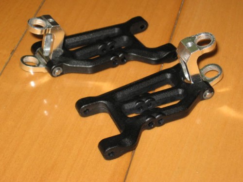

now comes to the front legs...........dug out a set of RPM worlds arms from my RC10 parts drawer recently........:)
replaced the original C-hubs with aluminium ones........which can use 5 x 8mm flanged bearings x 4........:D

Post by wyldbill »
what aluminum c hubs are you using? i did not know there was a aluminum replacement to the m.i.p. ones. do you have the steering knuckels to mach as well?

wyldbill wrote:what aluminum c hubs are you using? i did not know there was a aluminum replacement to the m.i.p. ones. do you have the steering knuckels to mach as well?
no direct replacement to the original MIP ones.........:(
the aluminium C-hubs were taken out from an optima.........I need to enlarge the hinge pin holes to 1/8"..........& actually I did a lot of fine modifications in order to smoothly fitting them on the RPM arms.......:)
probably I will use the TC3 steering knuckles to replace the original .........:)

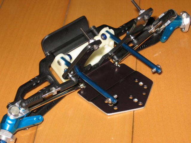

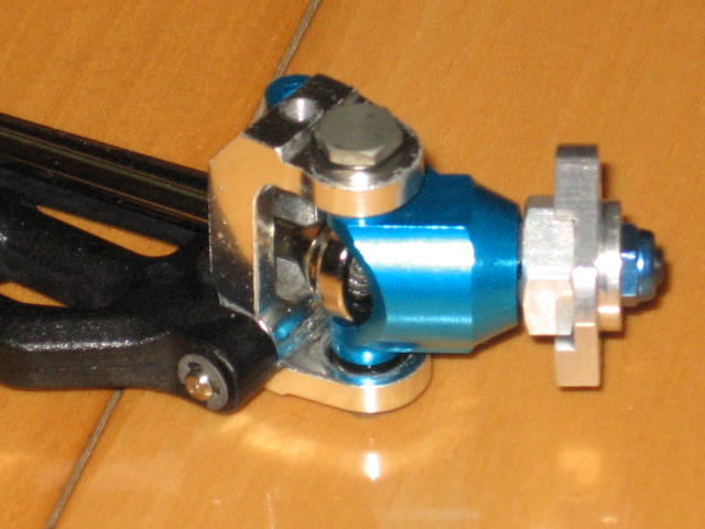

Post by minimini »
spent few hours today ......... assembled the front end..........with the blue anodized aluminium steering knuckles (by SQUARE)........... BJ4 shinny bones with TC3 outer parts..........plus my favourite RCPS turnbuckles & Yokomo wheel adaptors........ :)

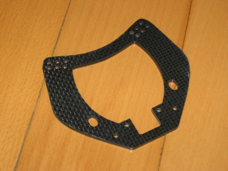

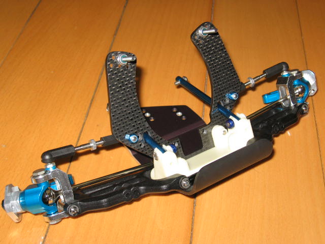

I was busy in the past few months, got no time for this project :(
With reference to Miguel's RC10 front tower, I decided to re-do mine in order to make it as strong as possible. 8)
Need to polish the shinny edges later. :(
