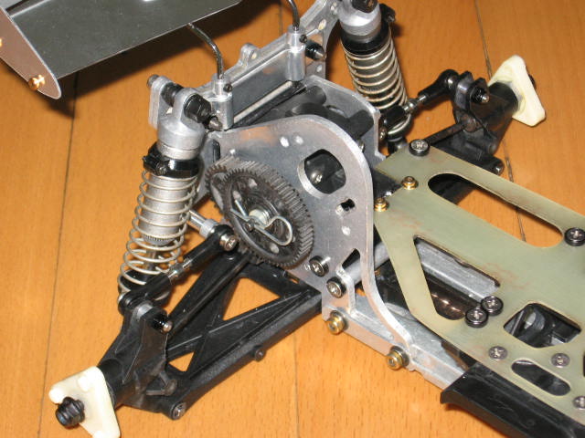

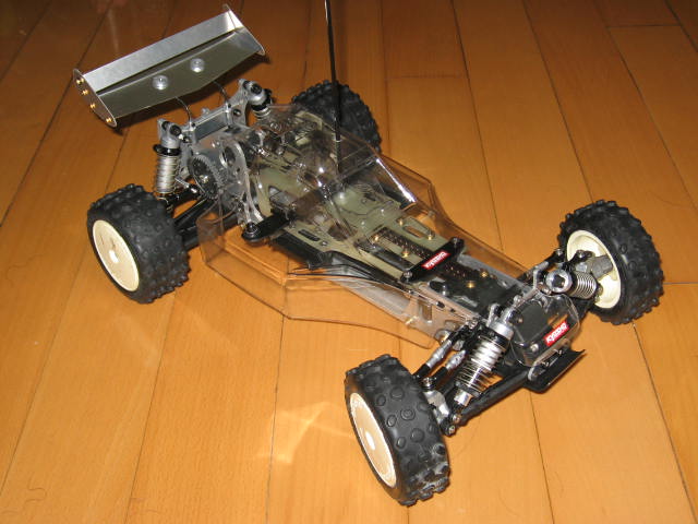

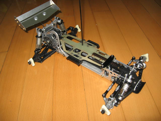

In the old days ............because of the geographical reason........on-road buggies were very popular in Hong Kong..........Turbo Optima was one of the best at that time.......... :D
Lucky enough to buy a set of Turbo Optima "mid-motor conversion kit" from a local 2nd hand R/C shop before........which was designed by GPM I think (appeared few years before the Optima Mid) .............combining with a spare-part car..........hope to make it a runner again some 20 years after its production........ :mrgreen:
stay tuned......... :)

OMG that is freaking sweet. I remember seeing one of these in a Japanese magazine in 85 or so. The guy that had the magazine said he was going to do this himself (he was an engineer) - and I was in awe of him and the mag (impressionable kid).
The fact that you have one in the flesh is awesome - I always thought they were only a prototype.
I have a Hirobo Zerda with a very similar set up (high mounted mid motor), but it is "home engineered" as opposed to finished as well as this one.
FANTASTIC stuff.
If you get the time - I would love a template of those modified motor and support plates! ;)
This will be a thread that watch with great interest.

From my memory.........this was one of the best "inventions" by GPM in the old days .........not just a copy cat at least.............(actually this company did not have many good products in my opinion, or maybe they just exported those up-to-standard goods overseas, leaving those with poor quality in Hong Kong local market........rather disappointing........) ......
But the main drawback is the high motor CG position ........that made the car got a lot of rolling at corners.........a bit like the Marui Samurai......... visual excitement --> good..........actual performance --> errrrrrrrrr........ :mrgreen:
As you can see in the pictures.........I am going to use the BigWig wheels in this car ..........which used to be a very popular modification in Hong Kong at that time........

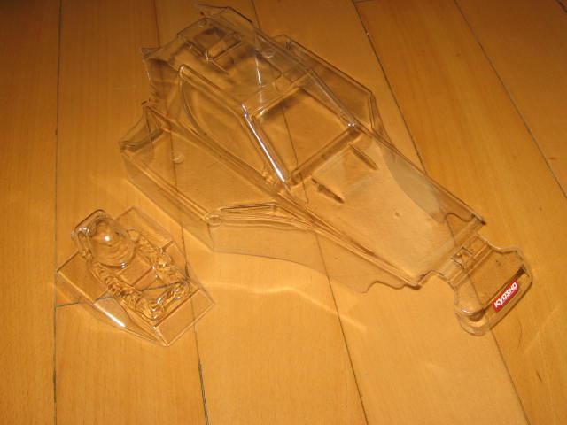

For the body shell ........I got both the Kamtec & Marwan ones indeed..........but I heard from someone that the Kamtec one is around 4mm shorter than the original ........for this project.......as the rear part needs to be cut out........so it makes no difference of using either shell......... I'd better reserve the Marwan one for my original rear motor-mounted Optima projects.............

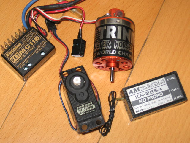

just have a quick look at the store room today.........found a set of BigWig wheels & tyres...........a Kamtec shell with driver doll........an orange Trinity motor (which is using small brushes like Checkpoint motors).......some electronics.........need some time for them to be binded altogether........:)

very interesting modification on the optima!
I confirm that Kamtec optima reproes are several mm shorter than original. Always drill the holes BEFORE painting and making the deco. Otherwise, ... surprise, surprise :lol:
I'd be interested to have more info on the parts... Do you have a manual? an axonometry?
That's funny that they kept the original OT-57 shock stay though :wink:
And I suppose it works with the belt as well? or is the chain length modified?

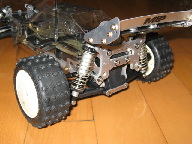

This GPM conversion kit did not have with any manual........ :shock: ........all the components (more correctly, the motor plate & upper deck only, no screws no washer nothing) were packed in a small plastic bag ...........I remember in the old days........when you bought this kit in the GPM shop......the shop owner will teach you how to install .......& he will even take out his own car for your reference........chatting with you........this purchase will cost you at least one hour's time..... :o
The chain length is same as original (the belt kit also fit this).........you need to drill two extra holes in the rear gear box to anchore the shock tower.......but the original rear shock tower was far to weak ........so I double it up as you can see......or you can use some aftermarket FRP towers by CRP , JG or YSP.........

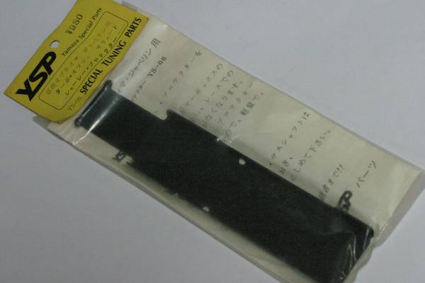

YSP???
Never heard of them. Do you have some info or pictures of parts they made?

Mr. ED wrote:YSP???
this is one of the YSP products.........the chassis under-guard for optima ........
you can also see some other YSP products selling in ebay........:)
