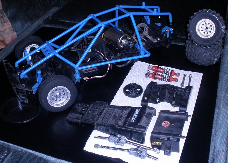

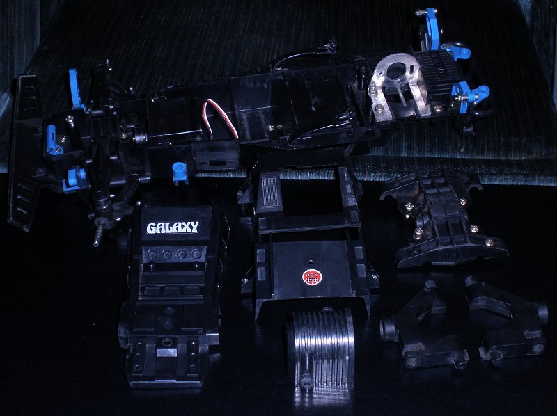

This project will be decidedly less interesting to most of you than something more high-end, but I thought it would still be interesting to see exactly what I could do to hop up the humble Marui Galaxy. This car belongs to my brother and somehow ended up with me, unused in its box for two and a half decades. He probably doesn't even remember what happened to it. Back in the day, it was a reliable runner. The gearbox is rather simplistic but works well. The suspension, however, was horrible. BITD, I had spare red Kyosho shocks back when I upgraded my Optima to gold shocks, and they were a near-perfect swap for the Galaxy's front stock shocks.
I've partly disassembled the car now and found the gears and U-joints to be in good shape. Other than the usual scuffs & scrapes, the plastic parts are in good condition, too. The wing was a write-off, having been ripped off once, re-mounted with different holes and looking kind of goofy. I have a new wing for it that will look much better than the stock wing. All the 4 plastic bushings for the front wheels, and 4 oilless metal bushings for the rear U-joints/axles will be replaced with bearings. I needed a pair of 55mm shocks for my Project CYANide project, and that turned out to be nearly the exact same length the Galaxy's rear suspension has, so it wasn't a waste buying a 4-pack of 3racing shocks. Lastly, I want to convert the rear wheels to 12mm hexes. The Galaxy already has axles cross-drilled with drive pins; I just need some pretty wide hex hubs and adding some low-profile wheels with modern tires should be a snap.
I plan to rebuild a spare Kyosho Le Mans 360ST, which should be a nice improvement over the stock 540 tin can. I'll need an inexpensive ESC with reverse, something like an Associated SC-200 would be ideal. I've already yarded out the 4-battery receiver pack, MSC with (broken) resistors and throttle servo.
Upgrading this car should be a bit of fun...hopefully it'll be ready for his birthday on Feb. 2. :)

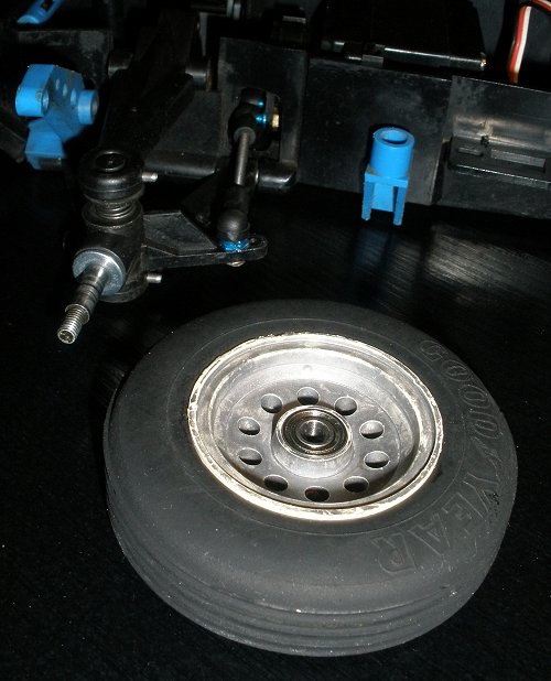

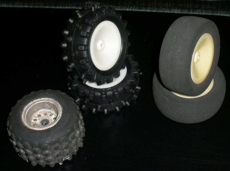

I got most of the plastic parts cleaned up tonight. I also weighed the entire Galaxy car. With the MSC, motor, all parts to be reassembled (except batteries), it weighs in at 1176 grams. My Turbo Optima, with ESC + motor + receiver tips the scales at 1441 grams. I can't say if 1176 grams is light or heavy for a 2WD car--anyone else have some numbers for comparison? :)
I also have some wheels & tires lined up for eventual use. I'll include a set of knobbies and spongies for off-road and on-road driving. The bigger rims & mounted low-profile You-G tires actually weighed 54 grams compared to the stock wheels & tires, which each weighed 80 grams...I thought that was a pretty impressive weight reduction, cutting 52 grams from the total weight just by switching to modern wheels & low-profile tires.
Now, I have to sit around a week or two for some 11 x 5 x 4 bearings to arrive...

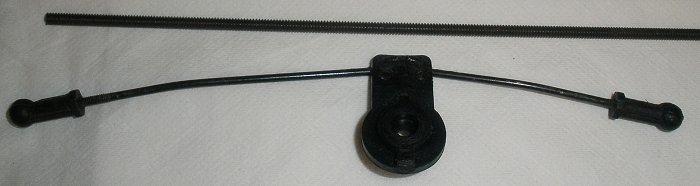

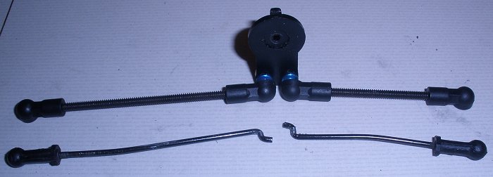

Here's a simple mod I did to beef up the Galaxy's steering linkage. The stock linkage uses piddly 1.5mm threaded rods which--as you can see--obviously don't hold up to much abuse. A few curb hits and they bend very easily. I had some 3mm threaded steel rod lying around and some leftover 4.8mm ball ends/cups, so I enlarged the holes in the servo saver and bolted on the ball ends & cups. The steering knuckles will also get 4.8mm ball ends installed and this Galaxy won't wilt as easily after minor bumps & bruises. 8)

Cool, you should lose a lot of slop with that mod too.
The bent end in the servo saver was always hopeless.

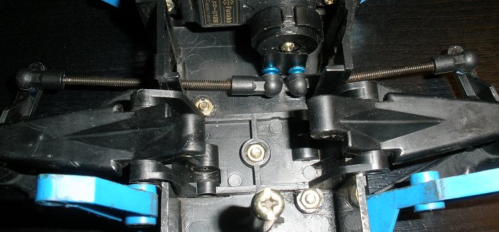

I finished the steering linkage tonight. Reamed out the knuckles for some larger 3mm-threaded 4.8mm balls. I had to file off some plastic from the right side of the plastic bath-tub as the larger ball-cups would catch on the edge when steering left/right. You can see the rounded area I opened up just where the driver's side tie-rod & ball-cup emerge from the chassis.
It seems to work great, with absolutely no slop.
