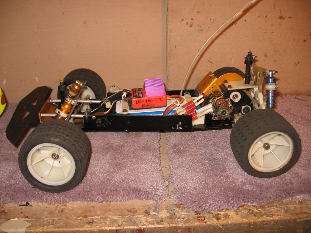

Rustbucket wrote:YUP that is what I did.
not according to your pics you didn't.
when you make a 3 gear trans (or in this case a 6 gear) a mid motor setup you can't just unbolt the trans from the chassis and flip it around. the motors are designed to spin counter clockwise. so the spur/pinion must remain on the right side of the car.

scr8p wrote:you have to flip the topshaft and motor plate to the other side of the trans case.
thats one reason the litesink was so good ,when you flipped it you could mount the heatsink block on the other side too

OK thank you for your advice. I did something elest and it seem to work. as well I was fighting a bad christal that I did not thinki I had.. Been fighting this problems all day long drove me nuts. What I did I took the motor apart flip it 180 then put it back together. Then resodered the postive and neg leads back on the right place. THEN put it all back together. So your telling me I have to take the top shaft put it on the other side of the tranny so everything is on that that side .? So my top shaft and everything elest will be on my driver sides instead of the Passener side like it is right now?
IF that is the case it will help me alot more. This is the fist time I have done this kind of swap. I rebuilt my 6 gear and it runs smoot. NO noise at all. Have to replace the dog bones for I now see they are a little bent. NOT a problem I have a good set.. OK get back to me and you can use my reg E mail if you like this way I can share some more pictures. [email protected] . IN subject area just put RC 10 then I will know it is your address coming back to me. Maybe this way both of us can help each other. Thank you for your time and advice. DON THE Portland Rustbucket

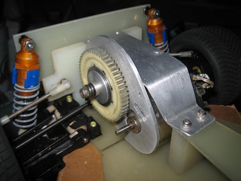

I just remembered I have a motor plate that I made for a mid motor setup(not a hacked stock motor plate). if you are interested, please let me know.....I'll try and snap a pic of it tonight for you. it's a mid motor chassis, just not a gold pan(custom made), so you can see what it looks like.

yes, I will snap some pics tonight to help clarify.....in the meantime, I pulled a couple images from an old thread, compliments of jsrracing, you can see how the motor is mounted, and how the motor plate was trimmed.
let me know about those shocks, and once I get pics from home, if you are interested in the motor plate.

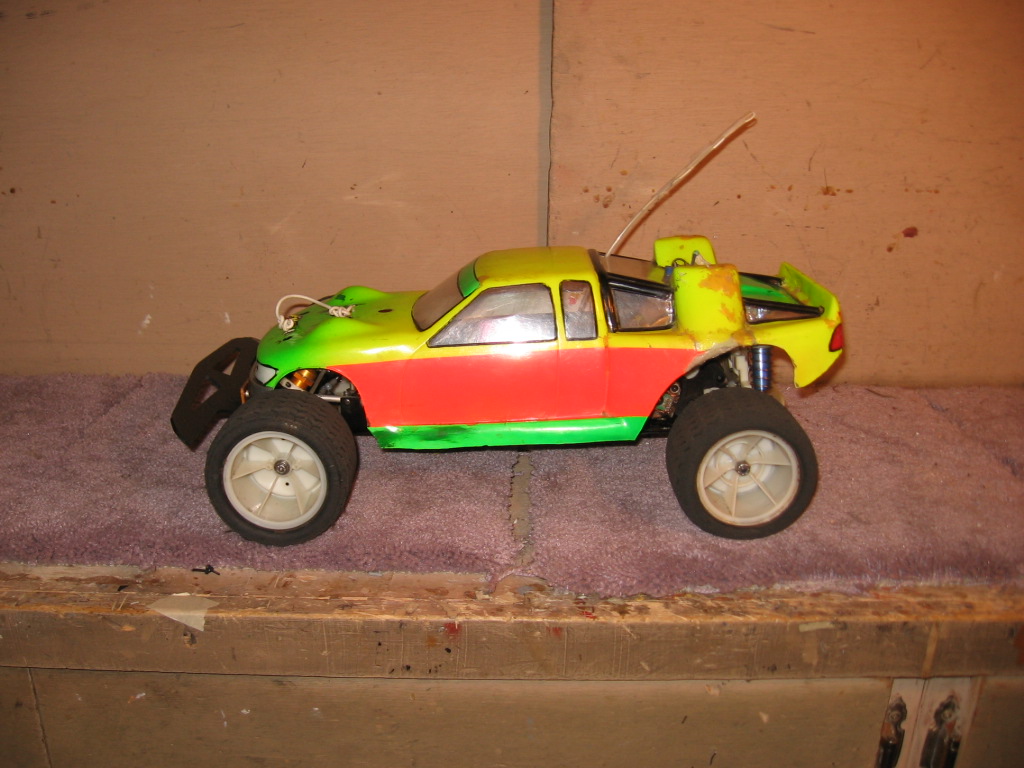

here are a couple pics of my mid motor car:

So how did you make that plate for I am trying to figure it out now.. I am open for ideas and any other help you can give me. That Custom RC 10 you have looks good. Reminds me of what some of them look like back in the my early years back in the early 90s that is how long my wife and I have been into RC racing.

Now those rigs I do remember from many years ago. I did not see many but in the 90s those sprint cars was around. I think there was a convertion for the RC 10 . In those days we were runing the RC 10 truck convertion. Until the Ts came then the rest was history.
YOUR VEry lucky to be able to pick one up.
