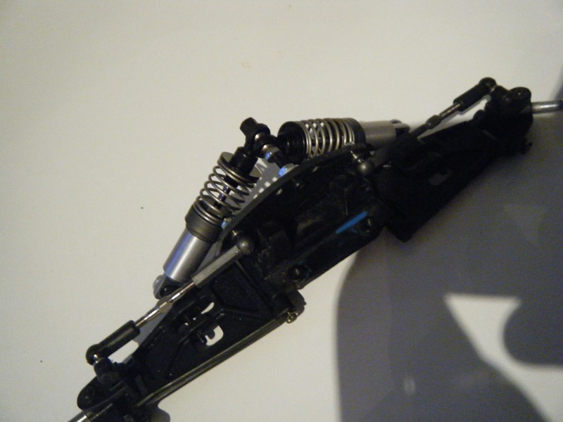

My goal was to use up parts I had, I plan on runnning a 3S LIPO and massive gearing for top speed fun. Hardest part was the cutting a rear bulkhead bottom off and mating it to a front hinge pin support such that I end up with zero rear toe in and correct anti squat at level for now. I just need some sort of onroad body to set over it.

Need help figuring out body. Wheelbase is 272mm, width at outside edge of tires is 245mm.
I am not to picky, but something that would fit over it nice and low.
Thanks.

RCveteran wrote:Need help figuring out body. Wheelbase is 272mm, width at outside edge of tires is 245mm.
That could be a challenge. I found most current on-road bodies are somewhere between 190 and 210mm wide. I had to do considerable modding of my front end to narrow the track to just under 200mm on my Optima--shorter control arms, shorter CVDs, tie rod & camber turnbuckles, and either shorter shocks or fabricating different shock towers (I had to do both). I believe my wheelbase was 260mm, which was a near-perfect match for several of HPI's vintage-themed bodies.
My rear tires still stick out about 10mm each side on a 200mm wide 1/10-scale body, and that even after downsizing my rear CVDs by 4 or 5mm. That's about as good as it gets. Bear in mind this is all relative to an accurately scaled 1/10 body. Parma & Bolink made bodies BITD that were better suited to fit 1/10 buggies, but accurate scale & design wasn't the first priority.

will you drop in the hyperdrive belt drive? If not you're going to have to reverse the moter, or flip the moterplate to the other side.
The last is really easy on the JRX-2 so both would be pretty good choices. Still the hyperdive would be the best: the belt acts like a 4th gear.

It will be brushless so reversing the motor is just a wire swap.
