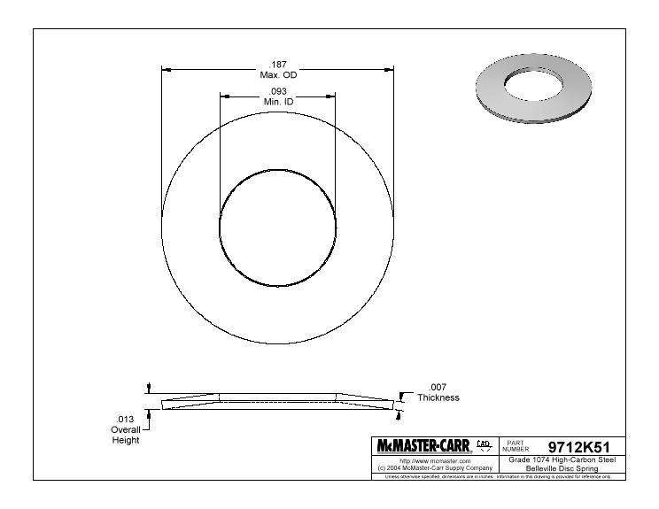

Question - this is the first time in ages I do an old-school yoke diff with that crappy split washer and crappy bent screw... is there some kind of aftermarket parts that fit? I'm thinking a proper diff spring for instance. The range of adjustment is ridiculously tight on the current setup due to the quasi-absence of "spring" action... thanks!

you can use belleville washers, and a standard screw with locktite, OR...if the diff hub is threaded all the way through, add another 2mm screw in the threaded side to jam lock the adjusting screw.....does that make sense? you adjust the diff with the diff screw, then tighten the 'jam screw' on the other side.
a belleville washer from somewhere like mcmaster-carr would be the ticket...like this one....you can stack them to get the desired 'feel'

jwscab wrote:you can use belleville washers, and a standard screw with locktite, OR...if the diff hub is threaded all the way through, add another 2mm screw in the threaded side to jam lock the adjusting screw.....does that make sense? you adjust the diff with the diff screw, then tighten the 'jam screw' on the other side.
Thanks - yes, I was thinking belleville washers too, they are very hard to find in the small diameters though, usually they're sold in bulk for industrial purposes, whereas I'd just need a few. Shame that McMC doesn't ship overseas, there's so much stuff I'd buy from them :lol: I've already started looking for small-qty belleville washers...
In the meantime, does anyone know of a 6mm outer-diameter diff spring? That's how small the diff outdrives are the yrf2... :shock:

maybe this one? 7mm long though, probably too much for the assembly.
http://www3.towerhobbies.com/cgi-bin/wti0001p?&I=LXM491&P=7
how soon are you gonna be building this? I might be picking up some belleville washers for some yoke builds, but probably not till next week, I have an order I'm building with mcmaster....if you can wait, I can send you some.

I think this one would be a tad long indeed and probably hit the dogbone... however that's the "stock" hpi/HB diff thrust spring from the old diff, and I might be able to get one locally indeed as it's a car that was hugely popular in our area! I feel stupid for not thinking about it myself, as I was running the HB cyclone up until last year :oops:
I'd love to repurchase a few belleville washers from you, really... that'd be very nice of you. No hurry at all, I can always fit them on later, really :) Let me try to get back to you with dimensions after this weekend :) Thanks a lot in advance!

yeah, that's no problem.....mcmcaster sells 'em in packs of 12, and I can send you 2 in an envelope for nothing....I'll let you know when I get 'em and you can pm me your address....I'm thinking 2 back to back will give you what you need. like this 'top thrust washer' '<' '>' 'thrust bolt
actually...you have a trx-1/3 right? check the diff thrust springs from that, they might fit! they are bellevilles.....

jwscab wrote:yeah, that's no problem.....mcmcaster sells 'em in packs of 12, and I can send you 2 in an envelope for nothing....I'll let you know when I get 'em and you can pm me your address....I'm thinking 2 back to back will give you what you need. like this 'top thrust washer' '<' '>' 'thrust bolt
I think the TRX are too big, but I'll check again. 6mm is tiny. The losi ones I have don't fit, and my xray T3's are small and already 8mm...
thanks for the offer :) the trick in picking belleville washers is to figure out which "tension" one you need... coming both from different materials, thickness, and deflection angles. Wilco.

yep, mcmaster offers 2 tensions, 7lb and 15lb. with the stupid lockwasher the only tension set on those diffs from the factory, I'm betting that using 2 7lb springs will do the trick. if not, they can be stacked.
once I get them, I'm going to rebuild a diff and see how it feels with just 2 7lbs. if that isn't enough, I'll double them up and try them. if that works, I'll pick up the 15lb ones and use those in the future.

Joe was kind enough to send some belleville washers, thanks Joe! Haven't had time to install them yet. I'm sure they'll be great!
