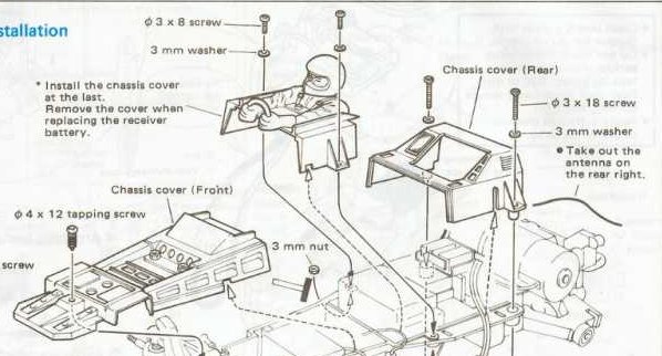

Here's a pic from the manual showing where the driver doll mounts relative to the rear cover & MSC hole. Thanks though, you gave me the idea to block off that hole with a piece of Lexan. Fortunately, everything in the motor & gearbox area there is sealed off, but without the MSC installed in there, it just looks kind of weird & empty. :) The only thing I have in that section are the motor & battery connector leads.
My bro's birthday is Feb. 2, the only thing I'm waiting on is a charger & battery that will soon be delivered. In the meantime, I'll test the electronics with my own batteries and hopefully find a place to test-drive it. Even if my bro doesn't end up driving it, it'll look great if he wants to display it. :)

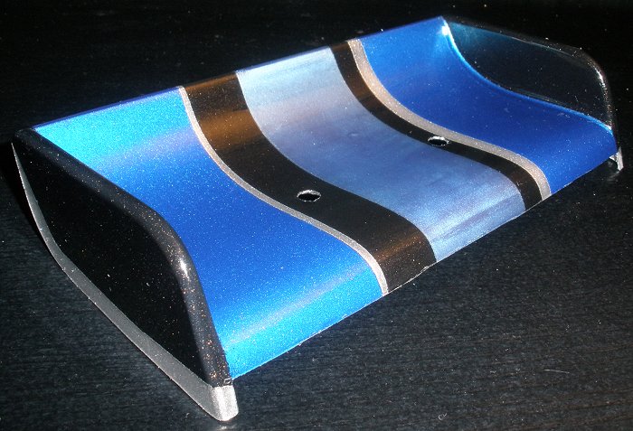

I got the painting finished on the wing tonight. Got a chance to test my new mini paint booth, it worked beautifully! I apologize for the lack of creativity, just some striping. I'm not really big on wild graphics, I guess. :? The color combo I went with was metallic black, metallic blue, sky blue pearl in the middle, and silver accents/final coat.

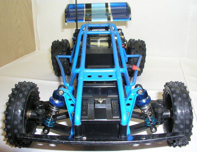

A few more photos of the finished Galaxy. The Kyosho Le Mans 360ST I'd planned to use turned out to be dead, so I installed a 480 Gold I rebuilt a while ago.

Actually, with the bigger tires, all else being equal, the acceleration will be slower. If anything, that should put less stress on the gearing, not more. As long as the motor doesn't get too hot, that is. Doing some basic tests in my house on carpet, it didn't have enough punch off the line to do wheelies, which is a good thing. If it did wheelies, I'd be concerned about the gears. ;) Unfortunately there's snow on the ground everywhere so I don't have a place to do some proper testing, but my early indications are that this should work fine. The bigger diameter tires should offset the extra punch of the 480 Gold nicely. (Remember, you like everything stock, and you kept your tires and everything else stock when you tried a 480G.) ;)
