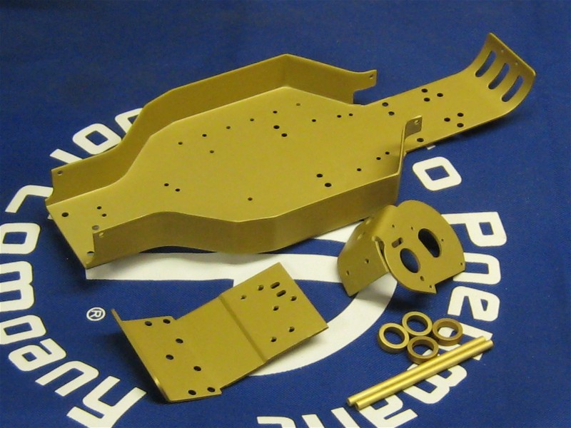

freshly re-ano'd parts. :)

They look nice Scr8p, what prep did you do on them, just bead blasting?

i glass beaded just the bottom of the tub and nose plate to remove the ano quickly. then hit them with 80 grit on a da sander to feather out the scratches. stepped that down to 150, then 320, then 400. after that, i used a somewhat worn out red scotch brite pad to give it a uniform finish. jeff said i didn't have to worry about stripping everything, the place that did the ano would take care of it. so i only stripped the areas that needed to be fixed.

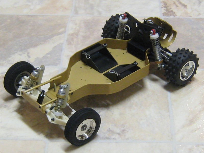

still have quite a bit to do, but i threw some of it together. i need to peroxide a spur, get new ball cups for the sway bar, piece together an edinger steering bellcrank, make a rear swaybar, get new hardware for the front wheels, and ultimately get a body and wing painted.

Re: Edinger Kit Manual / Replica of Backpage RC10
Too cool 8) 8)

i'm really not a fan of black parts on a gold tub, but with how light the gold is on these parts, it doesn't bug me near as much as it does on the darker orange/gold stuff.
