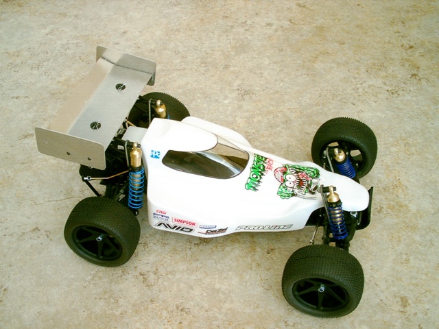

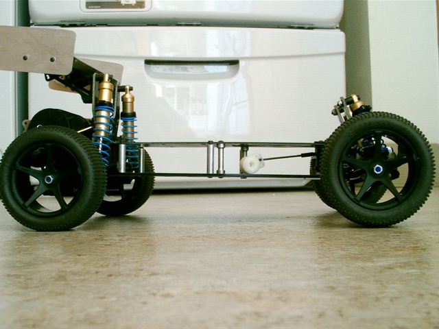

Follow what mikedealer posted and you should be fine, for the new 2.2 wheels the new axles spin on two bearings, not the wheel spinning on the bearings, It's kind of weard. He has all the part numbers for Koysho America in his writing. Here is the how to for the wheels
http://www.tamiyaclub.com/showroom_model.asp?cid=81842&id=22245
and here is the site for Koysho America
http://www.kyoshoamerica.com
and here is a couple of pictures of my Ultima Pro with the 2.2 wheels un-cut on the front end.

Those wheels are HPI super star for the super nitro RS4 and Kyosho Super Ten cars. HPI PN's 3031,3032,3033 (not sure which PN is which, but they come in grey black and white). Chrome also - don't know that PN though.

The chrome one is actually HPI 3032 - 57mm x 35mm with 12mm hex standoffs.losiXXXman wrote:Those wheels are HPI super star for the super nitro RS4 and Kyosho Super Ten cars. HPI PN's 3031,3032,3033 (not sure which PN is which, but they come in grey black and white). Chrome also - don't know that PN though.

No problem - here are the wheels
http://www3.towerhobbies.com/cgi-bin/wti0001p?&I=LXCEA1&P=RH
and the tires
http://www3.towerhobbies.com/cgi-bin/wti0001p?&I=LXYUV2&P=7
Hope it helps and Goodluck
and the tires
