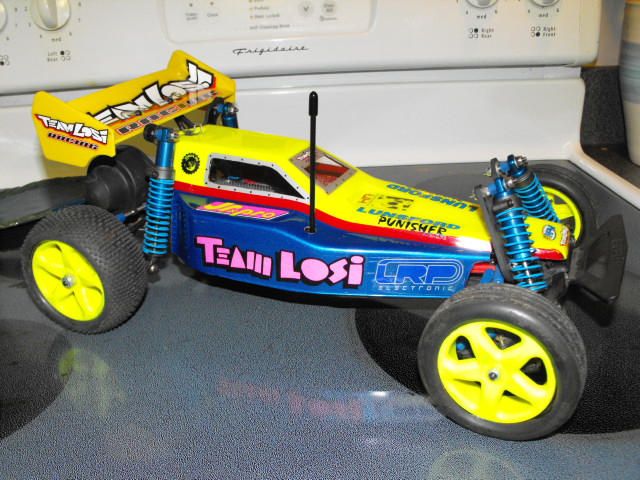

I use RPM H arms stock trans and stock xx mip cvd's. I built my car to run as much stock Losi parts as I could.

I do have a set of the RPM truck front arms, XX steering, and the Trinity wide axles so I can use XX/XXX wheels up front now if I want. I got the idea from you actually! I'm not happy running those wheels on the rear though as even with spacers the width is still too narrow. The fronts work just fine but I'd still like to have another option as I have more than one JRX but only one set of rpm arms. Besides if the VLA hubs work front and rear then it could be a simple upgrade for those wanting to easily run 2.2 wheels. I at least want to test it.

thats cool, let me know how it turns out. I built this car about 5 years ago. with out a local hobby shop to get parts from. I am sure theirs a better way. I just built it from the parts box.
